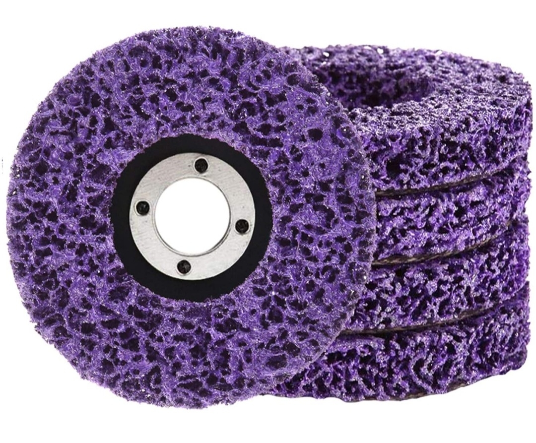

    Flap wheel is a bit harsh and can put a lot of unwanted heat into a panel.
    Best thing I've used so far for that and panel rust removal has been fiber abrasive discs:
    Phil

    Joined: Sep 14, 2006

    KenC

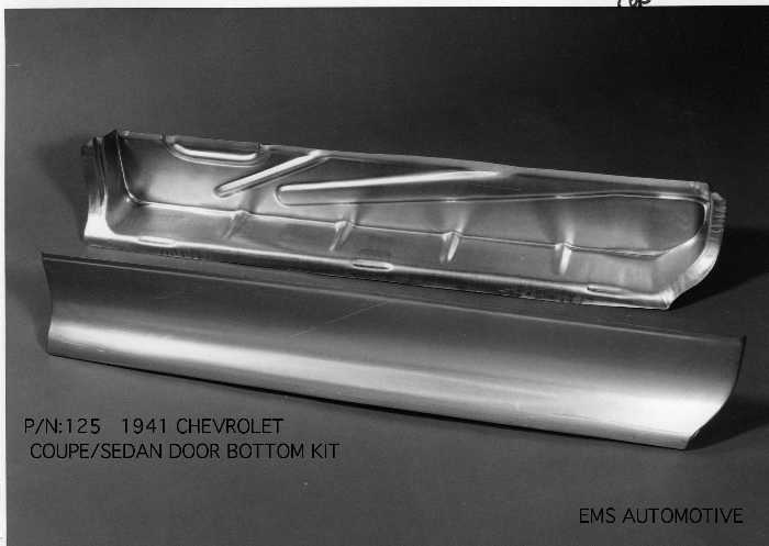

    not sure were you got panels from , you may want to try these

    Those are my choice as well. They remove a lot of material quickly, don't put an excessive amount of heat in the panel, and leave a decent tooth in the metal for new filler to bite into. I've gone over even blasted cars with these just to prep the metal

    These are the exact ones that I bought! So far, I really like them.
