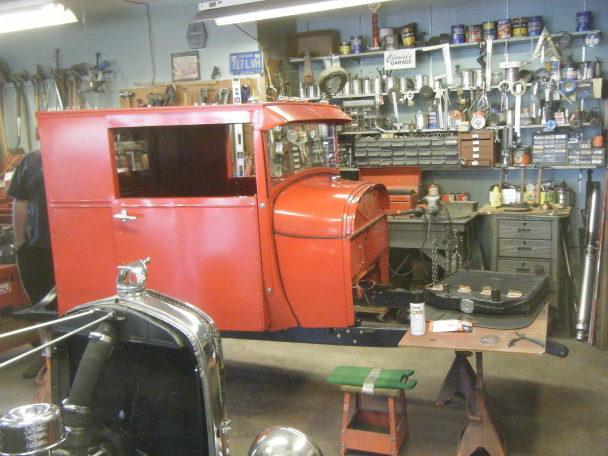

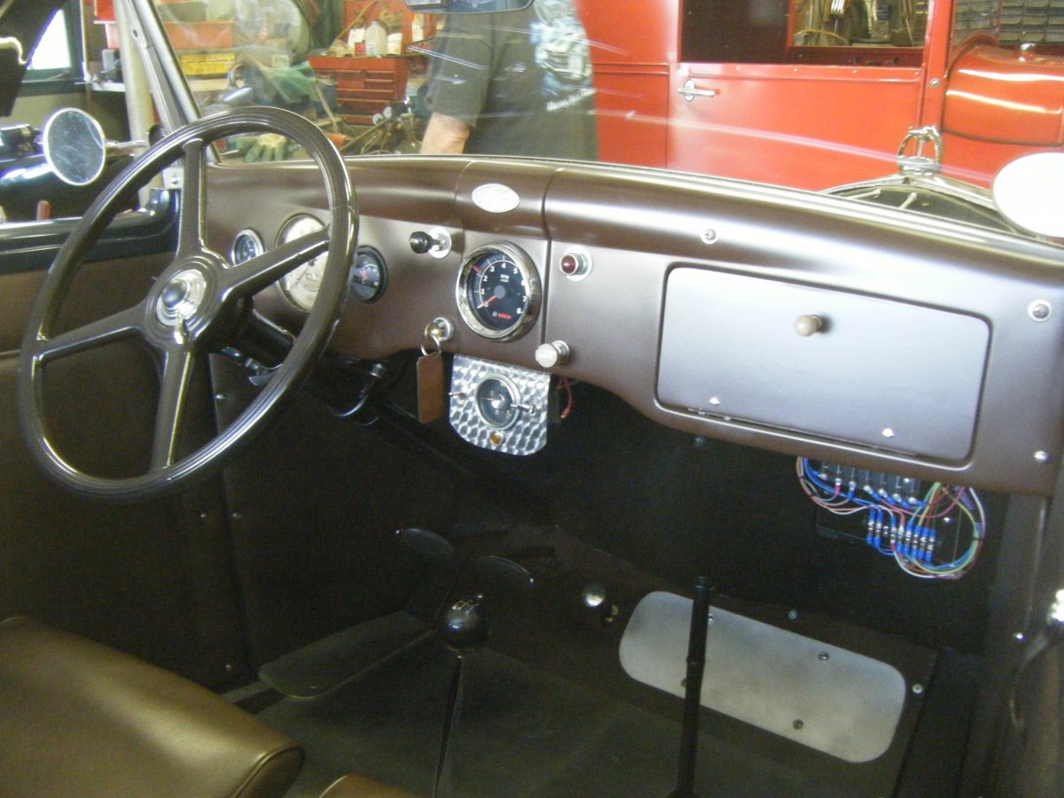

    heres a couple a buddy of mine is finishing up. he started with just model A cowls and built the rest from scratch and left over parts. DSCF0001.JPG DSCF0003.JPG DSCF0004.JPG DSCF0007.JPG

    the red one is the third one he is building from just a cowl, it will get a short body and a tow truck boom. he built two of the roadster pickups and the pictures just don't do it justice. his craftsmanship is top notch. most of the pieces he used were cast aways from other guys projects.
    for the back of the bodies, he would give me dimensions and i would bend up the panels and he would fit them.

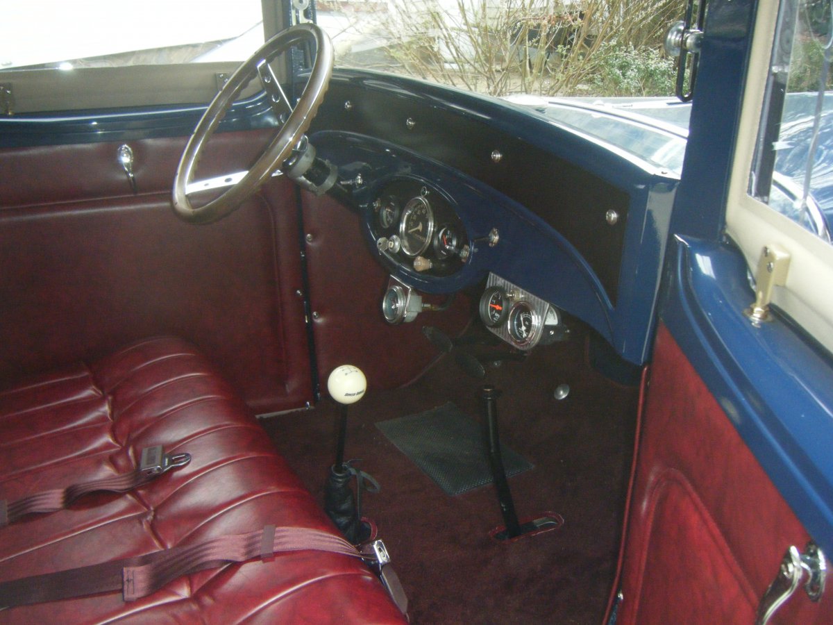

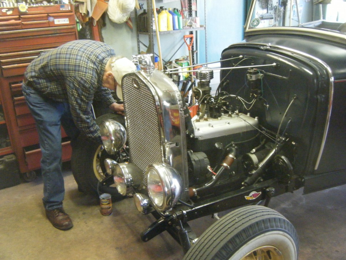

    This started with a $50 29 A cowl, homemade body on Es*** rails.

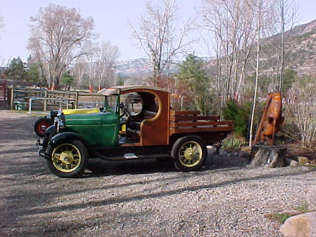

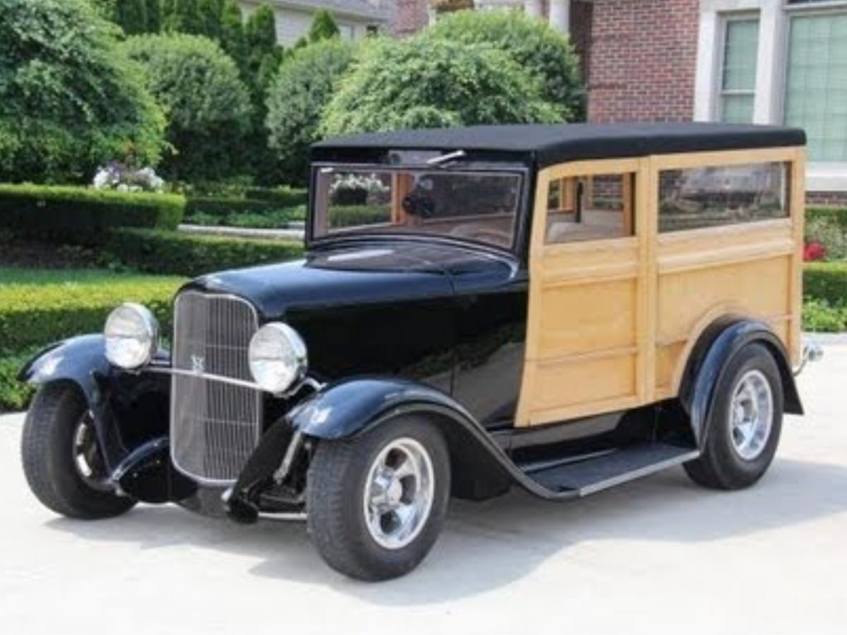

    image.png If you like woodies, and you like woodworking.....build a woodie. Lots of plans for woodie type vehicles are available. If not, just buy a complete A body and sell the cowl to someone who is building a woodie.

    Or better yet, build a "woodie" but instead of using wood, use something like 1"x3" rectangular mild steel tubing. You could panel bond the sheet metal to the inside of the tube framework. Then wood grain all of the metal to finish it.
