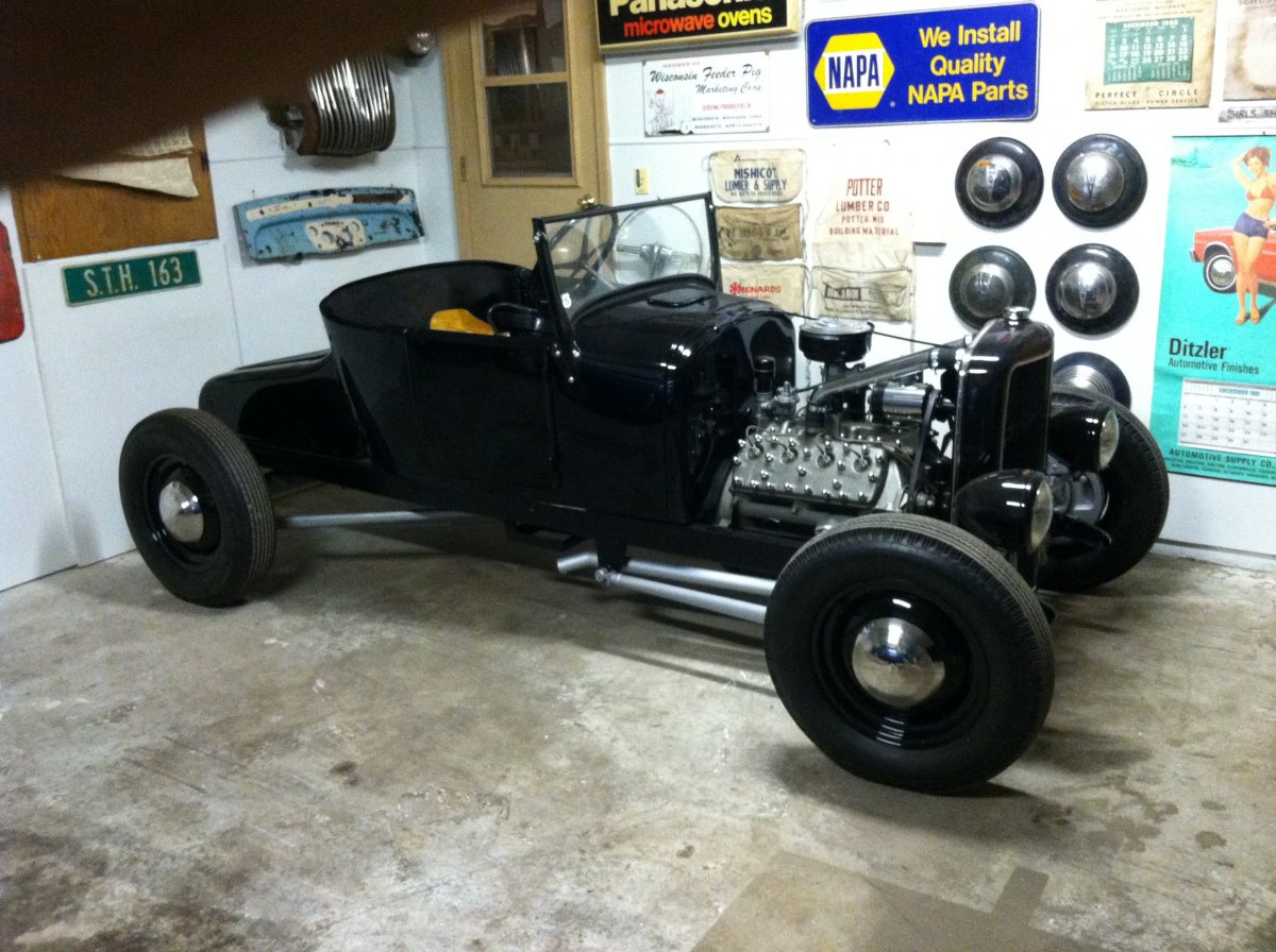

    This is my 26 T (with earlier turtle deck), on an A frame with a flathead. These bodies fit an A frame really nice. If you had an A body, how would you build it? Do the same for the T. The T body on a stocker A ch***is gets you on the road period-style really cheap, and a V8 of several flavors fits into the A frame real nicely too.

    @Squablow i really like your T. But I am thinking somewhat lower. And I won't bother with a flathead Ford. Dodge maybe but not a V8 Ford.

    Thanks. My car sits pretty high on purpose, but you could get one a lot lower with a swept front and a step in the rear, which would still avoid channeling. Channeled T's have a great look but you sacrifice a lot of interior space which there isn't much of in a T to begin with, that's why I like the body on top.
    An early Dodge V8 would be a great choice and would fit nicely too.
