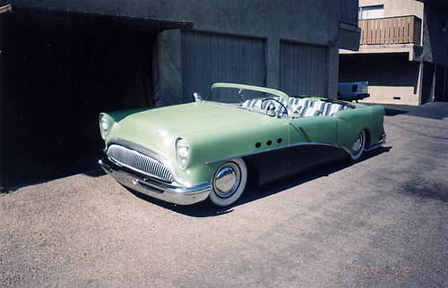

    The older I get the more I appreciate the design genius of Harley Earl. He was in his prime as Vice President of Design at GM in the 50s. His Buick designs were loaded with character and yours is one of them. When you said you were thinking about a flat black I cringed. In the 50s GM cars were all about the bling. Just look at all that shiny detail (chrome and stainless) on your car. It cries for shiny paint. JMO
    Enjoy your ride. It's a real looker.
