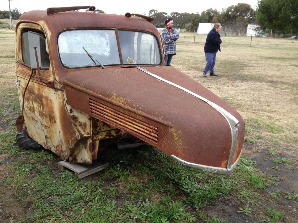

    ImageUploadedByH.A.M.B.1387871739.135859.jpg . Thinking hi boy style artillary rims , channelled with flathead , original suspension etc !

    ImageUploadedByH.A.M.B.1387883233.463659.jpg the body has these front panels originally it was a 1 1/2 ton truck of 1940 vintage , the body though is the triple body line the same as the US 1938 model ford. I'm not sure how these came to be . A mixed bag of surplus body's from the US maybe ?

    Greetings! Three ribs on the doors means it's a '38. Am still wondering how you are going to build a "channeled highboy".

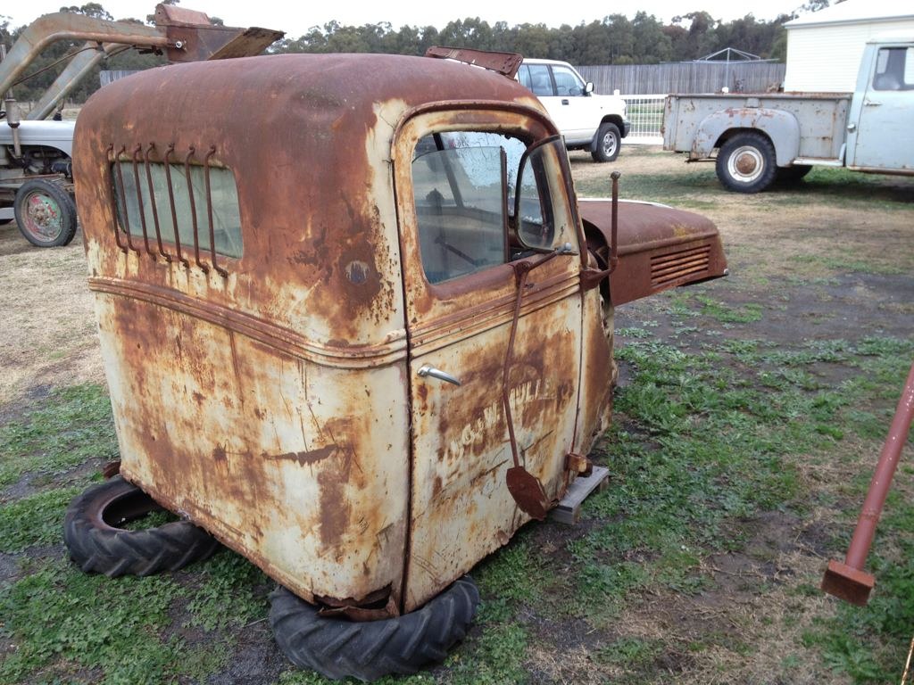

    First thing you should do is make sure you can get it titled and registered before you spend money and time on it. What is the "arm" mounted on the door, it appears to be a signal device of some sort?

    Well at least you can throw fire wood in the bed (when you get one) and not worry about a stick going through the back glass:D

    Yes a signalling device, if you hauled in on the lever you got a turn signal and if you pulled on the knob the metal hand turned up-right for stop position.
    it was a bit tricky with a stick shift, double clutching and worn steering box
    fully loaded coming up to an intersection
    Made even worse if the window was up

    I'm digging the jail bars on the back window!
  13. Damn I was thinking wide load mirrors in the swing stowed position.

    The '38 style body lines DO NOT mean it's a '38. It means the panels were stamped from dies originally used on US production '38 models. The US makers often used previous year (by then obsolete) dies for vehicles produced in other Countries. It was driven by economics, and nothing more.
    Look at '50s and '60s Aussie Chrysler products for a good example of this.

    How did the doors get those vent windows ?

    302gmc it's an Aussie vehicle !
