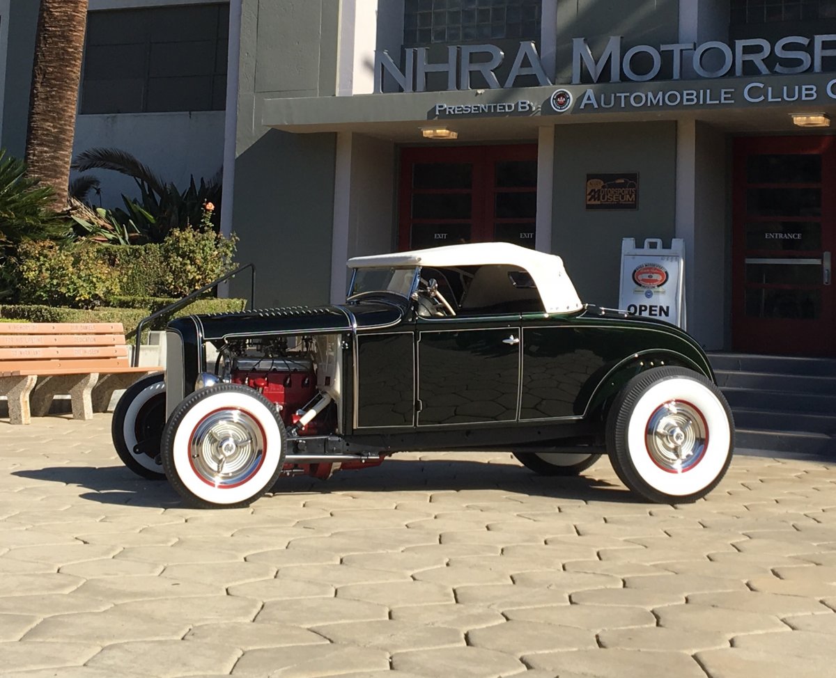

    At 6’3”, a channeled roadster probably won’t be the best choice. The black roadster pictured would be a great basis for the look to go for.
