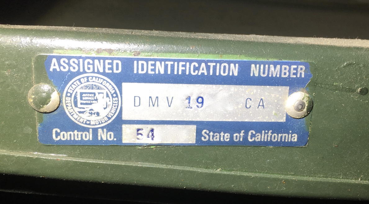

  6. Charlie....if you can - what year of issue do you think that one is ? Looks like a low #.......

  11. Sorry for the confusion, I blurred out 3 digits between the 19 and the CA. The tag was from about 1971.
    Charlie Stephens

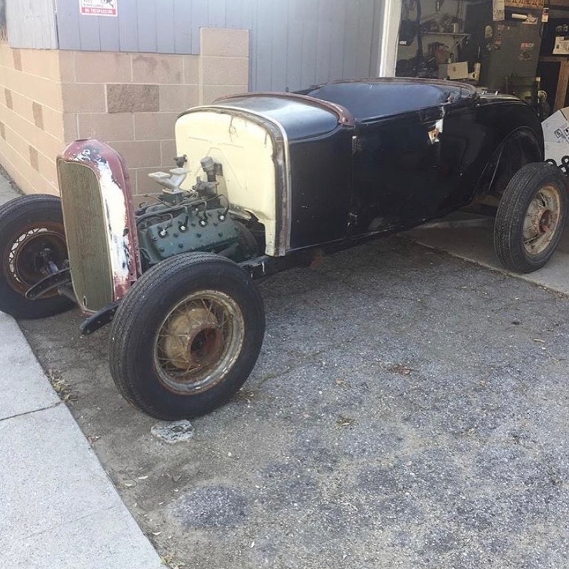

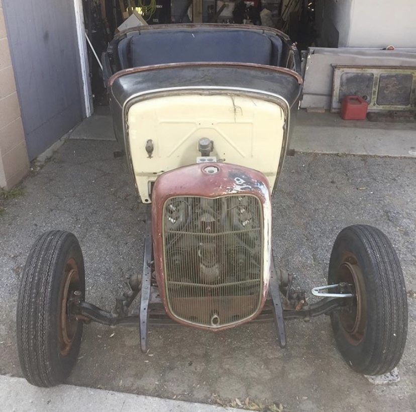

    When we finally pulled into the right lot, we spotted the roadster and our jaws collectively dropped. Seeing pictures and videos is one thing, but being in the presence of such a neat old car is hard to explain. You guys know the feeling. After introducing ourselves, I asked if I could start tapping and magnet-ing. The owner said go right ahead. So we did.
    It wasn't long before I discovered that this car was rougher than expected. My tapping made me realize that there was a fair amount of bondo, and the passenger side quarter panel was the worst of it. The car was leaking fuel, leaking oil and Yama and I realized that the two bolts attaching the wishbone were barely finger-tight. Not a good sign.
    We took it for a test drive and although it brought us down the road just fine, there was some unsettling clattering coming from the engine compartment. The owner told me that he thought it may have been normal. Yama and I were skeptical. When I drove it, the starter motor wouldn't disengage, which wasn't a good sign either.
    When it was all said and done, I respectfully declined and thanked the owner for letting me check it out. For the price he was asking, it would have to have been a pretty nice car. This could be a good project for the right person, but not for me at this time.
    We ended up spending the rest of the afternoon relaxing at the park, enjoying burgers and root beer floats from A&W, and then hitting a neat thrift store and grocery store on the way home. Like I said, a damn good day. No complaints here.
    Thank you for everyone who helped! I'm excited that even though this one didn't work out, the search is on. I have some good leads that I'm investigating. And now for some pics...
