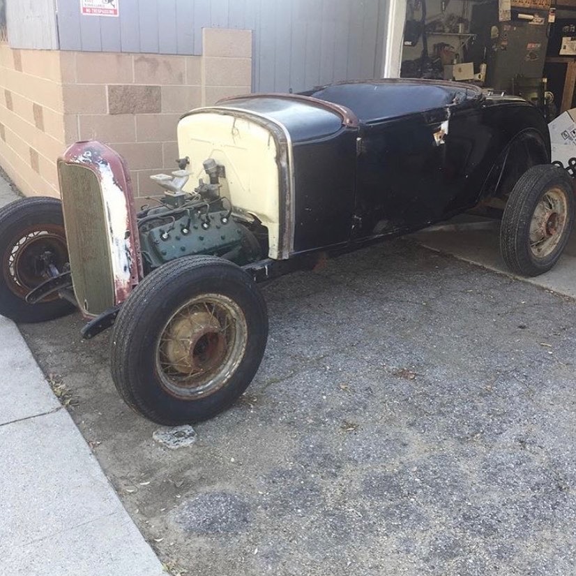

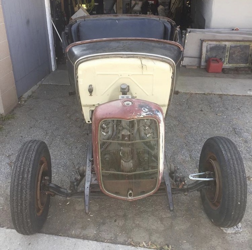

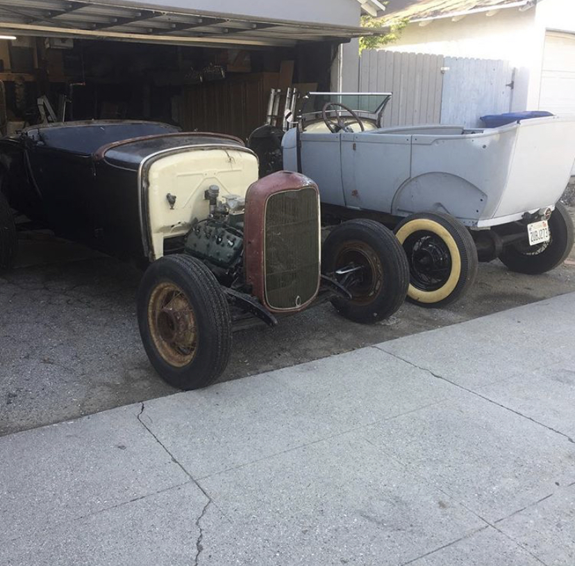

    Hey everyone, so we have an update. After giving it a lot of thought, I'm taking a different approach. Yesterday I managed to get a great deal on an original chassis that just had the body and fenders removed. I have a lead on a '31 roadster body. So, if all goes to plan, I'm going to piece the two together and do some hot rodding. I'm so excited! Here are some photos. IMG_9477.jpg

    Looks good. Just one question - title? If not get that figured out before you get too far into this project. JMO.

    No title. I'm pretty sure the parts are worth more than I paid for the chassis, but the title is one of the first hurdles.

    Yes, it's been sitting for quite some time, but we poured some ATF through the spark plug holes and it turned over smoothly.

    Looks like a good solid start. Wish the Title BS didn't kill the excitement. Bob

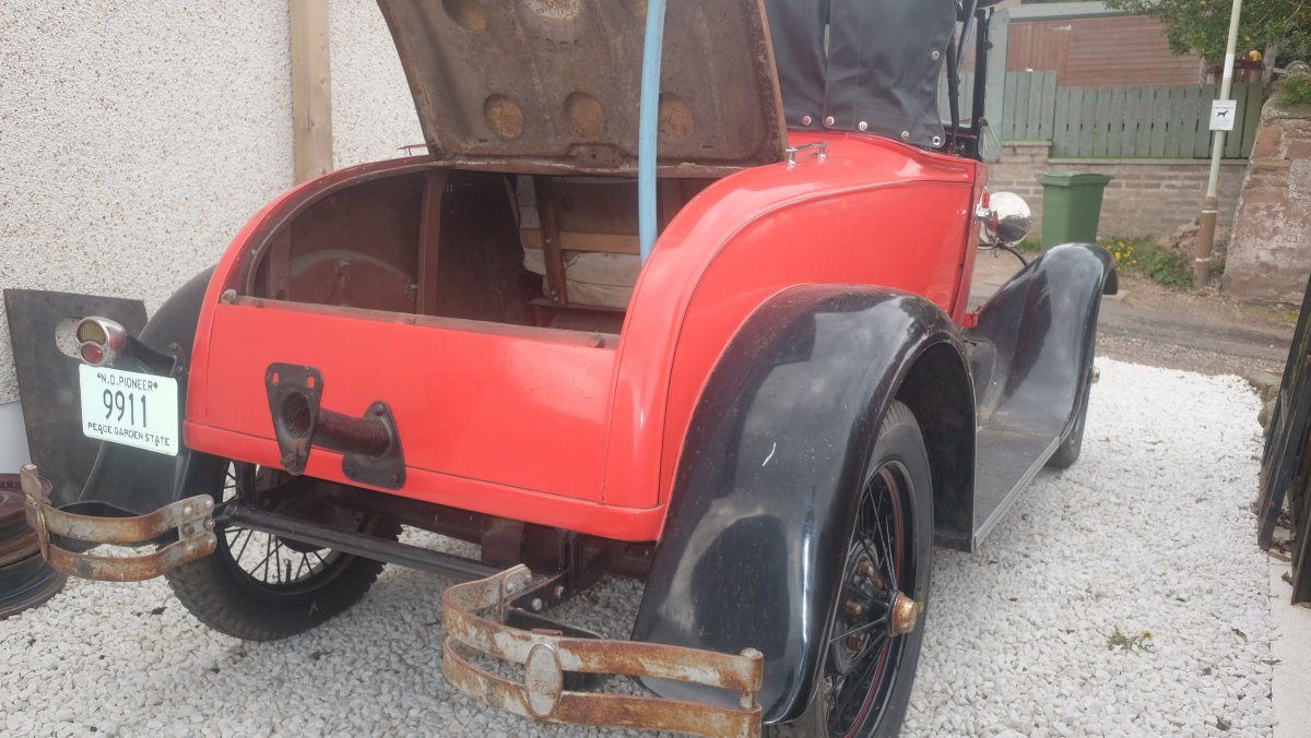

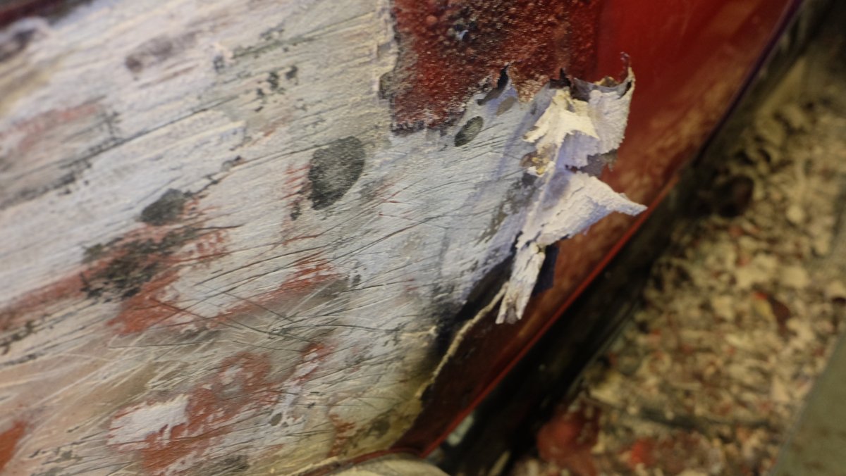

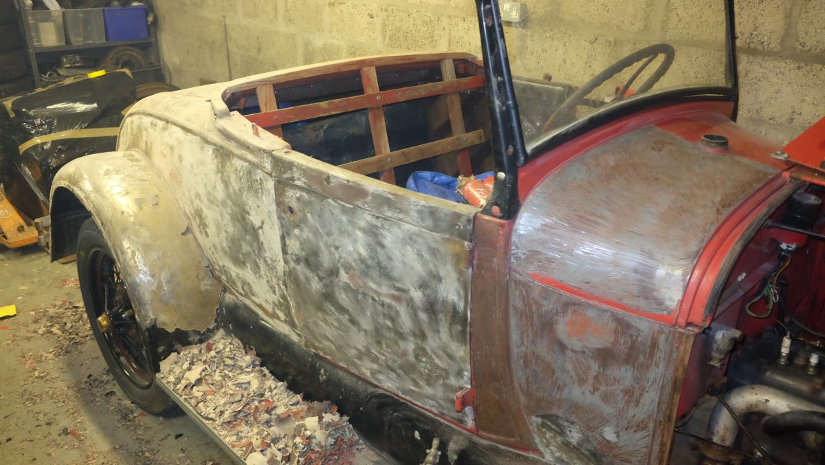

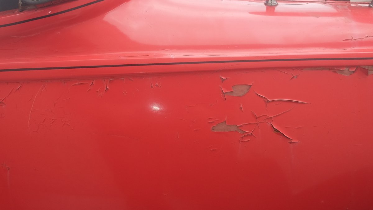

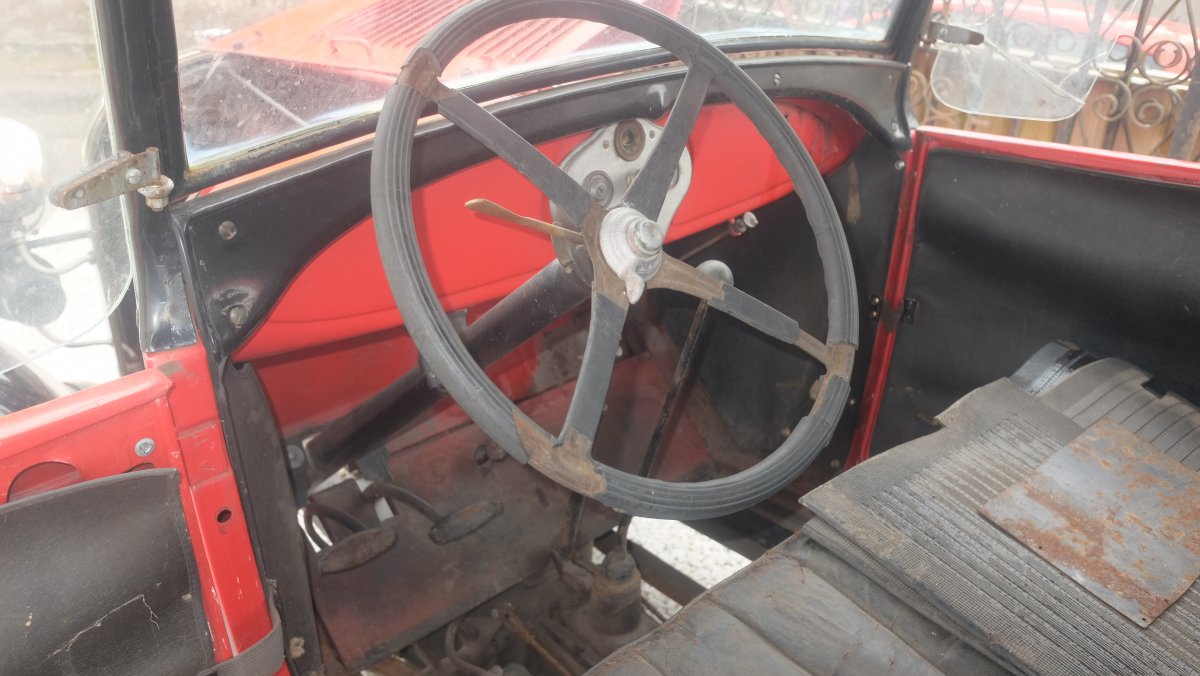

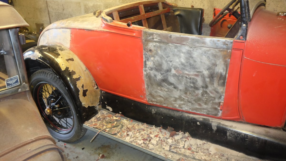

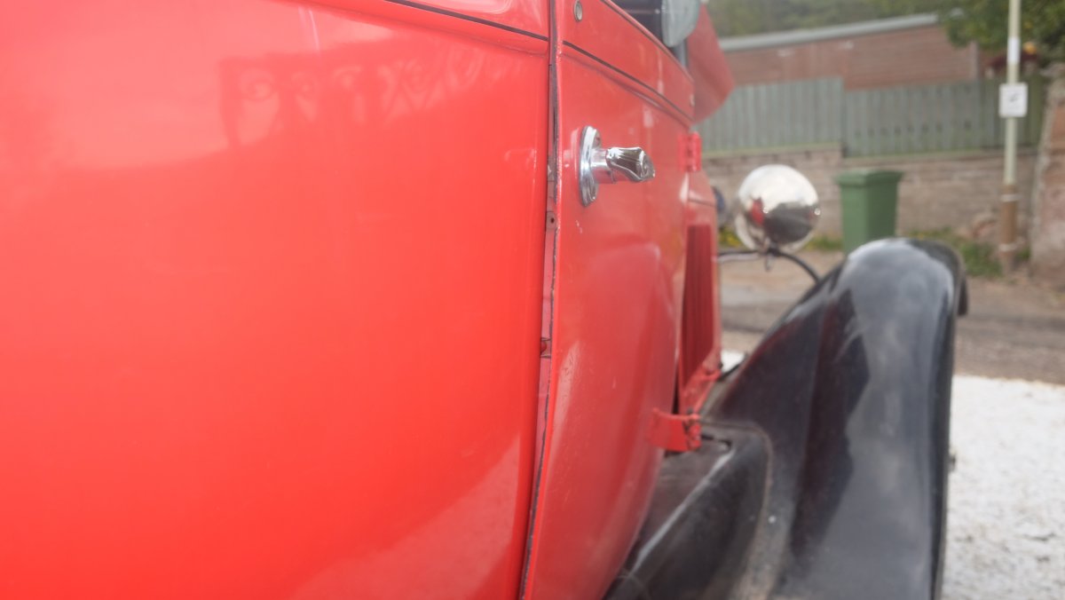

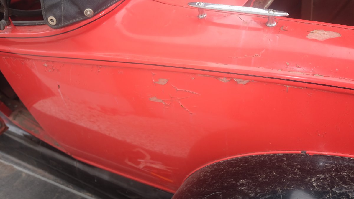

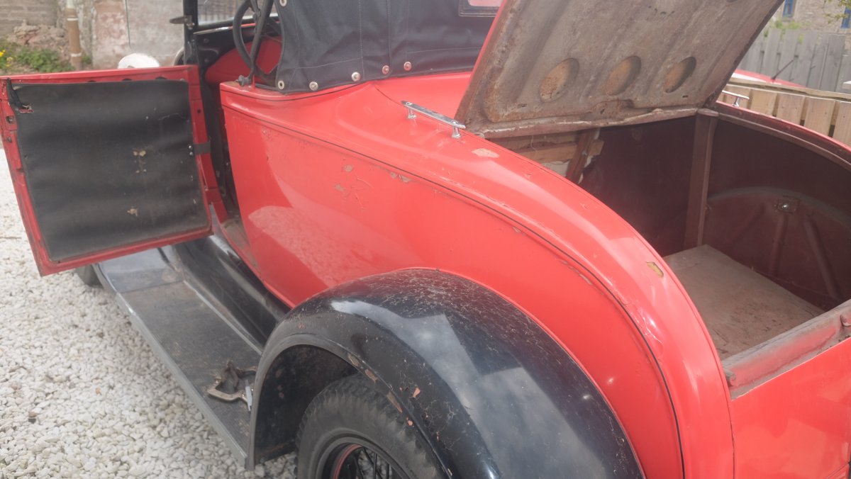

    I bought a 28 roadster recently, First off Im not complaining about my purchase , Im a big boy and when I make mistakes they are my mistakes, I just have to pull myself out of them :)
    Anyway I paid to much for this one, but bear in mind my purchase price included shipping and handling to the UK and a profit to the sellers . Its the way the world turns :)
    Car looked kinda decent in pics ( dont they all) and fortunately ive done this so often I pretty much always expect the worst .. some times Im surprised and the stuff is spot on but most times Its junk as expected .. No harm done, I enjoy saving them :)
    So check out the pics what you buy and what it turns out to be isnt always concours material .. but its all fixable .
    In this case I went for convienience and bought new rear quarters, doors and upper trunk panel .. The rest will just have to be fixed .
    Fenders, well they wont be used , chassis and running gear will go under a 27T whils the 29 will be deposited on some genuine 32 rails ..
    Left rear quarter turned out to be a large section of sport coupe including the subrail and cross rail and weled up ( roughly) the upper deck panel was actually 2 x coupe panels , the doors looked like they were rescued from a creek bed , the deck lid had at least 10lbs of filler on it as did the gas tank/ cowl
    The fire wall was decent as were the front A panels and funny enough the rear lower deck panel . The gas tank was rotten through behind the gauge cluster and the gas in the tank was like tar..
    Engine run after a going through , steering box was worn out , gear box sounded as if it was just filled with random chunks of metal and the rear axle sounded as though several teath were missing from the crown wheel and the pinion bearing had colapsed .. the roof bows were err bowed and the frame was broken at the body hinge ..
    I actually managed to drive it once I got it running but it was kinda like a circus car lol.
    Knowing by this time it was junk and being £10k in to it, it was a toss up, flip ii or build it . I dont like selling cars its all to stressfull so decided to build it :) or should that be save its sorry ass .. Knowing what I know now I would have been quids in buying a brookville .. but wheres the fun in that , as it is it will be half and half :) best of both worlds :)
    The rusty no paint 27 t roadster body I just bought is much much better condition than this 29 with paint , I broke all my own personal rules when I bought the 29. Its better to buy em desert burned and solid and take it from there .. at least you can see what your buying without the cosmetic makeover..
