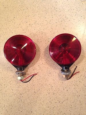

    Use truck lights with hollow threaded studs on top....this way you drill one hole in the bottom of the panel.....wires p*** up through hollow stud , cheap and looks bad *** too... image.jpg

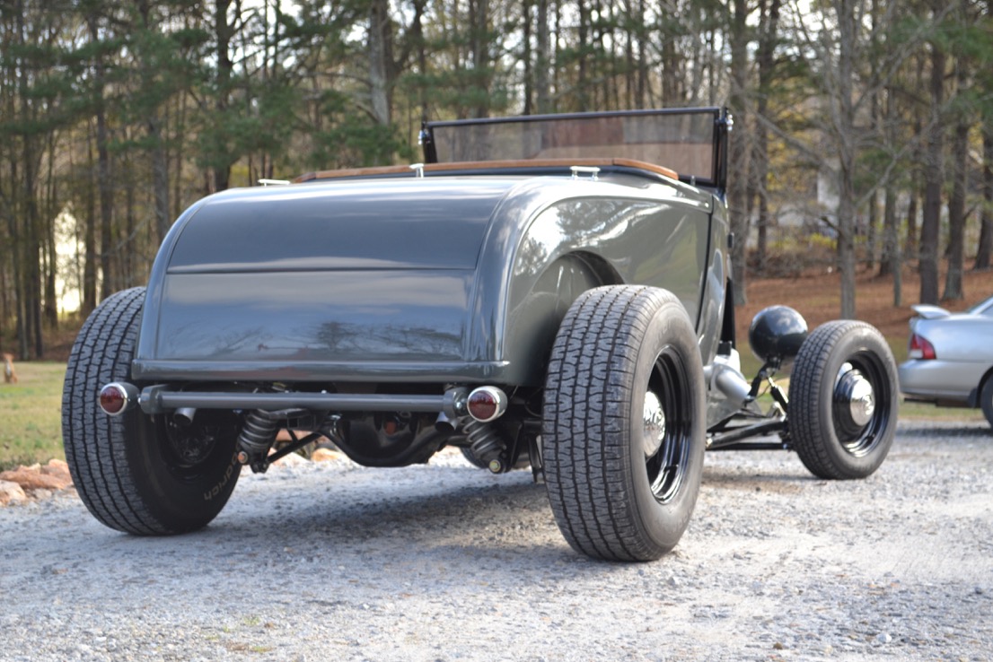

    We used Ford 37's on this 28 roadster. Welded rear pieces of 32 frame to back of shortened 32 frame and added a spreader bar/bumper to stick out past end of car. Mounted the 37's to the frame horns instead of body. Rear2.jpg

    woodhawg.....great looking car!!! Very tastefully done. You should show more pics!
