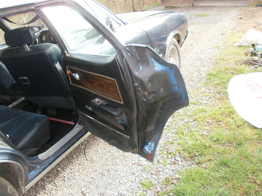

  23. Jalopy Joker.I always had old station wagons but this one I sold 12 years ago and found it just sitting in a garage for the last 10 years. I had to have her back.She road worth now but needs paint due to all the bird poop stains on her and the knuckle head that had her shot black matted paint on all the door jams and door frames and its peeling. I want to go back to the original light blue paint and get rid of the dark blue paint I painted 12 years ago.It looks like **** when I open the doors .The only thing this one isn't H.A.M.B . friendly so the picture may get deleted. I will post a pictures of the door jam later today. Thanks Bruce. 001.JPG

  30. Heres a picture of the rear door on the Olds wagon and lower inside of the rocker..Bruce. 001.JPG
