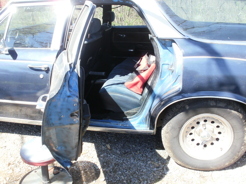

  28. Well I tried oven cleaner but it didn't even make a dent in it. So I went with the wire brush and the drill. It seem to work real good at least now you can see the blue again. Heres a before and after picture of 1 door I did today.Bruce. 001.JPG
  30. oldsjoe
    Joined: May 2, 2011
    Posts: 2,644
    oldsjoe
    Lookin much better Bruce! How long that door take ya? Now you might try and rub it down with reducer or lacquer thinner. That might take off what's left. Try a small spot to see if it lifts the original paint. Joe
