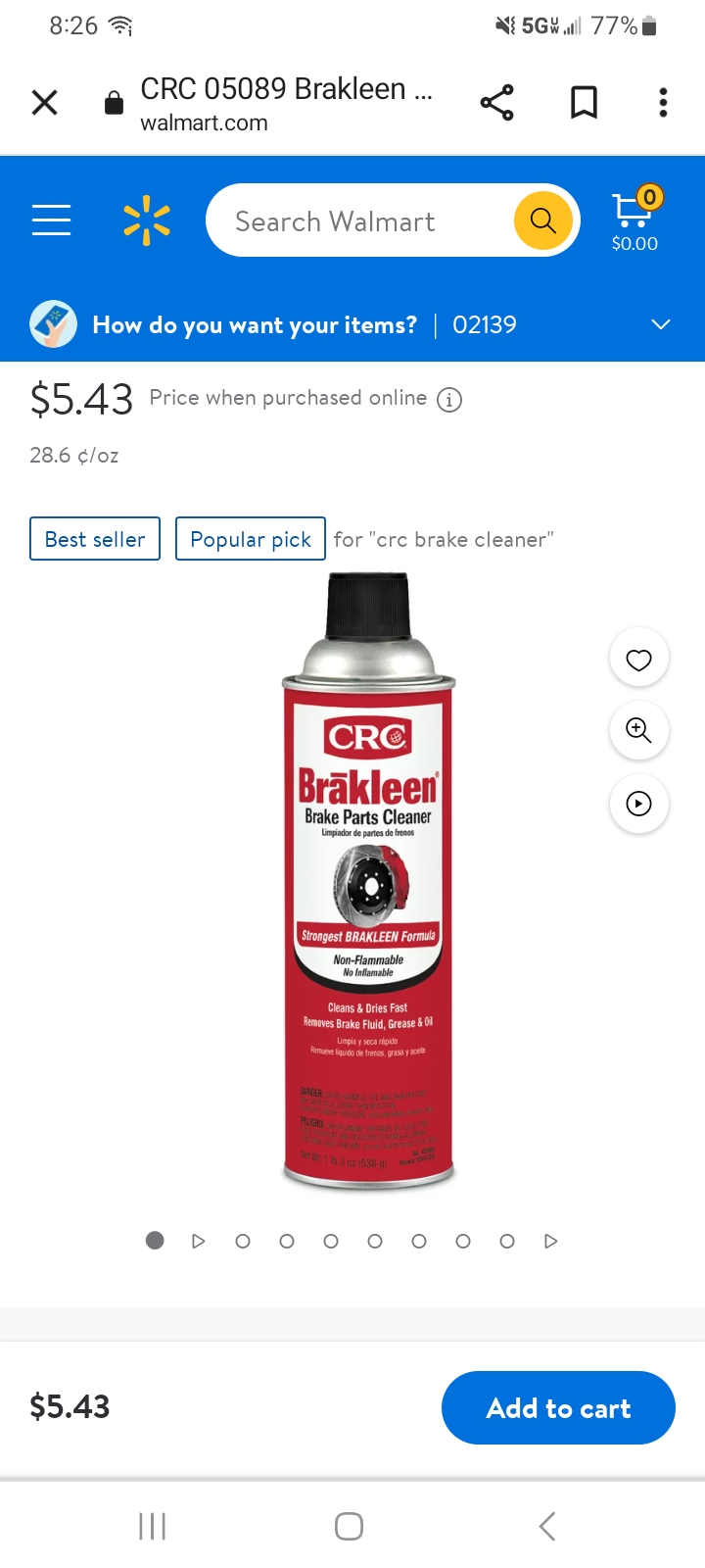

  5. wheeldog57
    Joined: Dec 6, 2013
    Posts: 3,849
    wheeldog57

  7. Budget36
    Joined: Nov 29, 2014
    Posts: 15,305
    Budget36
    That’s worth a shot.
    Thanks!

    https://www.zoro.com/crc-5-gal-brak...0fffd17e13c818fb9514b58036a30b2e&gclsrc=3p.ds
    Budget36 likes this.
