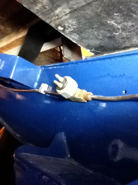

    Hi guys -
    Can someone please tell me what type of electrical connector fits the terminals on this brake switch? Apologies pic isn't better, it's tough to get a good photo under the rpu.
  2. Female plug.
    You can get a package of them at any auto parts house.HRP
  3. 26hotrod
    Joined: Nov 28, 2009
    Posts: 1,141
    26hotrod
    from landis n c
    Take the switch off and go to NAPA. I am sure they have one...................................
  4. Slopok
    Joined: Jan 30, 2012
    Posts: 2,956
    Slopok
    No need to take switch back off. They will have a pressure switch in stock.
  5. bantam
    Joined: Oct 16, 2006
    Posts: 417
    bantam
    Thanks for the info guys!
    Much appreciated. I'll hit Napa tomorrow.
    Bantam

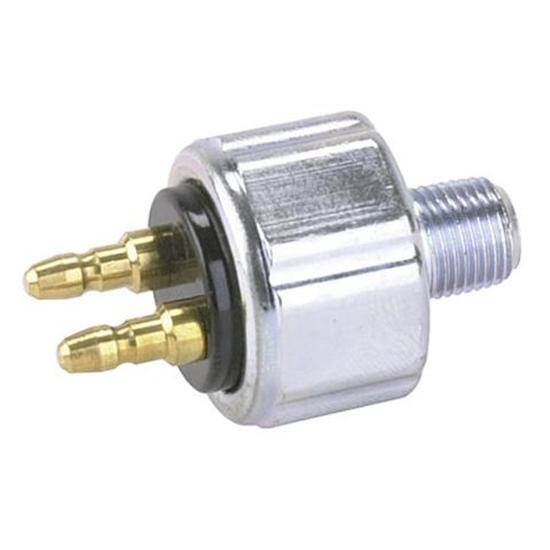

    There are ones with different ends.

  8. keep in mind that there are TWO sizes of those bullet connectors , i believe .156 and .177 diameter. i think that Ford brake light switch uses the smaller.....you better check
