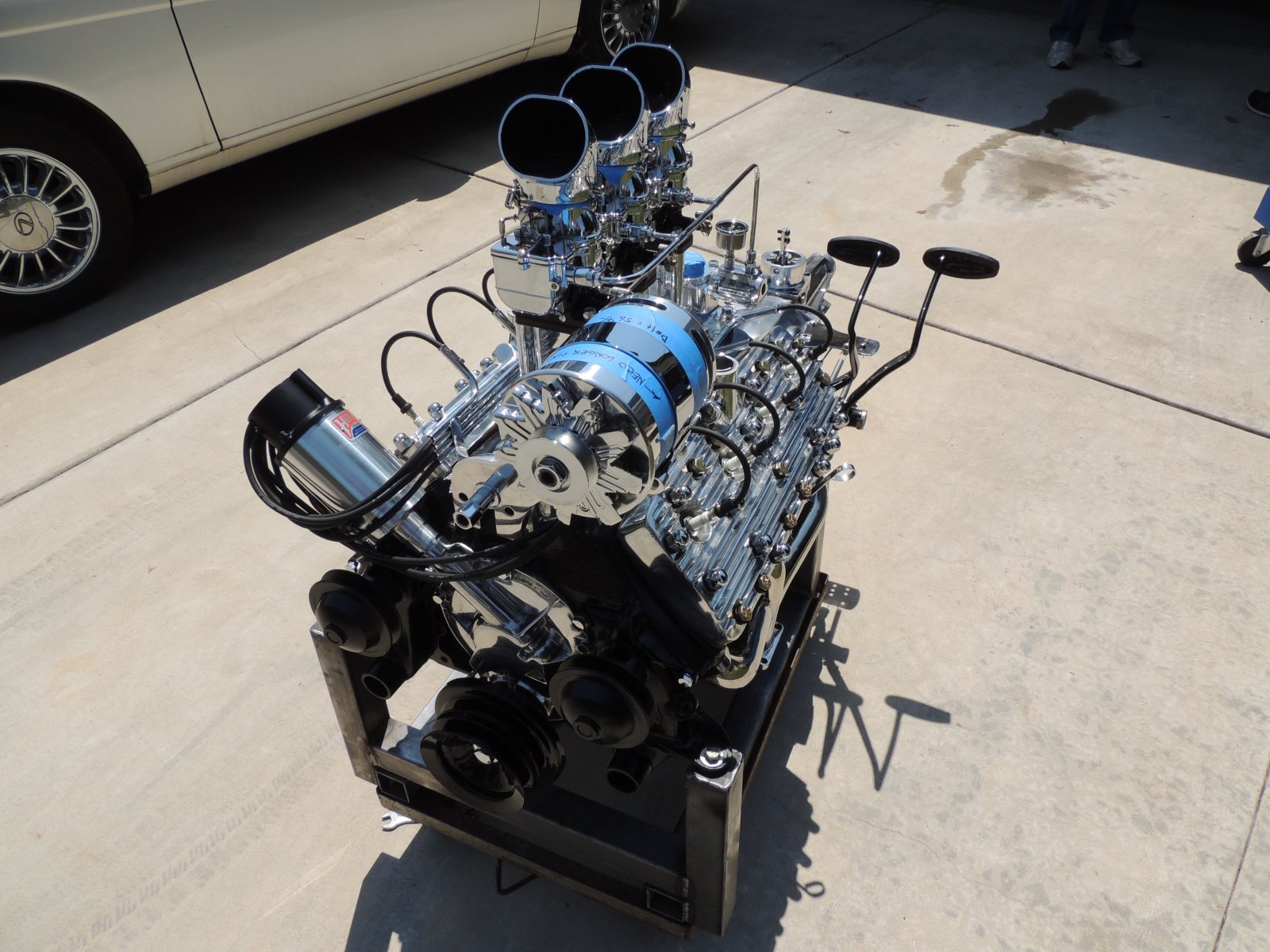

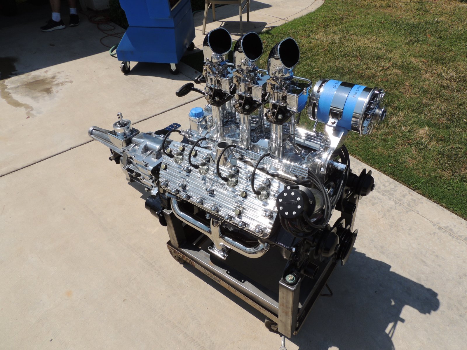

    I'm wanting to swap out the existing electric fan for a stock mechanical fan but I don't know what type of bracket I need. It has a Navarro intake with an Offy offset generator stand.
    Appreciate any help guys.

    Very fancy , nice. With out knowing what car its going in makes an answer difficult. An early car you may well run out of length room .is it a model A?

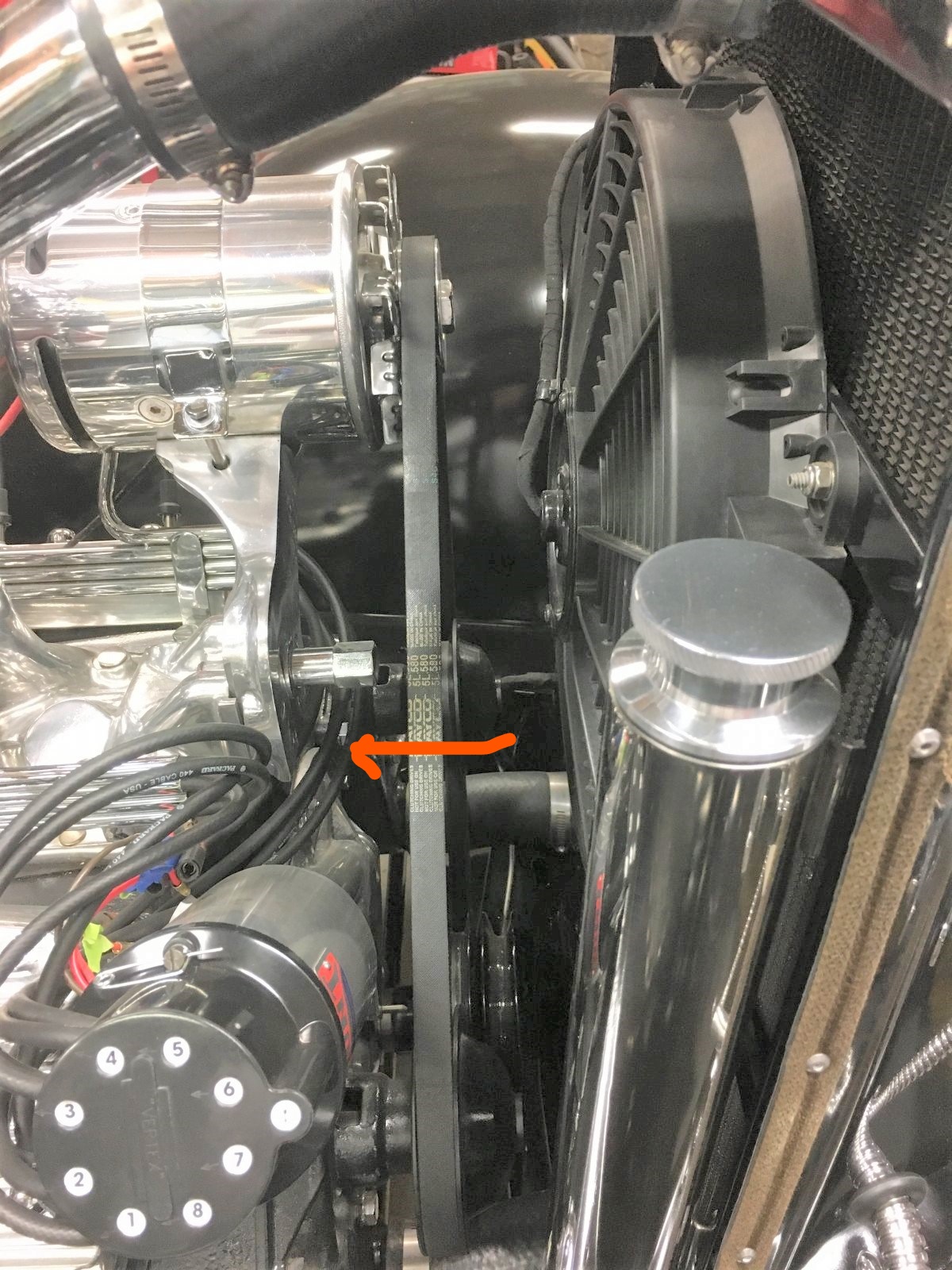

    It's actually in a 30 Chevy but about the same amount of space. Went out and measured and there's right at 8" from the face of the radiator to the generator bracket.

    That's what I'm thinking. Might need to get creative with pulleys and bracketry.

    The generator looks like it's mounted too far forward, the stock fan bracket should work with the offset bracket. The generator normally runs off the back pulley and the fan off the front on the crank as shown on the bottom engine pictured by Mr48chev. Looks like you are running early heads and intake with late timing cover and pulley so don't know if the stock fan will work and adds several inches to the front of the engine.

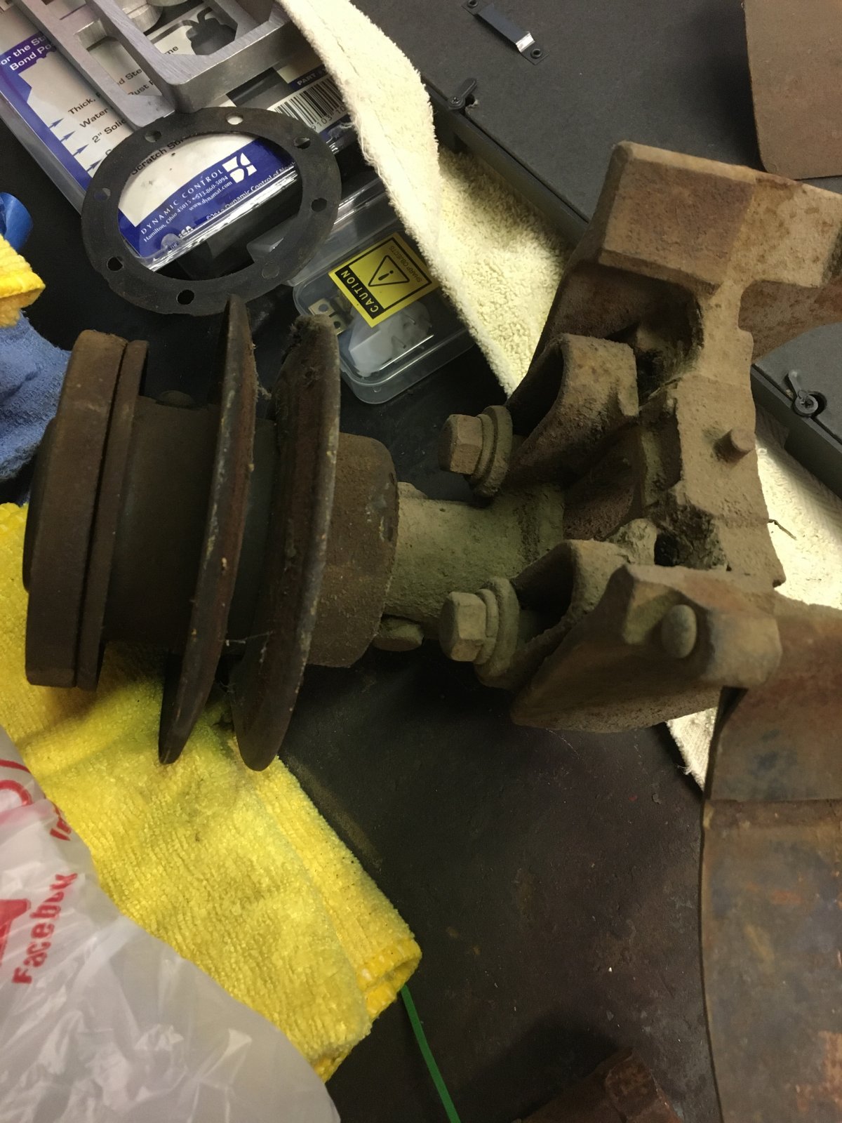

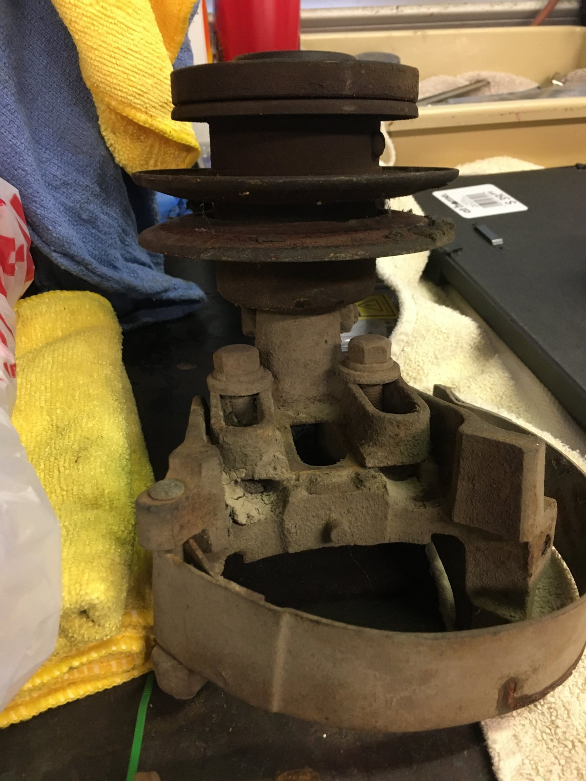

    Well, after a little digging I found the original fan setup. It's exactly the same as the diagram above. Now I understand why there is a long nut to tighten the bracket to the intake. That way you can get a box wrench on it around the two bolts that hold the fan carrier. The Offy offset bracket I have is the same thickness as the OG generator bracket. By that measurement, everything lines up with the front groove of the crank pulley AND the overall length including the fan blade is about 6-1/2". I have about 8" to the radiator so...Success! Just need to straighten one of the fan blades.
    It's going to cost my left nut to chrome all this stuff but, I'm not using it anymore anyway. It will look so much better than the electric fan.
