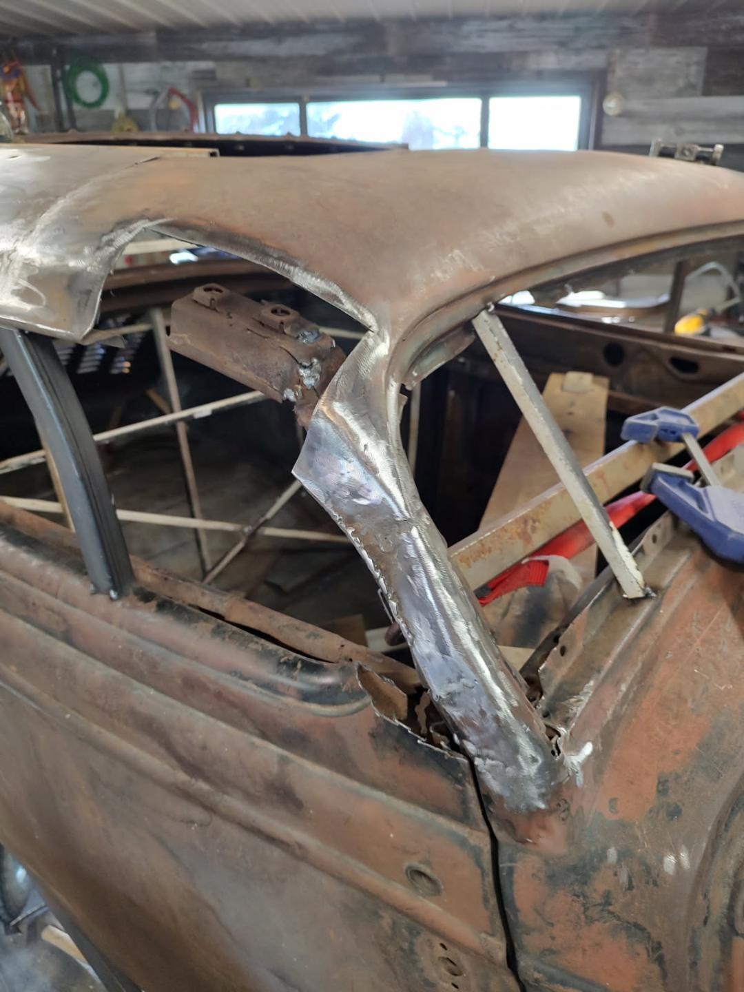

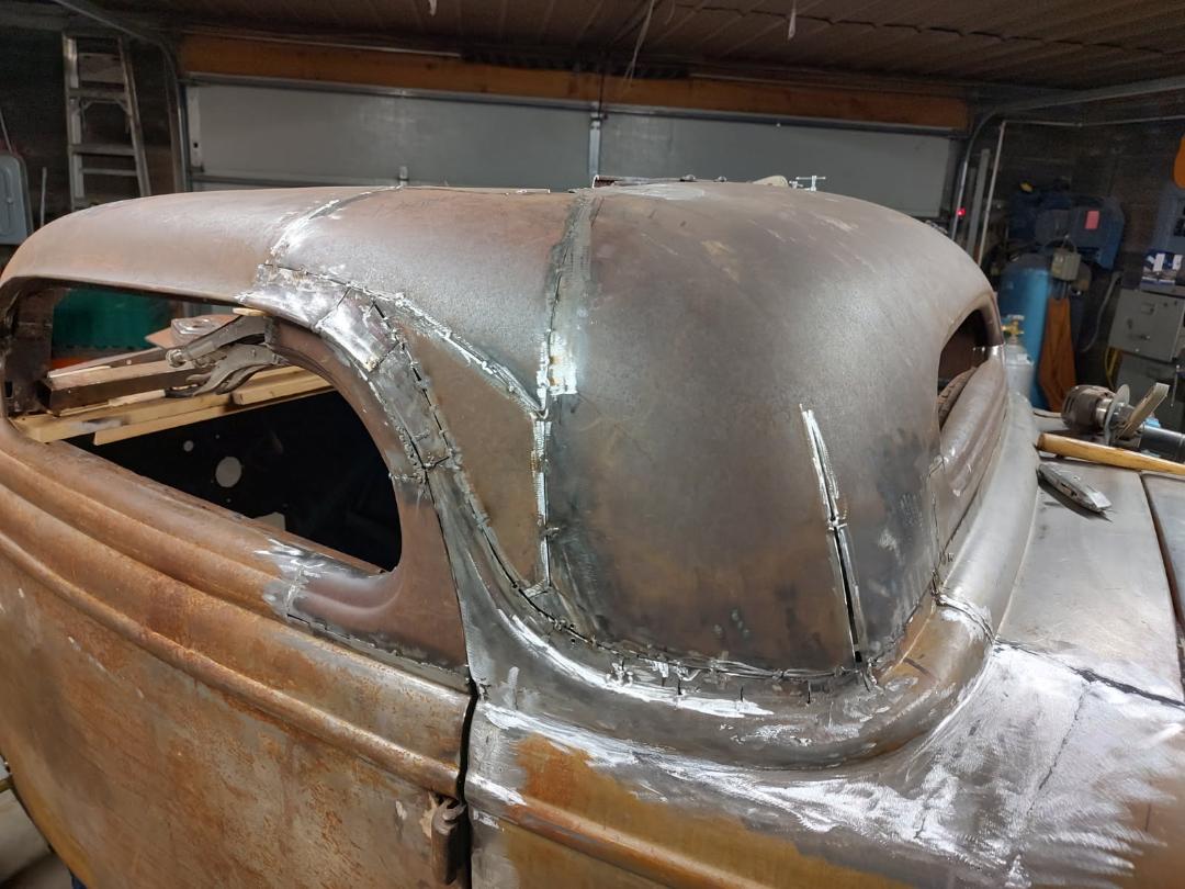

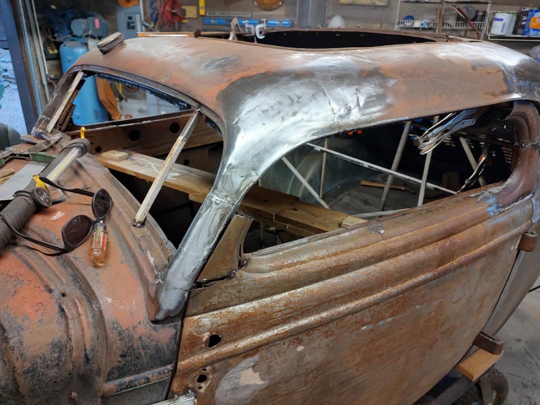

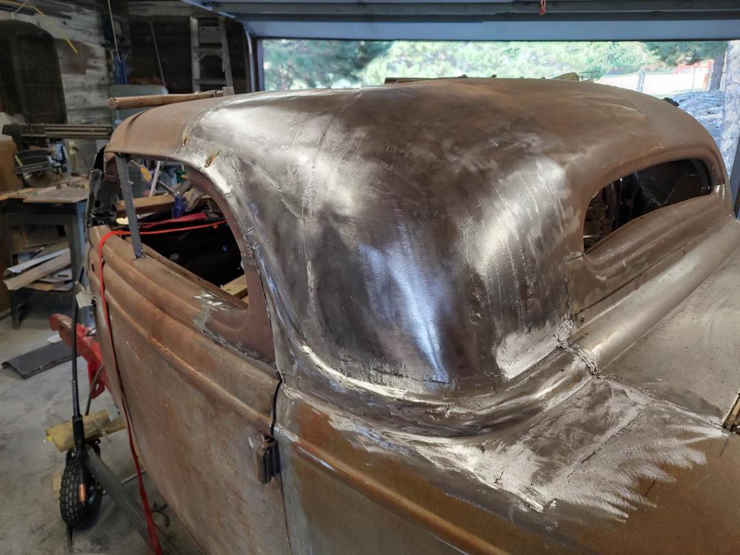

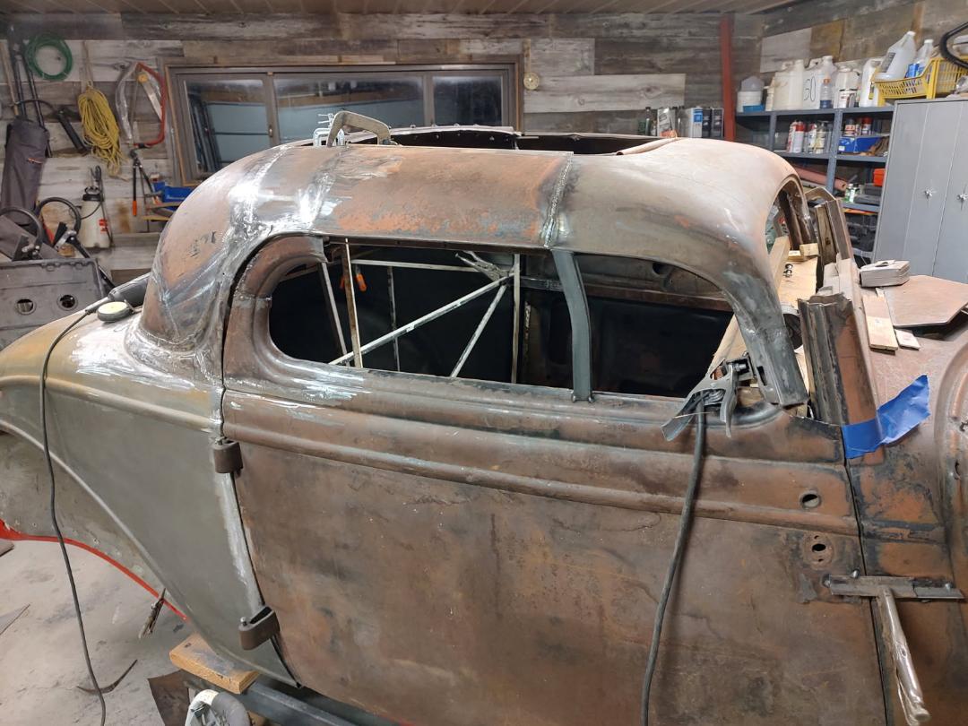

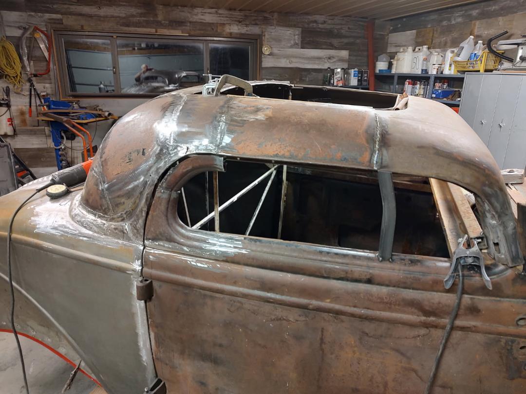

    Well after about a week I have got the Fordor roof figured out. The driver side went together like it was meant to be, everything flowed together. The p***enger side on the other hand was a different story. It was shaped differently. The whole side had a different contour, drip rail was smaller, etc. I ended up taking it apart and using part of the Tudor front roof and a section of the 36 roof corner. Took a lot of slicing and dicing. I still have to weld the driver side and do a little more detailing to the p***enger side, but I think I'm on the downhill slide. Next will be the front wind shield posts then I'll work on the top opening. thumbnail (20).jpg thumbnail (19).jpg thumbnail (18).jpg thumbnail (17).jpg thumbnail (16).jpg

  12. @2deuces64 Nice job! I'm curious, did you use templates to determine the 2 sides were shaped differently and then to bring them into similar shape, or a calibrated eye?

    I stood back and looked at it from the back, it just didn't look right. I then made a wire form from the driver side and placed it in the p***enger side , same area and it was off (Low) by about 3/8 ". It also had a peak about halfway above the door. It's a lot closer now, nothing a 1/2" of bondo won't fix:eek::rolleyes:. As KiwiKen once said "Bondo is my friend"

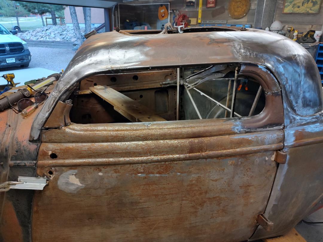

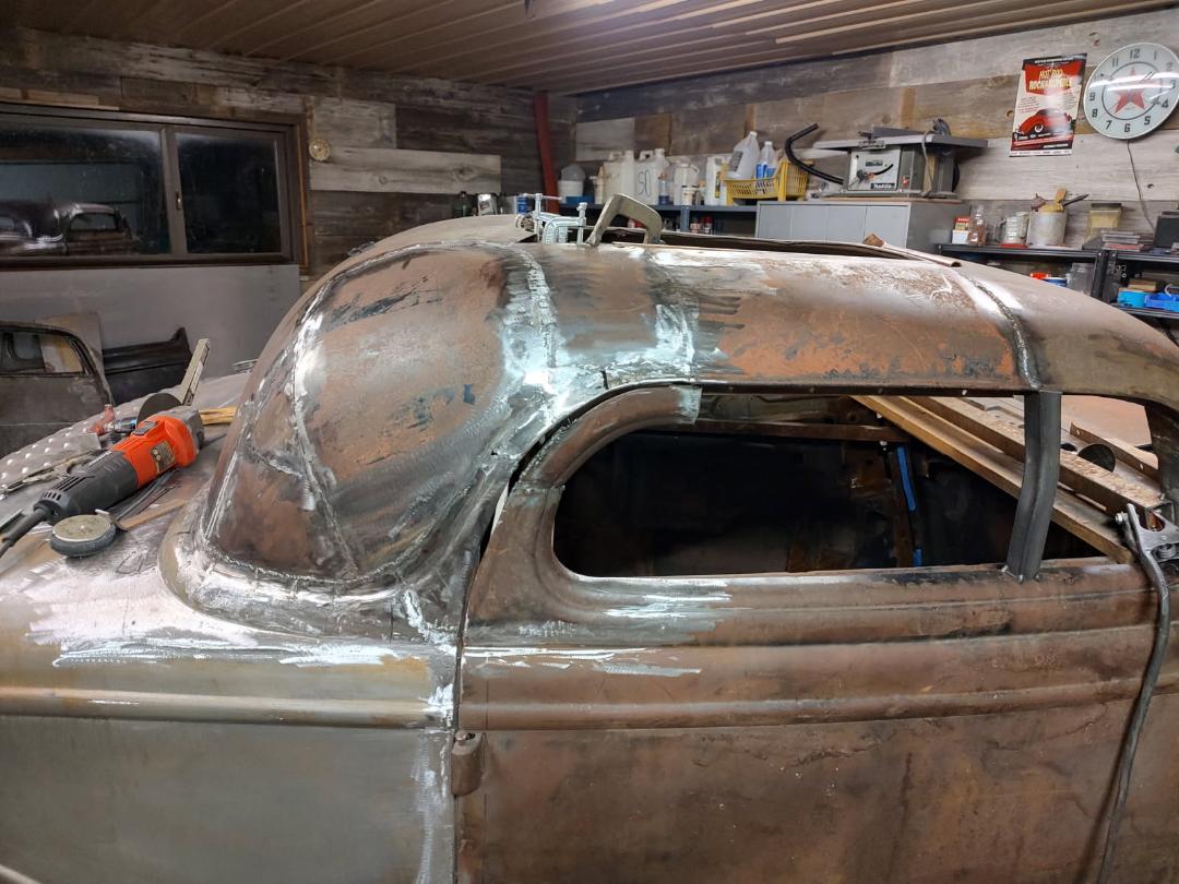

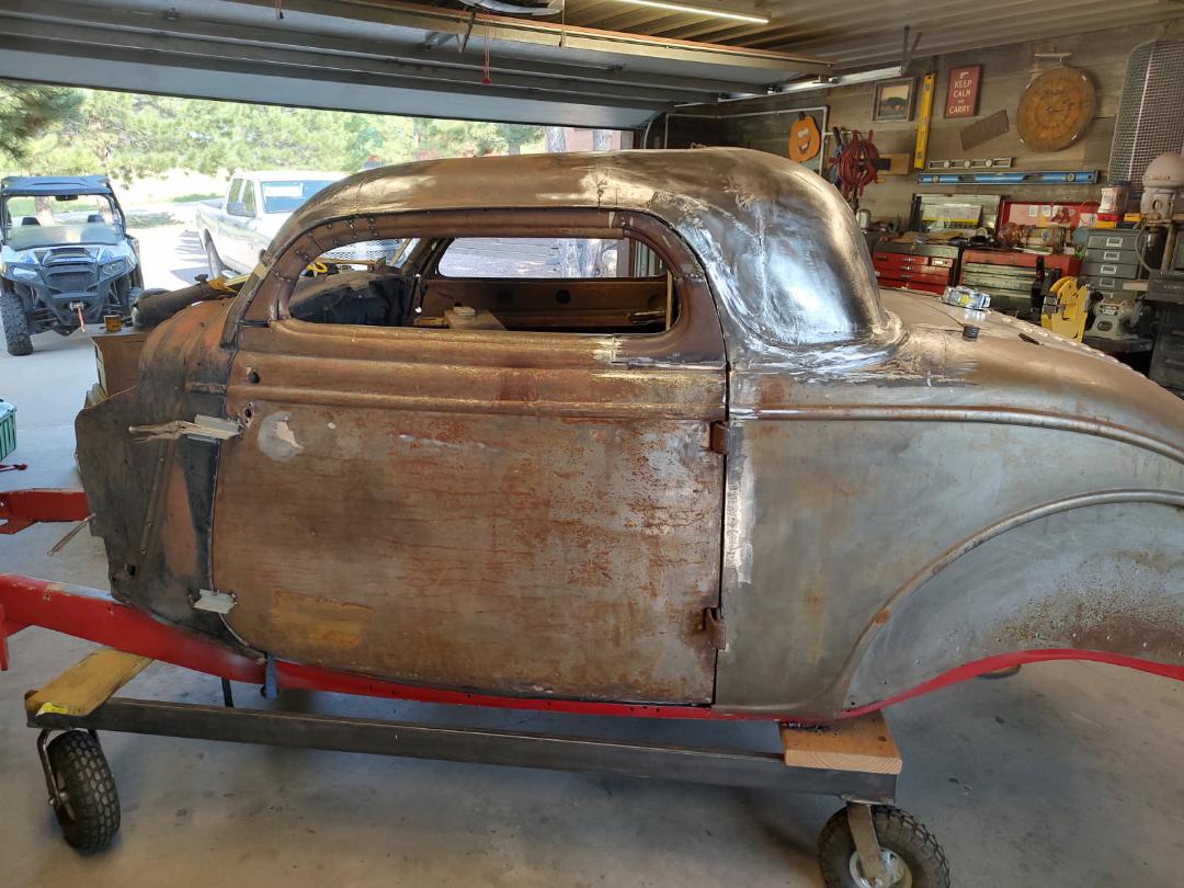

    Thanks for all the Kudos. Got a little more done yesterday and today. thumbnail (25).jpg thumbnail (24).jpg thumbnail (23).jpg thumbnail (21).jpg

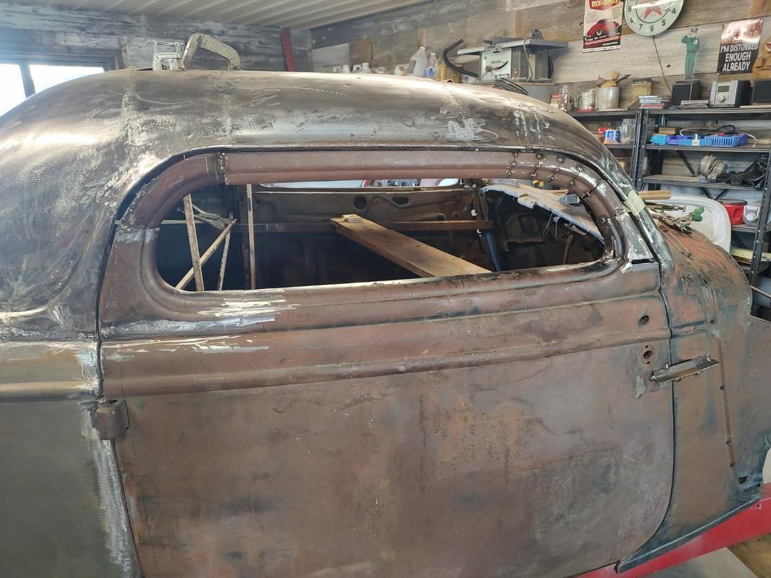

    A little more today image000004.jpg thumbnail (54).jpg thumbnail (53).jpg thumbnail (37).jpg

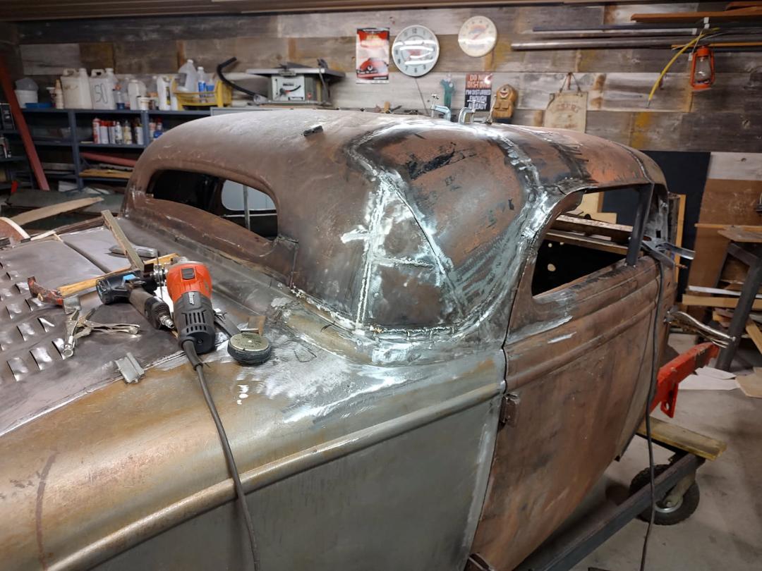

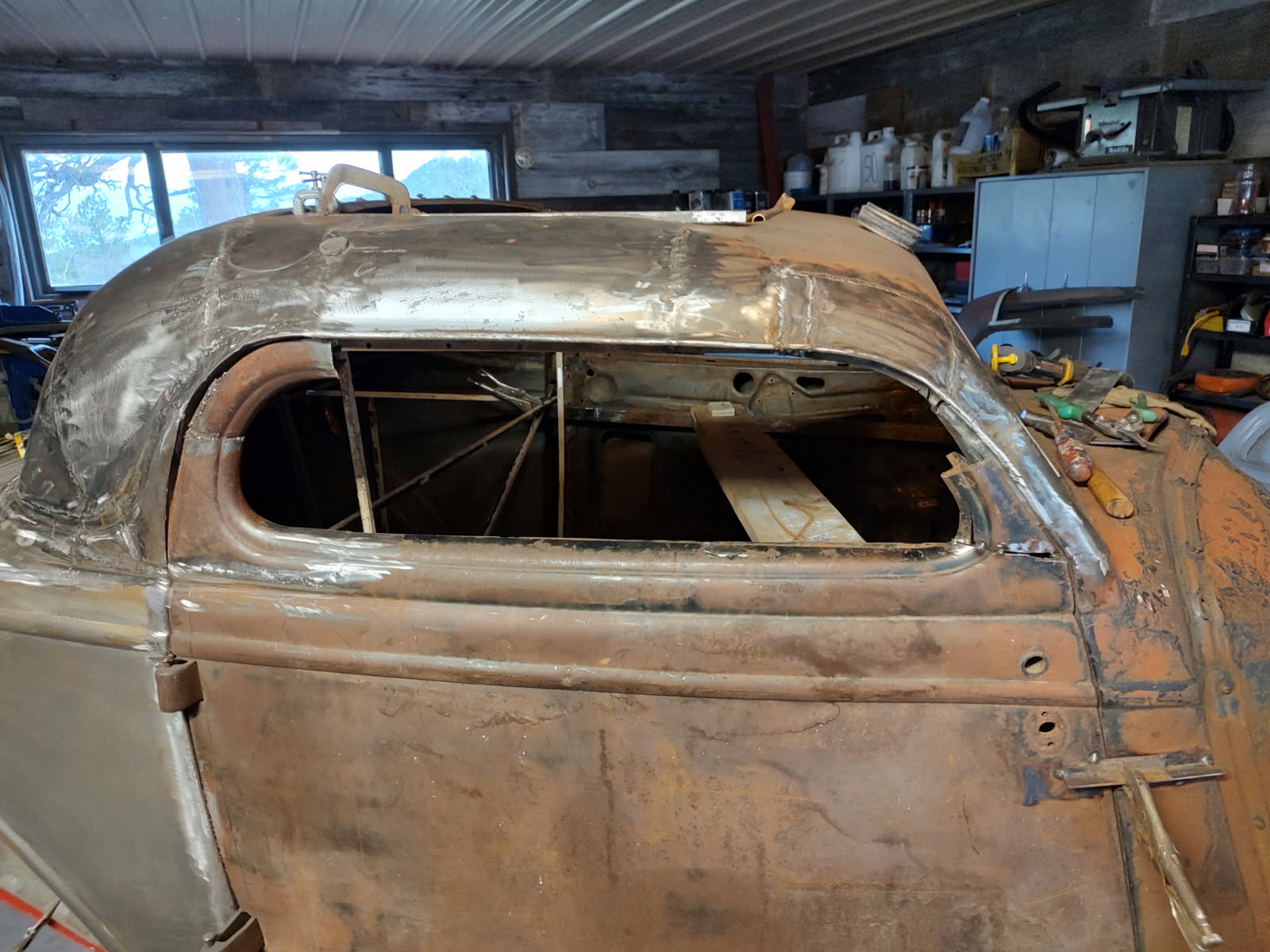

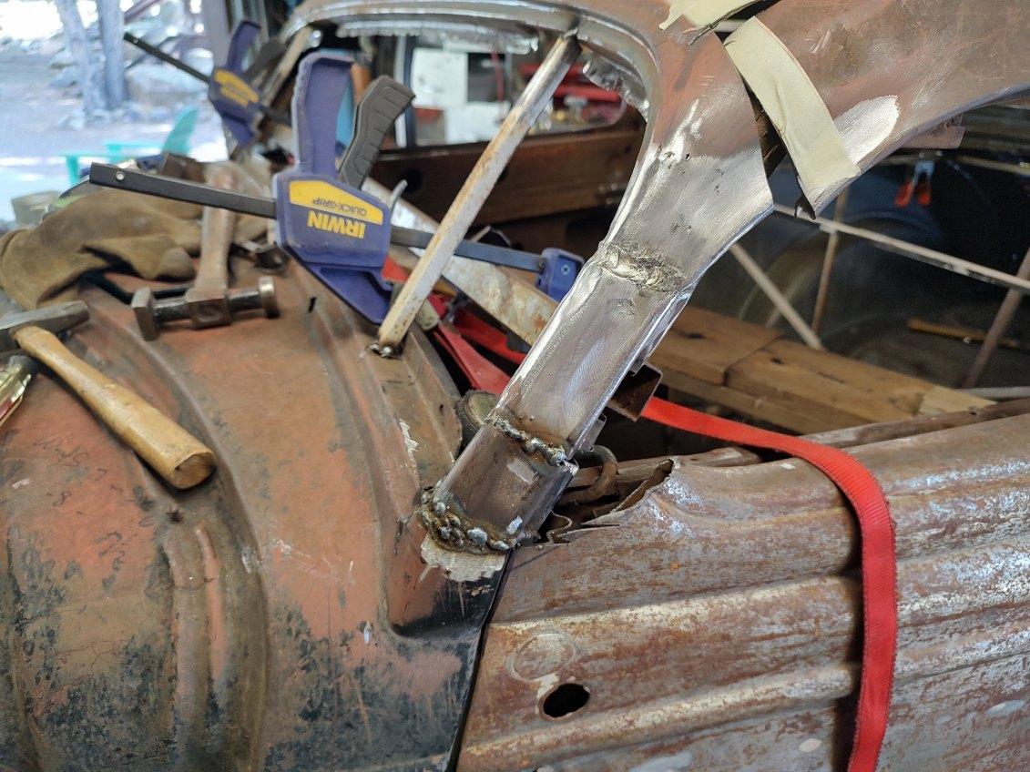

    Thanks, A couple more pix as of today. Won't be working on it for several weeks, so there won't be any progress for a while. I'm going to have to work on the gaps especially on the p***enger side, I may have to redo the drip rail on the back curve. It's just doesn't have the same profile as the rest. I'll get it figured out. thumbnail (56).jpg thumbnail (55).jpg
