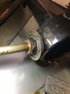

    I had a strut rod nut and bushing come off at about 700 miles. This was after putting the car together, driving around the block, and heading out on a 1500 mile trip. Learned the hard way that the factory used LOCKnuts there. Held it together with a ratchet strap while I drove around trying to find a 9/16 fine thread nut...

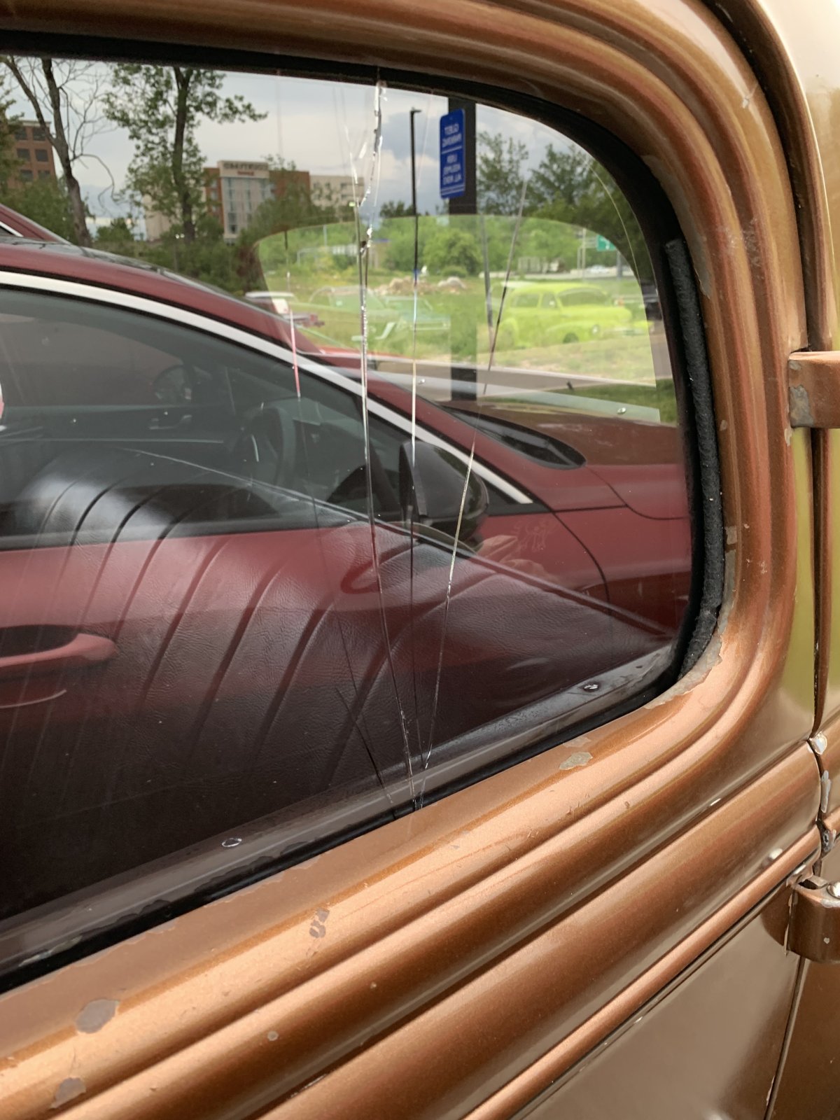

    Inline electric fuel pump failed (fairly common failure), then broke the p***enger window due to a binding mechanism coupled with overly tight felts.

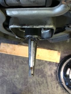

    With my '51 F-1, I forgot to put the retaining clip on the pivot pin that connected the brake pedal to the Master Cylinder push rod. Ran into town (13 mi) to put the first full tank of gas in it. On the way back home, the pin finally fell out coming up to a T-Intersection, and the brake pedal fell to the floor. Thankfully, I was able to just start down shifting and banging the gears got it slowed enough to turn the corner. No traffic, definitely helped. Cleaned my shorts out, popped the pin back in and drove the last mile home.
