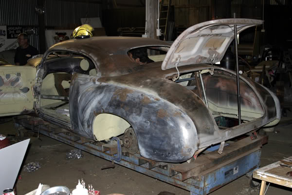

  24. This Single Spinner (Aussie Slang for 49-50 Ford) Started life as a 4 door.
    Don't worry it won't be getting a SBC, Plans call for a SCoT Blown Y-Block
    MumsSpinner2A.jpg MumsSpinner3A.jpg MumsSpinner4A.jpg MumsSpinner6A.jpg MumsSpinner9A.jpg MumsSpinner10A.jpg MumsSpinner11A.jpg MumsSpinner12A.jpg MumsSpinner13A.jpg MumsSpinner14A.jpg MumsSpinner15A.jpg Cut down '51 Ford tail light lenses
    The Bonnet has been pancaked & the Head lights have been hooded

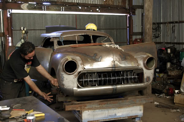

  26. Well the Kellerman Roadster is back getting a rebuild after being involved in an accident earlier this year
    The Damage a first look does not appear to bad, but in closer inspection the frame had been tweaked & the body is twisted in the back from the hits it received
    All four guards had taken a hit BrettsRoadsterDamage3.JPG BrettsRoadsterDamage7.JPG BrettsRoadsterDamage10.JPG BrettsRoadsterDamage12.JPG BrettsRoadsterDamage2.JPG
    Here you can see how badly bent the cast axle is
