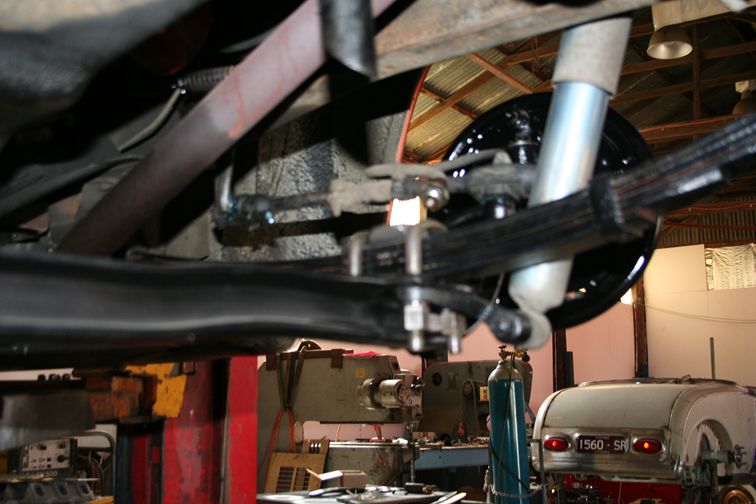

  3. Next up was to pull the body of the chassis so it could be squared up & make the little modifications needed
    BrettsRoadsterUpgrades74.JPG BrettsRoadsterUpgrades75.JPG BrettsRoadsterUpgrades80.JPG
    unfortunately our chassis bench (Master Bench) had another car sitting on it so we used one of our normal work benches to sit the chassis on (still a lot more sturdy then most peoples chassis benches)
    One of the modification after straightening the frame was to notch the chassis for spring clearance on the front BrettsRoadsterUpgrades89.JPG
    We notched the cross members so that the Fuel & Brake lines could run through them neatly BrettsRoadsterUpgrades84.JPG BrettsRoadsterUpgrades85.JPG BrettsRoadsterUpgrades88.JPG BrettsRoadsterUpgrades87.JPG
    We also fitted a through brake line fitting in the rear cross member so that it would look a lot neater
    BrettsRoadsterUpgrades86.JPG BrettsRoadsterUpgrades90.JPG The last modification (that I can remeber off the top of my head) to the chassis was to change the hairpin mount brackets to suit tie rod ends instead of rod ends

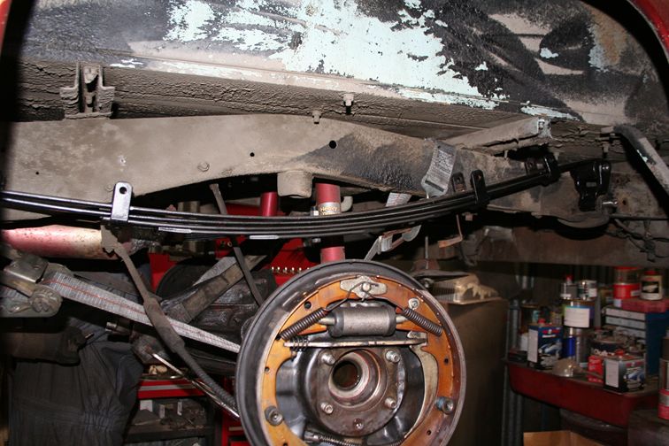

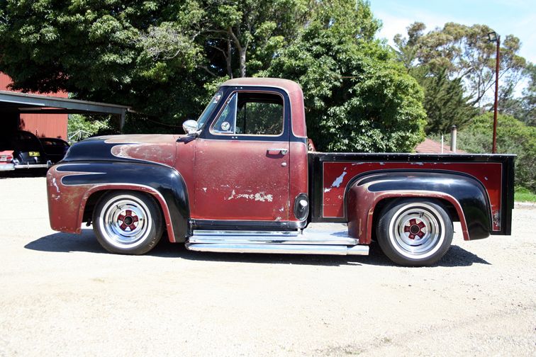

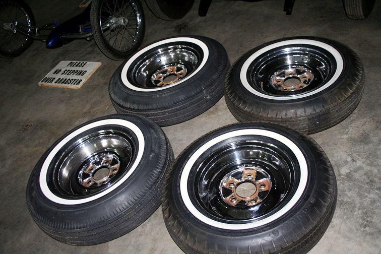

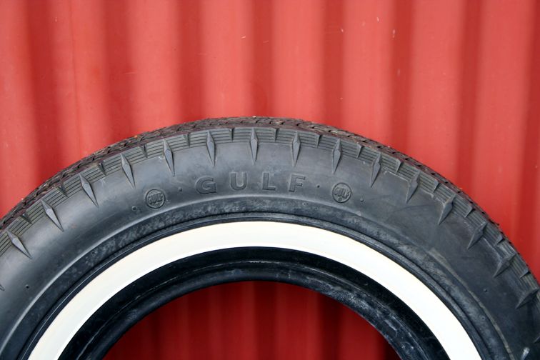

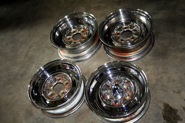

  17. I thought I better put up an update as has been nearly a year
    First up is the Joe Botti F100
    We have lowered it back to how it was rebuilt in 1964 & also replaced the ugly smoothies & radials with original Appliance Plating Reversed Steel Wheels & Cross Plies JoeBottiF100Lowering3.JPG JoeBottiF100Lowering6.JPG JoeBottiF100Lowering7.JPG JoeBottiF100Lowering8.JPG JoeBottiF100Lowering9.JPG JoeBottiF100Lowering10.JPG JoeBottiF100Lowering11.JPG JoeBottiF100Lowering12.JPG JoeBottiF100Lowering13.JPG JoeBottiF100Lowering14.JPG JoeBottiF100Lowering15.JPG JoeBottiF100Lowering16.JPG JoeBottiF100Lowering17.JPG JoeBottiF100Lowering18.JPG JoeBottiF100Lowering19.JPG JoeBottiF100Lowering20.JPG JoeBottiF100Lowering21.JPG JoeBottiF100Lowering22.JPG JoeBottiF100Lowering23.JPG

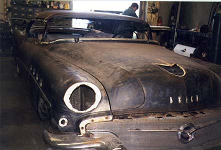

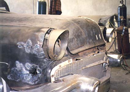

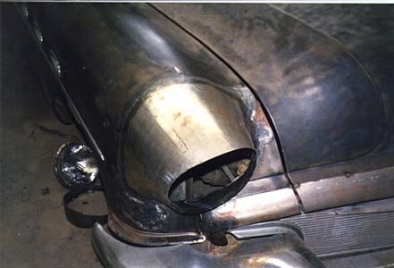

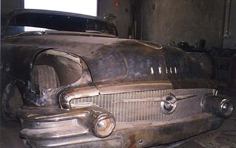

  18. Been a while since I have put up an update
    here is some work my Father (John) did around 20+ years ago
    Jaguar XJ6 Headlight rings in a Buick Roadmaster
    0J75WC.JPG 0J76WC.JPG 0J77WC.JPG 0J78WC.JPG 0J79WC.JPG 0J80WC.JPG 0J81WC.JPG 0J82WC.JPG 0J83WC.JPG 0J84WC.JPG
