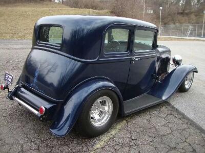

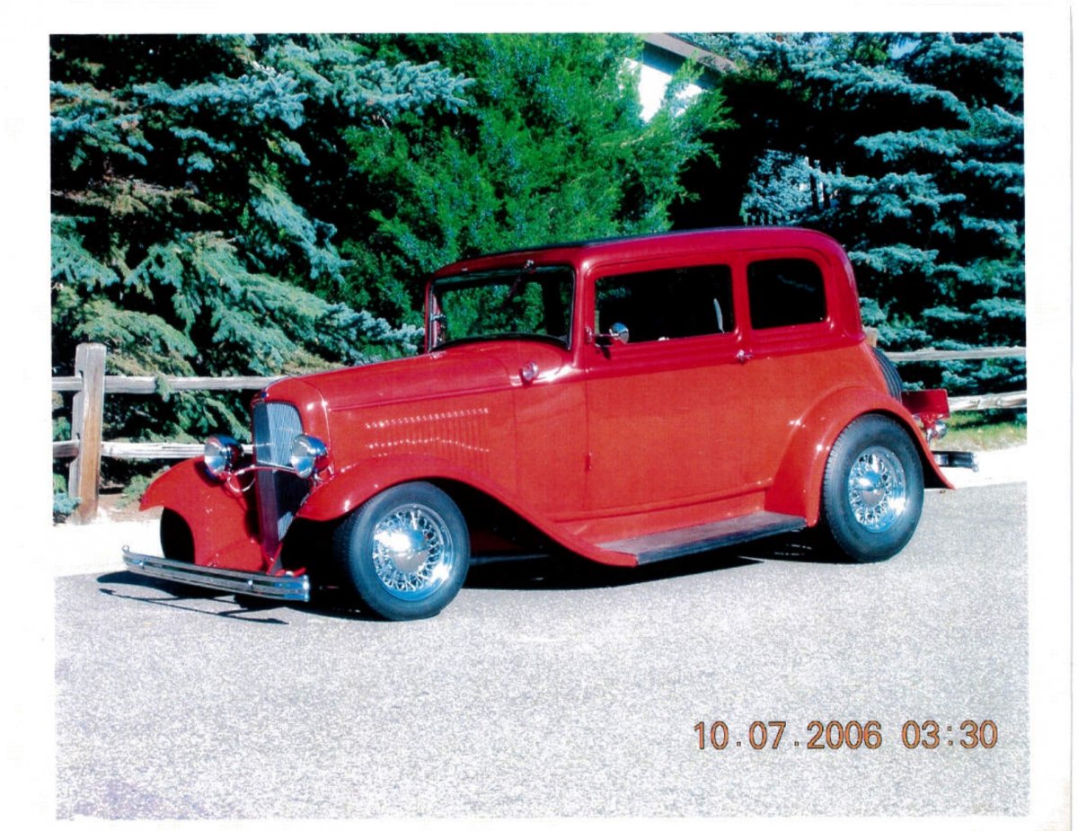

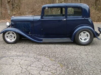

    I prefer same size wheels, not much rake, if the car has rake, build it into the suspension. Bigs and littles look great for width, when the front tires have to run significantly shorter sidewalls to get the rake, the stance loses something... for me.
    A Vicky sitting level or a little rake with same rubber all around could look great, depends on the rest of the build and if its riding high or lowered. Matching the rear fender radius to the tire is key.
    This one looks good to me with 15's
    This ride height with 16's and a tall sidewall would also work. Id still want to lower it a little to line up the rear fender arch with tire. Screenshot_20200727-143010_Chrome.jpg
