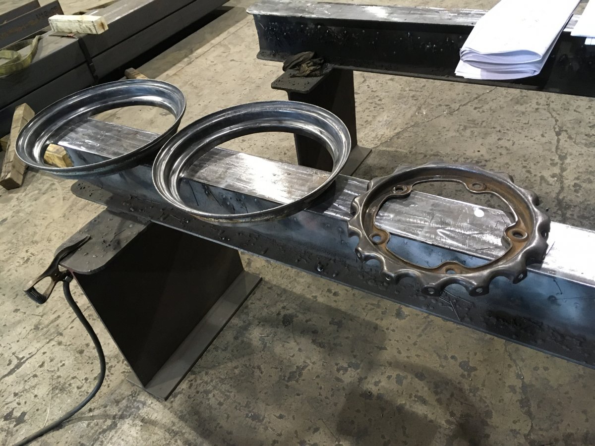

    I will make my own 16x5 wide five wheels out of the 16x4 rims. This gives me more possibilities to play with the offset too. C78BBEE6-4A10-4F9B-95E9-72C00D9C840B.jpeg

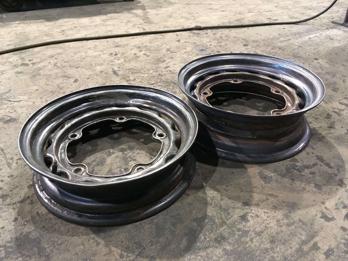

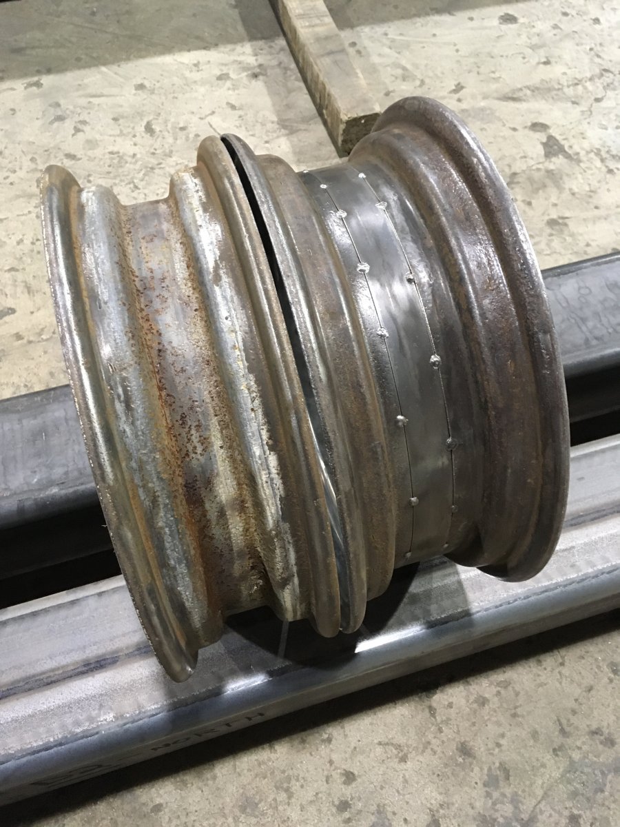

    353871DE-2749-48AC-A352-1A57E592E58E.jpeg 9AA07BCA-FDD2-44C8-9232-67A1FA6C26CB.jpeg F80351BD-4CEC-4DA5-8D1F-6C5E074CC22E.jpeg My modified wheel is now 16x5-1/8. I added a strip 1-1/4 wide, minus the 1/8” cut and the result is 5-1/8 wide. I set the center in the hoop with a +1-1/8” offset. From the front, it will look just like a stock 16x4 wheel.
    The positive offset will move the rear tires closer to the body. Since I’m building a rolling bones style car, the wheels should look better moved in on a fenderless coupe?
