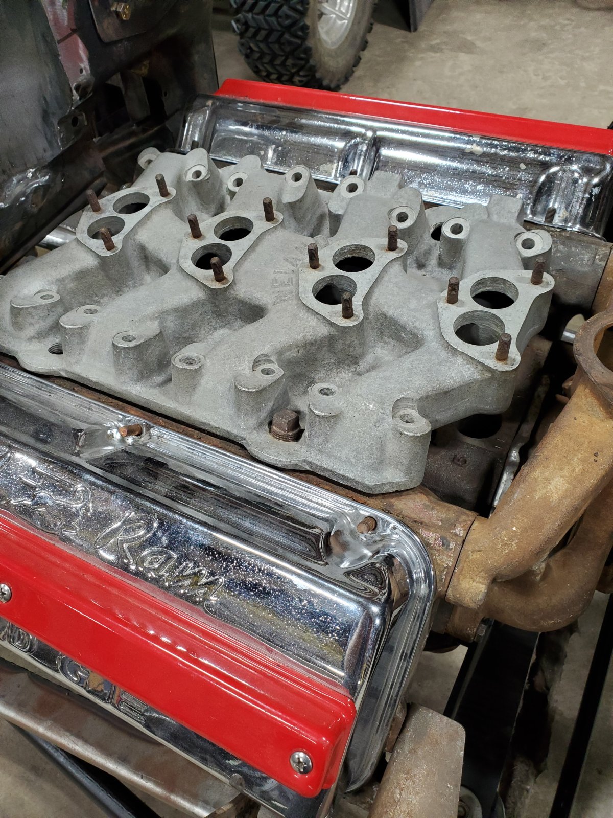

    would you drill and tap this intake for a pcv valve or just run a road draft tube?

    Well, a pcv is certainly the better way to go but, on a fresh engine it should not be ****ing much foul air. The advantage is that it will provide a negative pressure atmosphere and that is helpful in keeping things clean and some will suggest that it can help with ring seal. If you have concerns about 'looks' then you can mount the valve on the bottom of a runner or plumb into a spacer under the carb(s).

    My concern would be with a PCV plumbed into one carb or one runner, it would be running leaner than the other ones. I suppose you could use several T-fittings and hoses to pull from all carbs/runners equally but it'd look like hell. I'd go with a road draft tube for now.

    fresh build, going to start off with this edmunds, a lot less painful to tap into the spacer under the rear carb than a runner on a vintage intake, no matter how well i hide it.

    That looks like the plenum connects all 4 carbs, so it could be drilled and tapped at the rear, or even underneath, out of sight.

    Won’t half the engine run lean if you take it from the rear carb? A PCV is a calibrated vacuum leak

    If plumbed into the plenum on that manifold a PCV won’t make one carb run leaner than the others in any negligible way.
    I think PCVs work really well but if you’re not going to be dailying it and doing 25k a year I wouldn’t go to the effort of drilling a tapping it, in fact I wouldn’t even bother with a road draft tube, just fit a couple of filtered breathers and away you go.

    I did one on a OT tunnel ram. I would NOT on that.
    The guys saying plumb to exhaust, there are systems designed to create a pull and use a check valve. Problem is, it must not have ANY restriction - open header with short collector.

    hiding the pcv isn't the problem, i put a grommit in the hole for the road draft tube and install it there, but where do i plumb it to?

    I don't have a game plan on how to plumb it, but I'd want one if it was me. I tried to use the road draft tube on my flathead, and it was no bueno. Oil leaks, smells, stuff that most guys just put up with owning an old engine but not me. I fitted a PVC and all the leaks are gone. Mine was easy, that 4x2? Not so much. Maybe a hidden vacuum pump to **** that block out?
