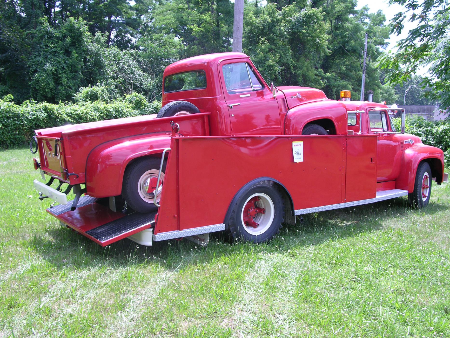

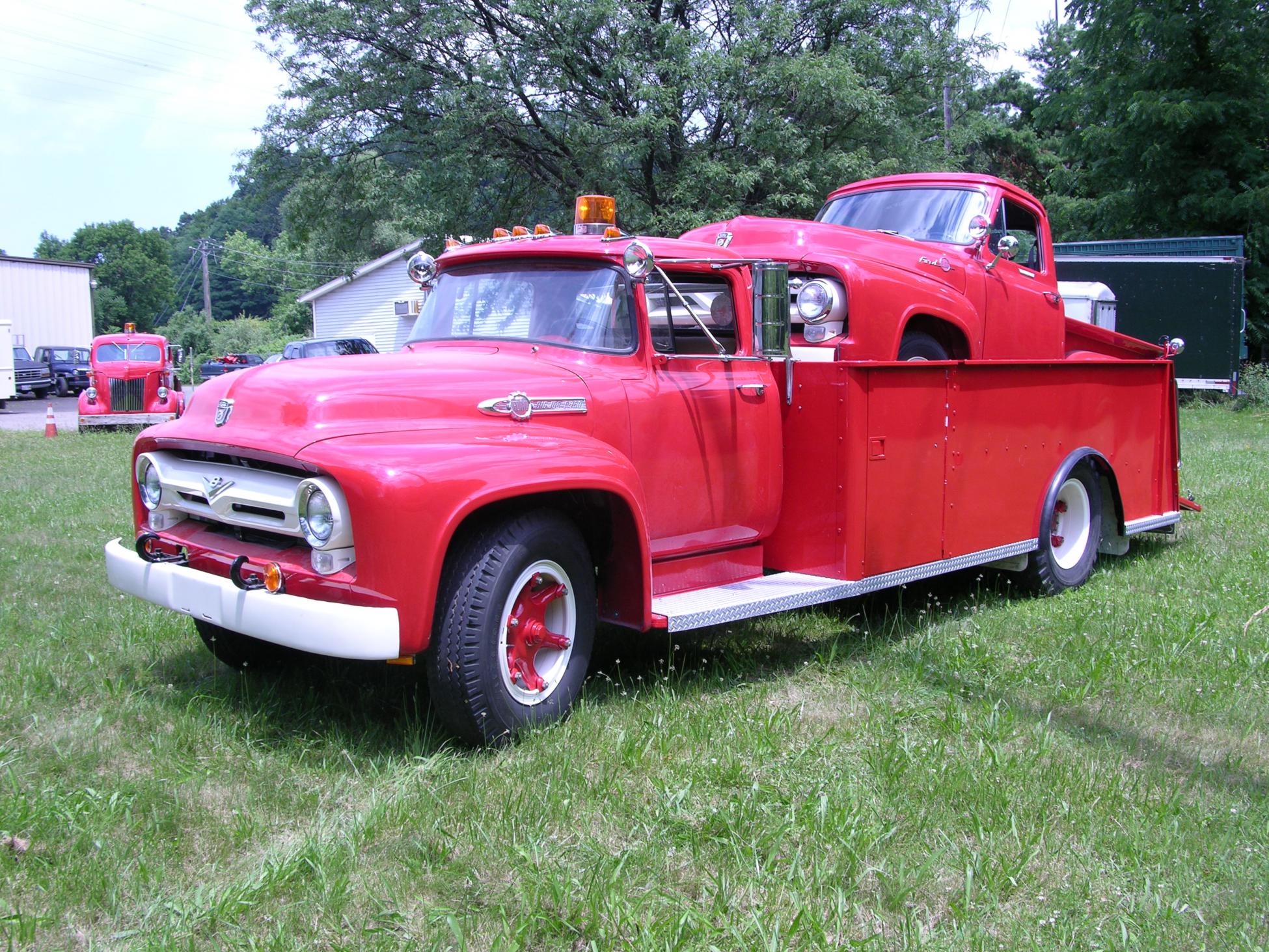

    I made a ramp truck out of a 56 F750 fire truck only to find out that the 5 speed transmition was made for city driving in a hill area. First gear is usless. I start in second, wind out third (3500 rpm) and drop into fourth gear ( direct drive) at only 1900 rpm. Over drive only gets me about 60 MPH @ 3700rpm.
    If I do any hills, I must use third for the whole hill and on the level I can go to foruth.
    I am sereiously thinking or a 454 Chevy with an automatic that I took out of a camper.
    The one thing that really breaks my heart is that I have to replace 6 tires that look brand new with only 15000 mi. on them but may be over 50 years old.
    ( The old DOT tire dating system only shows the last year of the decade as no one would have thought tires would last more than ten years)
  2. Roger
    it is not your transmission that is geared low it is the rear end. Most folks don't know it but for a fire truck to run 45 MPH it is hauling ***. They were never intended to run fast, just to get there is all they were ever intended to do.

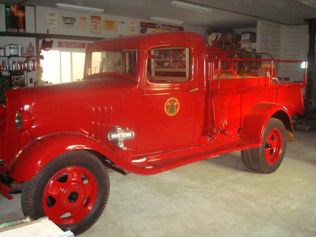

    Is it a G.M.C.? I couldnt see much marking, thought Chevy first and then second thought G.M.C would make more sense. It's cool, not sure what I would do with it. Outstanding spotlight on there! Thanx for sharing this unique vehicle. ~sololobo~

    Nice. One of the best and most useful firetruck rehabs I think I'ver ever seen.

    If you plan on driving it at all, you can pretty much forget the current setup. I recognize 5 bolt widowmakers a mile away. Also, gearing is going to flat **** so forget anything resembling highway speeds. Your best option is to find a newer utility truck or something and swap frames or do what I am doing this winter and drop the cab onto a 1 ton dually frame and build a bed for it. At least that way you would actually be able to drive it.

    No, don't need to do the whole ch***is swap thing which usually ends up with track widths and wheels that don't look right. You can easily swap to similar 5 lug ring wheels that aren't the 'widow makers' and are perfectly safe or even use older solid wheels. Studebaker used them a**** others. The Ford ones are the dangerous one though from what I understand. You can also swap the rear for a 5-lug Dana 70 out of an early 70's Dodge ch***is RV and get a great rearend with tons of gearing options and better brakes. Then drop in a suitable motor and trans of choice, upgrade the master cylinder to a dual and your almost done with the ch***is.
