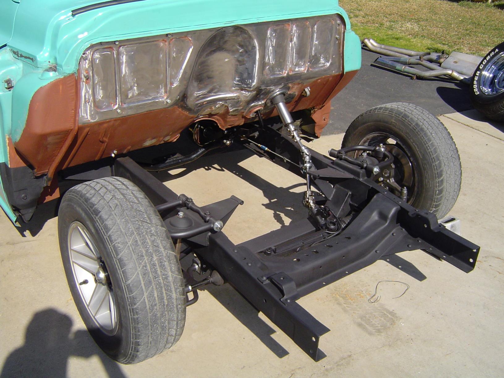

    I would do MII, rides nice, easy to install, front sheet metal fits back on easy.. just my 2 cents..
      249 KB
      188
      248.6 KB
      208
