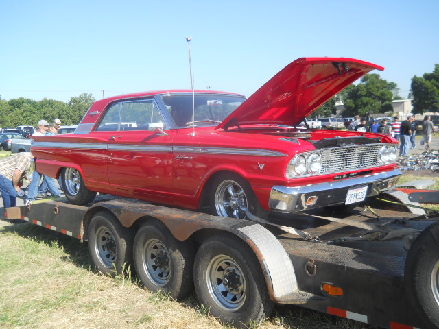

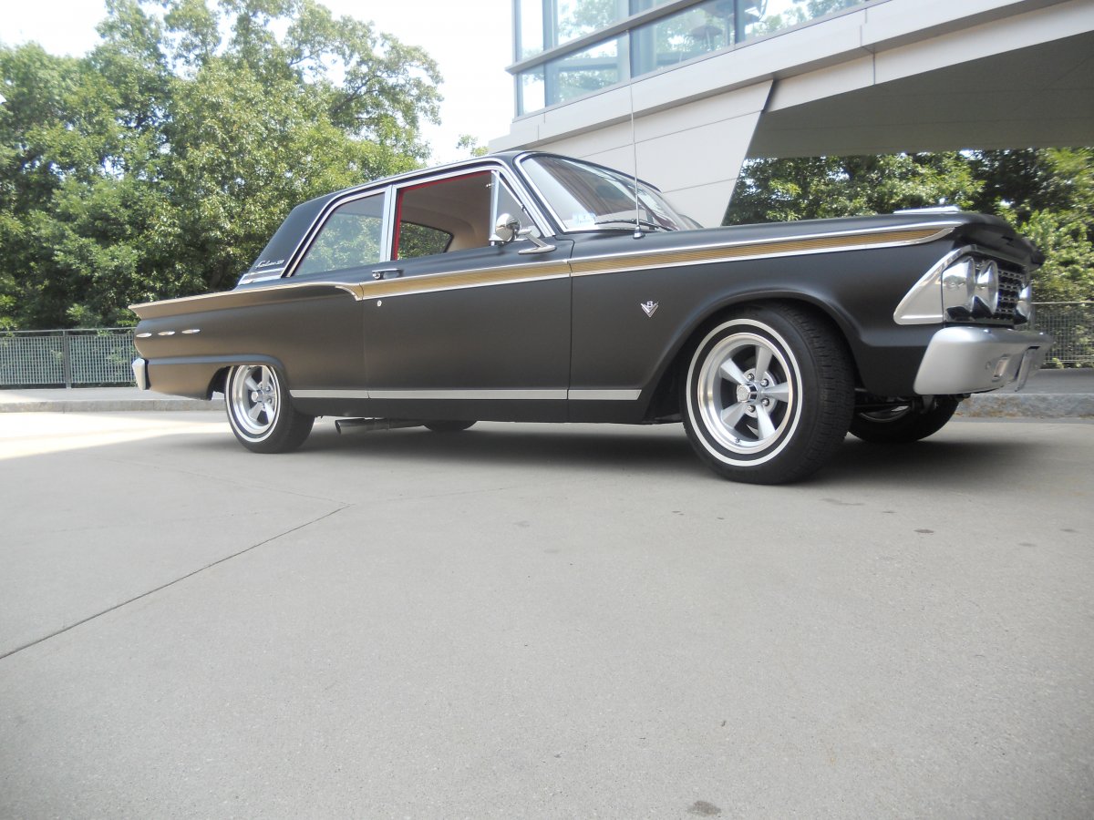

  29. FrankenRodz
    Joined: Dec 20, 2007
    Posts: 892
    FrankenRodz
    You better do some serious suspension upgrades before going nuts on a crazy motor, or she'll be wrapping it around a tree!
    I opted for a modest 289 with 245hp/295torque, with stock suspension, and my Fairlane is adequate for cruising.
    I can think of dozens of other rides I'd hop-up before going nuts on the '63. The big issue is the suspension cannot be upgraded without replacing everything... thousands of dollars.
    There's a Fairlane Forum, and Ford Muscle Forum, where others have already done what you're attempting.
    Learn from their experience. It will save you a lot of headache. DSCN0983.JPG Engine and Interior.JPG
