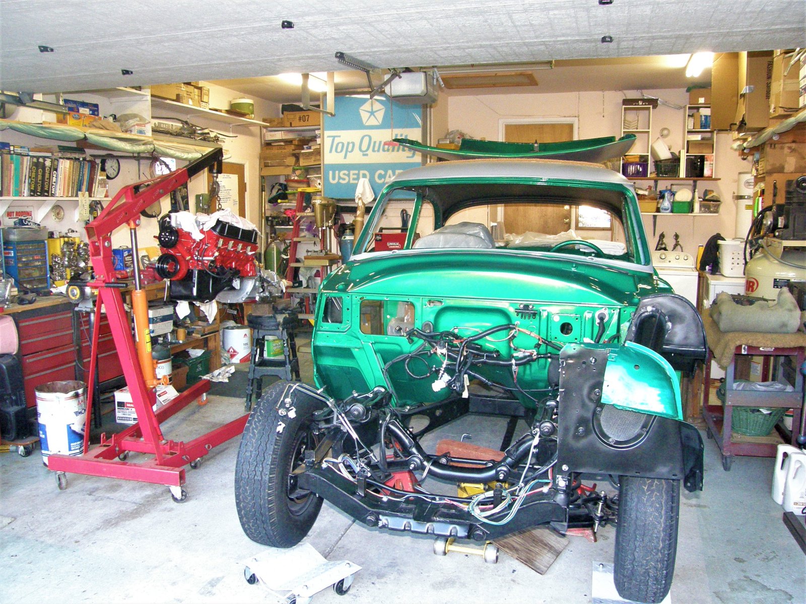

  13. evintho
    Joined: May 28, 2007
    Posts: 2,575
    evintho
    UPDATE:
    Got that little ****er!
    Flushed the motor 3 times with oil and it still didn't come out. Screw it.....out comes the motor! Wasn't too much of a pain 'cause there's no front sheet metal on the car.
    Dropped the pan and there it was sitting in a far corner.......
    That tiny little screw could have caused a lot of damage! Glad I got it. Tomorrow the motor/trans go back in. Moving forward!

    Looking at the current state of ***embly of the car now, I cant believe it took you so long to just pull the damn motor out!!!!
    Literally four bolts and a cherry picker!!!
    49ratfink and bobss396 like this.

    Seeing the lack of sheet metal I would have pulled it , otherwise I would have left it. It's S.O.P. to leave dropped Oil pan driveshafts in small block Fords, I wouldn't have sweated a set screw .
