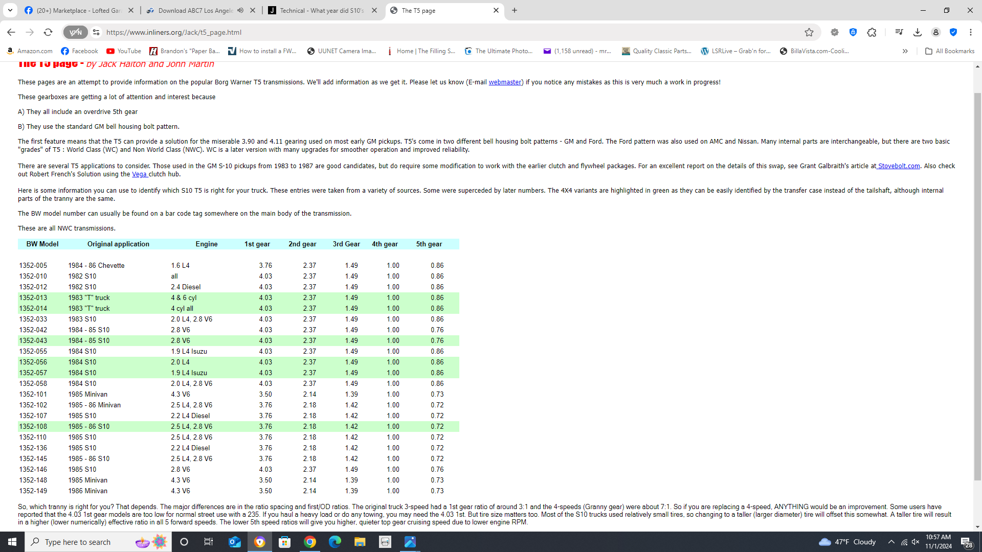

    1989 is the last year that a T5 was offered in a 4WD S-Blazer.
