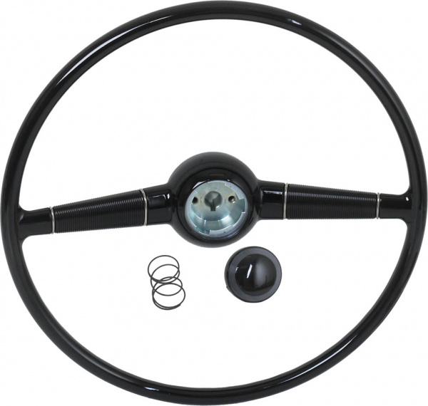

    I would like to put this 40 steering wheel in my Model A. Is taper the same? Or can anyone tell me if any other wheels will fit? Thank you.
  2. The taper on the A is larger. You would need to ream the 40 wheel to fit.
  3. wheeltramp brian
    Joined: Jun 11, 2010
    Posts: 3,220
    wheeltramp brian
    Yup I reamed a later wheel to fit mine
