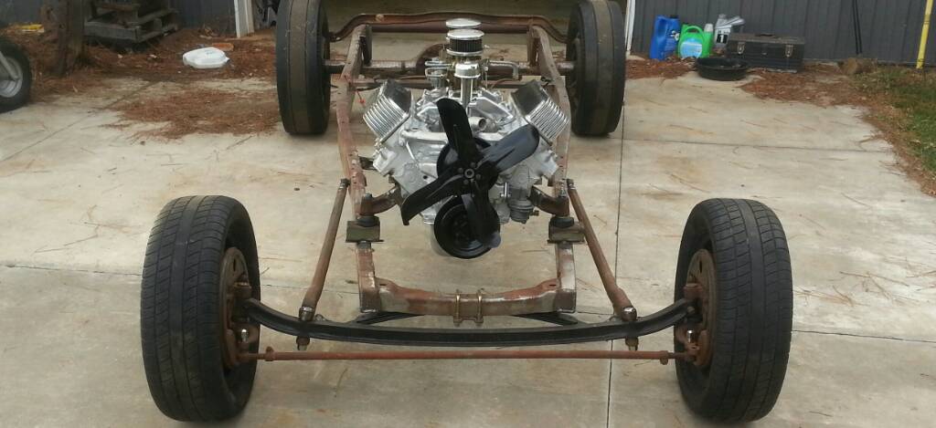

Technical What year suspension is this?

  3. Nailhead Jason
    Joined: Sep 18, 2012
    Posts: 4,515
    Nailhead Jason
    Under construction shot. Here it has reversed rear rims. Since changed to 8 inch rear wheels with 10.5 inch towel city slicks.
  4. Agree, the rear end is '40 car or '40-'41 pickup. The '41-'48 rears have a longer torque tube, along with shorter radius rods that bolt up further back on the torque tube. The earlier rears have longer radius rods that attach closer to the front of the torque tube. The front is '42-'47. If you were closer, I'd like to have that front wishbone/spring hangers/stabilizer/sway bar, but shipping costs would be prohibitive.
