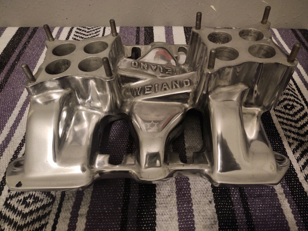

  11. Roothawg
    Joined: Mar 14, 2001
    Posts: 25,993
    Roothawg
    This is the intake in question.

  16. Deuces
    Joined: Nov 3, 2009
    Posts: 26,725
    Deuces
    Almost look like Holley bolt patterns....
  17. jimmy six
    Joined: Mar 21, 2006
    Posts: 17,101
    jimmy six
    They are….. 1954-56 Mercury and 55-56 Ford Holley 4000’s. …

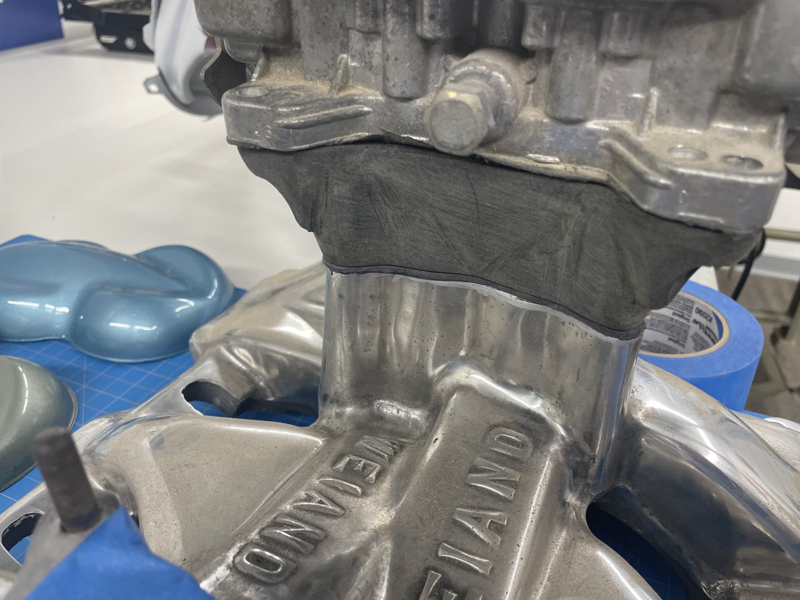

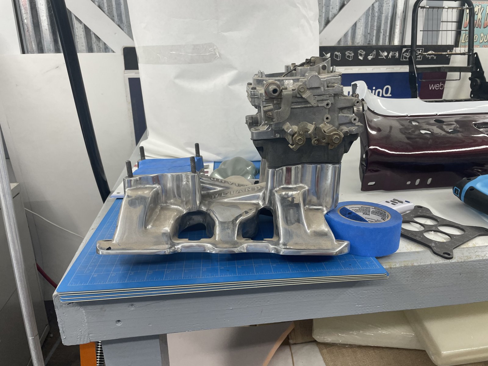

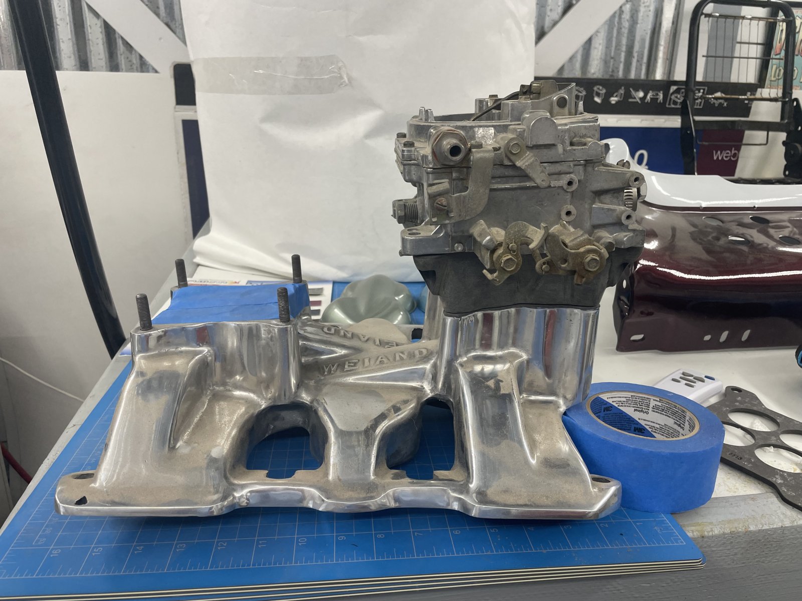

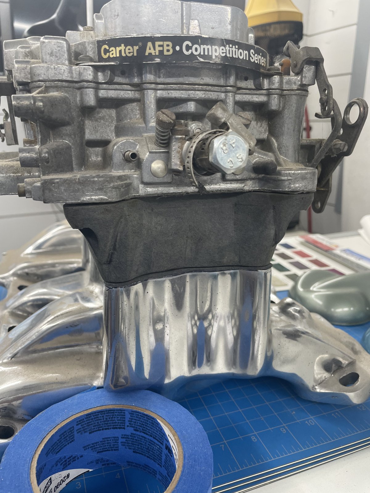

  29. Roothawg
    Posts: 25,993
    Roothawg
  30. Roothawg
    Posts: 25,993
    Roothawg
    So my nephew is technically savvy (which I am not) and he 3D printed me an adapter from the small base carb to the AFB pattern.
    I had a guy on the hamb that was supposed to do it for me but he flaked out and disappeared, along with my gaskets and adapter. He ghosted me so….screw it, you can always trust family.
    I have a question. This is the prototype and it actually fits pretty well. I noticed the Weiand intake has a built in angle to correct for the engine angle. The question is how much is this angle and should I try and compensate for this?
    The idea is to cast this in aluminum eventually and polish it to match the intake.
    A few pics.
