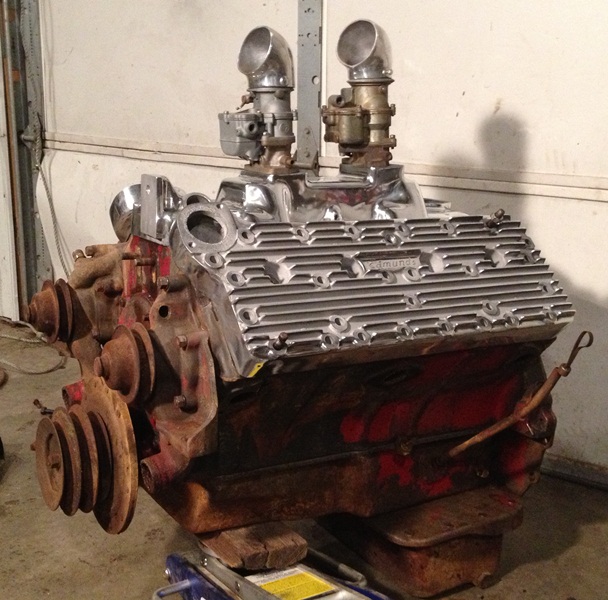

    If you didn't already, and he still has it, I'd say buy that 337, but try to get a better price. If it is ready to run, or even if it needs a hone and some rings plus a valve grind, it won't be too costly. But if the rod and main bearings are shot, and/or an overbore and pistons, the cost is going to go way up.
    I yanked a337 out of a junk 48 Ford F7 to use in a future project. I have heard lots of rumors as to their weight, anywhere from 700 - 1200 pounds. Since my buddys scales where over at my place, I decided to weigh this thing and see for myself just how portly they actually are. I figured it was best to weigh it bare of any accessories, since lots of guys would be adding their own lighter versions of that stuff. The stock flywheel was 47#, the bellhousing was about 50, the 5 speed syncro trans weighed 240, I left all that off as well as the exhaust manifolds, oil filter, dist, carb, fan, generator and starter. It still has the crank pulley and water pumps on it.
    700 pounds even.
    With a set of aluminum heads and an aluminum intake, it dropped to #635.
