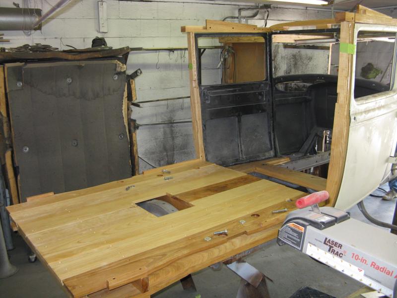

    I WAS LOOKING AT A 1930 FORD SEDAN DELIVERY FOR SALE ON LINE....IT HAD NO FLOOR AT ALL....SOMEONE HAD CUT IT OUT DURING A PREVIOUS BUILD THAT WAS NOT FINISHED.....I WAS JUST CURIOUS....DOES ANYONE KNOW OR HAVE DRAWING OR PIX OF WHAT THE ORIGINAL FLOOR MIGHT HAVE LOOKED LIKE.....IS IT LIKE A REGULAR 2DR SEDAN OR ???????

    I wouldn’t be surprised if the subrails were originally wood.

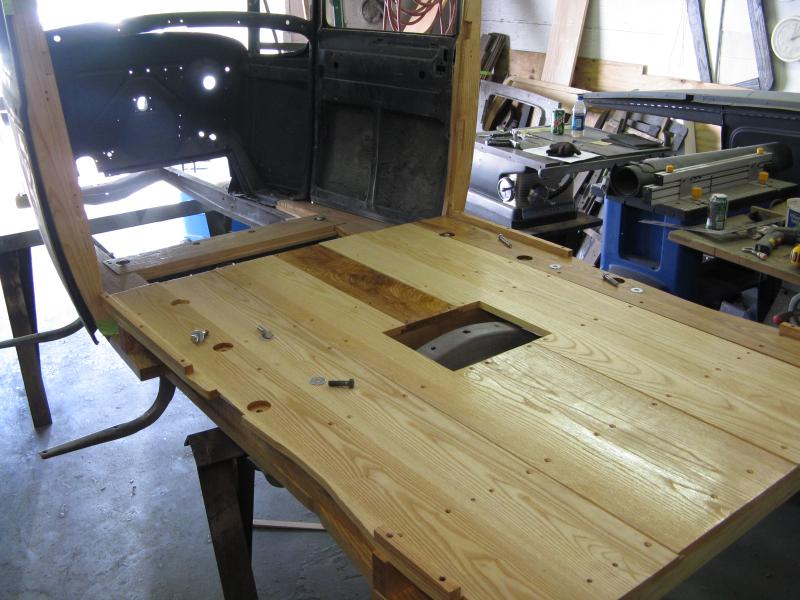

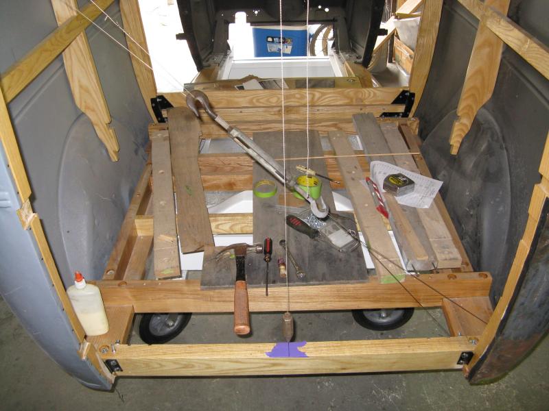

    The correct term for the body style is deluxe delivery. That should help when you search for details, there was a sedan delivery, but it's a different style and floor. Here are more pictures of a deluxe delivery floor.

    The deluxe delivery body is longer than the Tudor, as shown looks like they had wood floors and subrails.

    It looks like the kits are made, not cheap for everything. I have no idea if they're in stock though, that could be a whole other issue!
    https://modelastore.com/wood-kits?product_id=5884&limit=100
    https://modelastore.com/wood-kits?limit=100
    There were also panel deliveries made in 30-31. The drop floor delivery is the same style as the deluxe, just with a "step area" in the rear door area. It has an extended metal panel/valence below the door, and some different wood in the door area. Drop floors are rare, and yours isn't one based on your picture.
