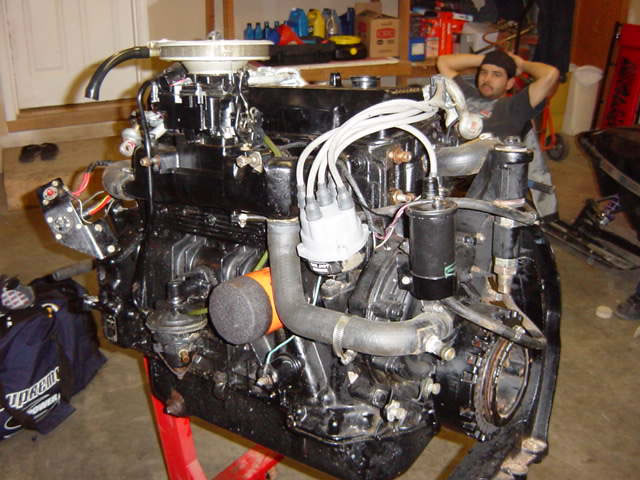

    Earlier in this thread I suggested the 3.7 liter Mercruiser 470 boat engine.
    I will again make that suggestion as many of the suggestions include small displacement engines that have to turn some rpms and generate less than 200 hp.
    The Mercruiser 470 has 3.7 liters, Thats 224 cu/in for those of you who are too lazy to convert liters to cu/in.
    The engine is a proprietary design of Mercury Marine for their inboard outdrive Mercruiser line.
    They were manufactured from about 1977 to 1989.
    The bare aluminum block weighs 75 lbs. Fully dressed the engine weighs about 350 lbs.
    In order to run this engine in a light weight street rod it is advisable to change the cast Iron 460 Ford BB head for an aftermarket 460 aluminum head.
    The water pump and alternator are also problematic on the boat engine but can be converted to a more practicle instalation for a car.
    The basic engine came in several hp. configurations from early 165 hp to 190 hp QuadraJet 4 barrel versions.
    I start with the 4 barrel version and add the performance aluminum heads with bigger valves and better flow.
    After a few other modifications I end up with a 225-230 hp engine that produces about 275 ft/lb of torque.
    The bellhousing pattern is vertually a Chevrolet pattern, except for 1 missing bolt. There are plenty of holes that line up anyway.
    These engines are real torquers that put out power similar to a older small block V8s but they weigh several hundred pounds less.
    While they do not look like an Offy they do dress up like an early engine with a minimum of plumbing.
    I will paint my engines early ford green and install a PowerGen alternator that looks like a generator.
    There are many 4 cylinder engines that are more exotic than the 470 but there are few that will provide the torque and hp that these engines will even when run on regular grade gas.
    The QuadraJet has very small primaries and if these engines are driven with a light foot using low speed torque and 5 speeds they should get good miliage.
    In boats people who knew what to expect for miliage in a boat have attested to the relative good miliage that they produced in that capacity.
    The neat thing about them is that they will provide miliage when needed and still produce bodacious power when the 750 cu/ft QuadraJet opens up.
    Lets see the 470 is very light, and it can look like a tractor engine.
    It can get fairly good miliage, it will produce a lot of when you push on the Go pedal.
    And it used 460 Ford pistons and CJ Truck rods making it reliable..
    What else is there to desire except the performance look.
    I kind of like Stealth myself and enjoy a sleeper.
    Think of the fun when you surprise your Flathead friends with this 4 cylinder pushrod engine.
    See a Ford Motorsport flier, the boat engine and a picture of someone elses stripped down engine in a car below.

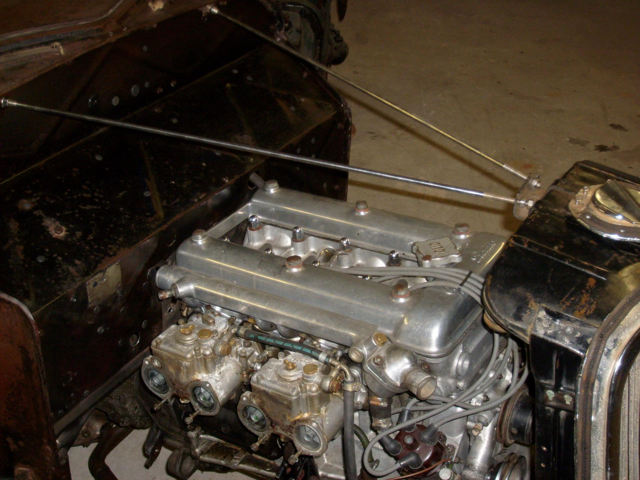

    Mine is not a 2 litre but a 1600 from a Giulia GT 1965, 106bhp.
    I am currently building a lake header for it and in my opinion it looks great in the old Ford.

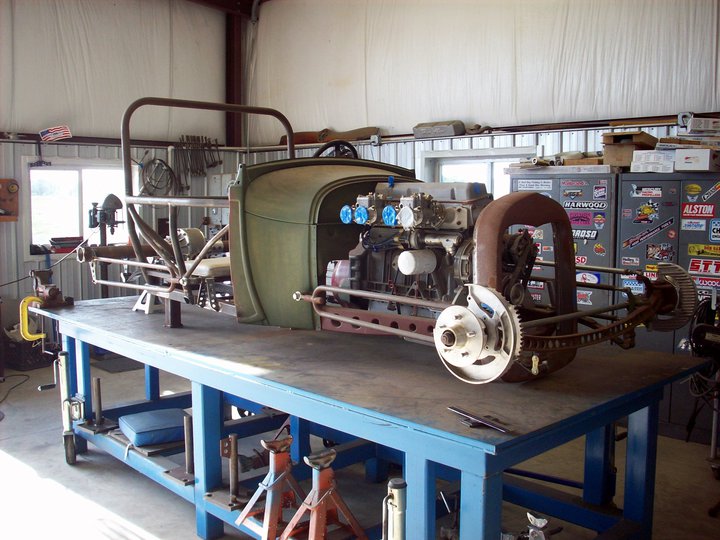

    Beef, what was the donor car / year of your Ecotec? Thanx, Gary
  27. howismydriving
    Joined: Apr 3, 2007
    Posts: 10
    howismydriving
    from Wisconsin
    The AMC 2.5 that was in millions of Jeeps is quite a nice engine. There are tons of performance parts and had a 5 speed before it. I have seen them go with trans for 2-300 dollars. Clifford Performance has a nice selection of parts.
  28. Beef Stew
    Joined: Oct 9, 2008
    Posts: 1,253
    Beef Stew
    from So Cal
    The particular engine in the picture was produced from 2000-2007 and it can be found in they Chevy Cavalier, Chevy Cobalt, Chevy HHR, Olds Alero, Pontiac Grand Am, Pontiac Sunfire, Saturn L-cars, Saturn Ion, and Saturn Vue. Mine came out of a Saturn.
    The ****** is out of a Chevy Colorado pickup and the bellhousing is from a Pontiac Solstice.
