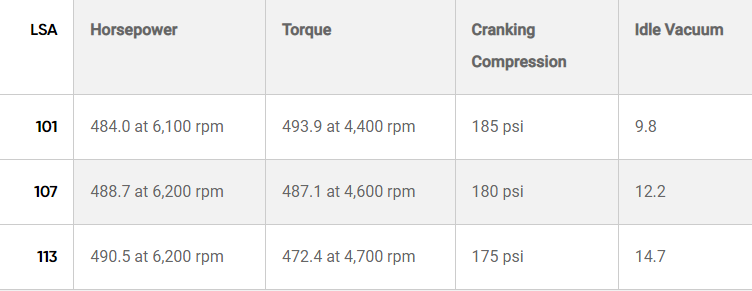

    Below is a Cam "shootout" with 3 cams of the same lift and duration but varying lobe separations.
    The tighter cam put out slightly less Hp, but at lower rpm ,and had higher Torque and Higher cylinder pressure. [but less vacuum]
    Note: the slightly less Hp comes from the Torque x RPM equation [lower RPM]
    https://www.motortrend.com/how-to/camshaft-shootout-lobe-separation-angle-tested-explained/

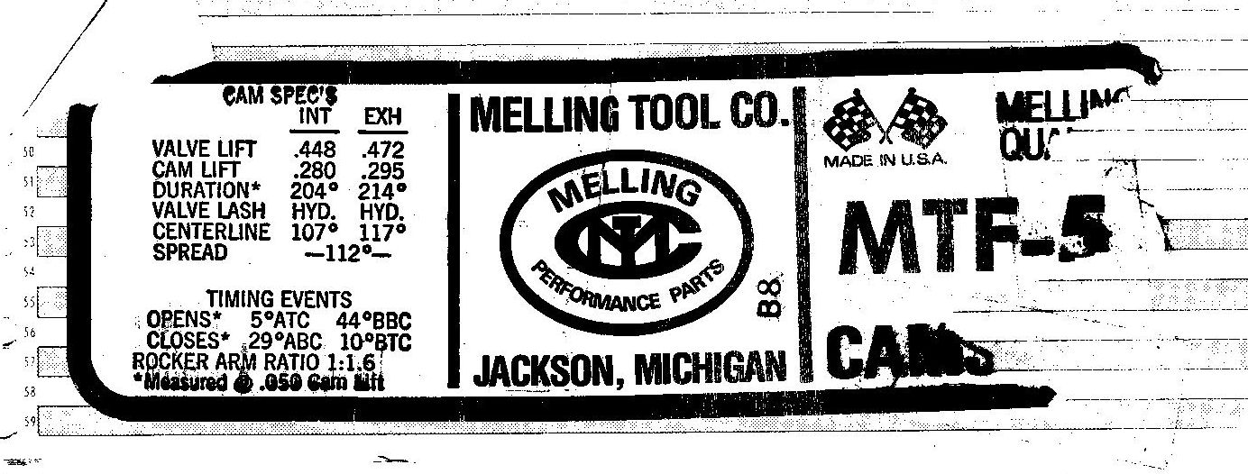

  15. Here's the spec card from the MTF-5 cam I installed years ago; LSA is 112 on it too. Not sure if they've changed since then, or there's a typo above. mellings mtf-5.jpg

    @Algoma56 card shows the CL at 107, but LSA at 112.

  24. I think Summit/Jeg's made a mistake on their info transposition. Here's the description for Mellings themselves.
    I am running mine with a C4 and 3.00 gears in the 47 Club coupe.
