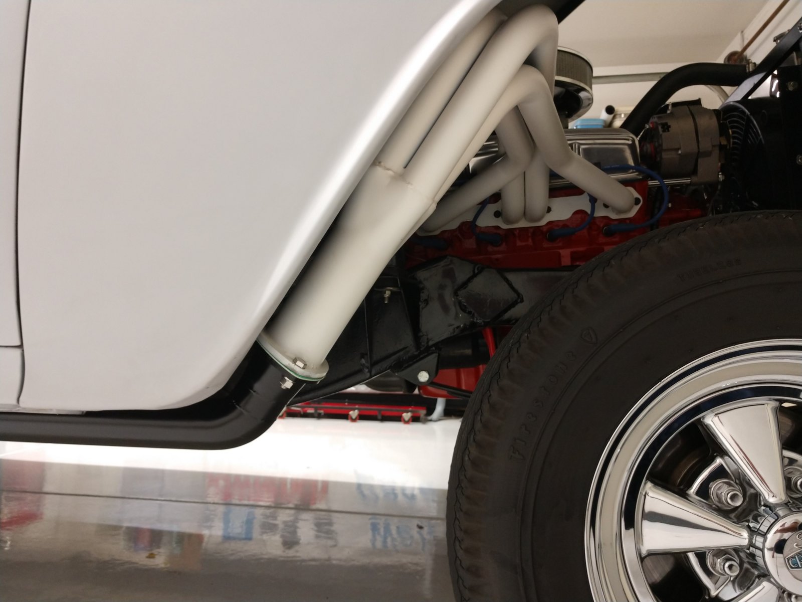

    header shot.jpg Best for the buck..... Hookers
  29. Hosscat
    Joined: Apr 24, 2024
    Posts: 2
    Hosscat
    Which model Hookers are those and what was your process of getting them white? I have a 55 belair. I like how yours hugs the fender. I seem some that are too close to the tires.
  30. SmokinBill
    Joined: Sep 18, 2009
    Posts: 864
    SmokinBill
    These are 2102HKR, The hooker Big block fenderwell headers come real close to the tires with A-Arm front suspension
