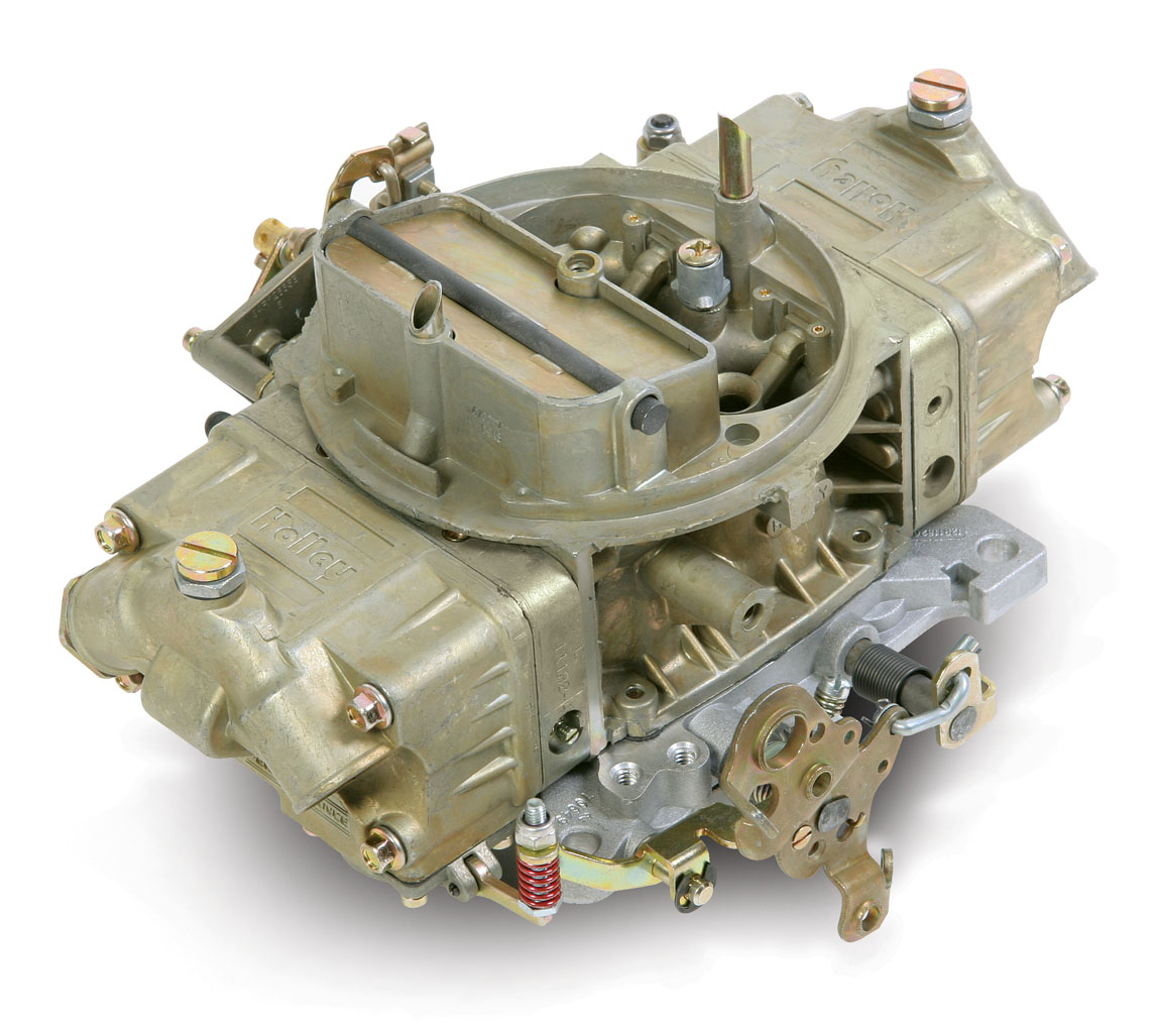

  16. Change your mind fast!!!!!!!! Try an 800 DP on that engine of yours, you have gears and you have a stall, don't pusy foot and go the show car shiney POS Edelbrocks!!! Real men run Holleys,******s run Edelbrocks! LOL!!
    Look at what my car does with an 800 DP. Jetting is stock, and heads are stock. The 800 DP is a match for what you have! Your gears and stall equal DOUBLE PUMPER!!!!!! Thank me after you buy one!
