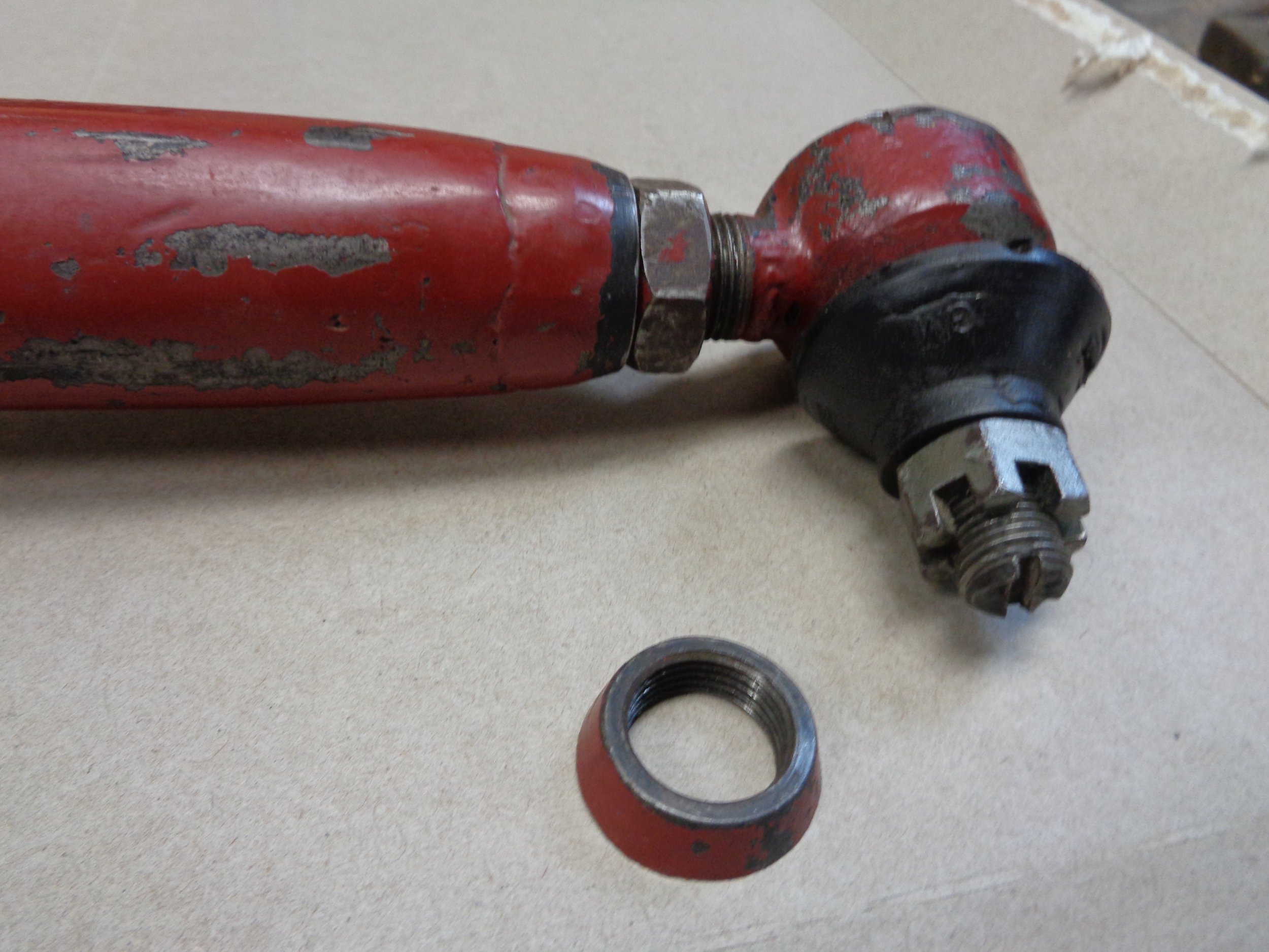

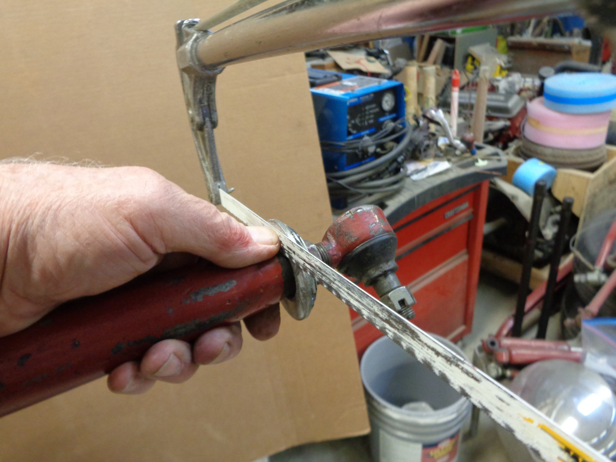

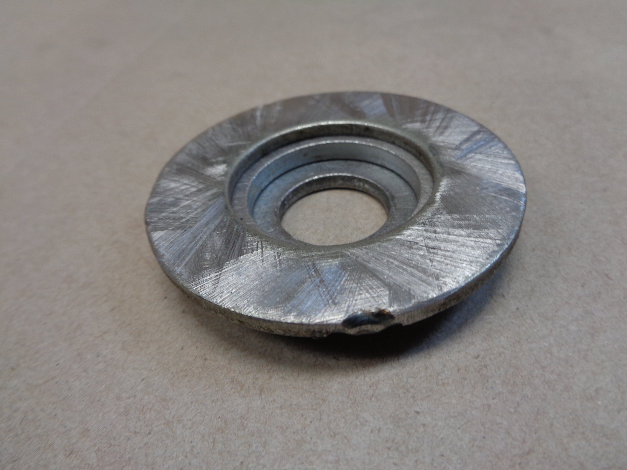

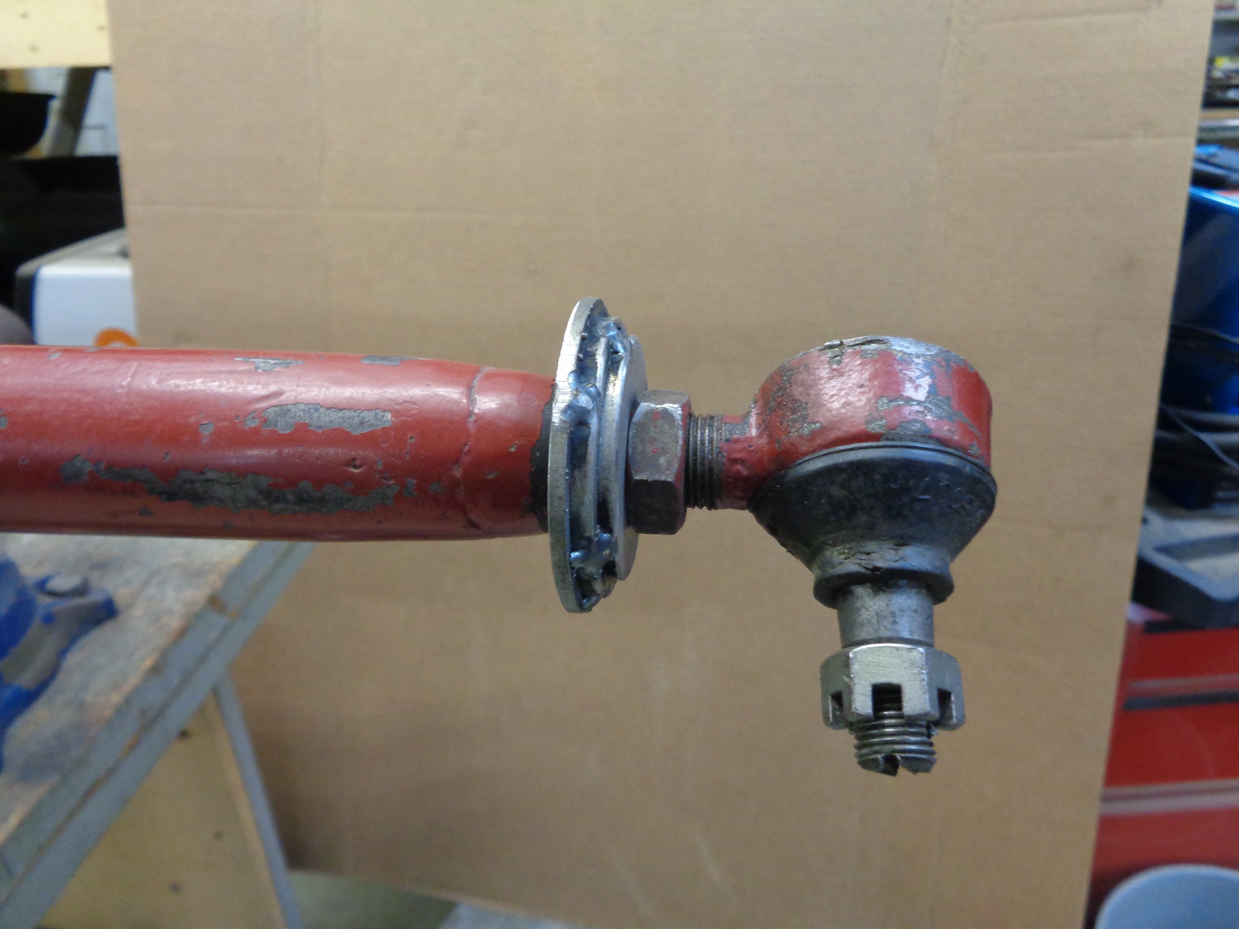

  20. X-cpe
    Joined: Mar 9, 2018
    Posts: 2,267
    X-cpe
    Jig I made to shorten my radius rods
    Tacked some washers together. Smoothed and made parallel on a piece of Stickit paper stuck on a smooth surface.
    Set up to be cut
    Cutting
    Finished product.
    ALLDONE and teach'm like this.

    worked on it some more this eve...my rack has the alignment lift... but the plates are at the shop.. got it closer... but need a tap and die so the end can thread in farther.. it probley was fine as is , but I know it's not right so I'm gonna fix it... lifting the wheels off the rack was a huge help..
  22. ALLDONE
    Joined: May 16, 2023
    Posts: 3,812
    ALLDONE
    thanks... thats probley the fix I need... I still have threads showing as in your pic,.. but as it is now the pipe end runs out of threads , or its rusted up in side the pipe... so I need to tap it and all my 1/2 and bigger taps are at the shop...so tomorrow I get after it again... most likely use your idea to short'n them up....thanks again...
  23. ALLDONE
    Posts: 3,812
    ALLDONE
    question???? did you just score it all the way around.... then remove the end and cut it the rest of the way through??? last night I was thinking that..... other wise it would mess up the threads on the (what ever you wanna call the rod end)
  24. X-cpe
    Joined: Mar 9, 2018
    Posts: 2,267
    X-cpe
    On mine it was the plug welds on the sides that got into the threads.
    Yes, cut all the way around as deep as I dared, then pulled the rod end and finished.
    ALLDONE likes this.
