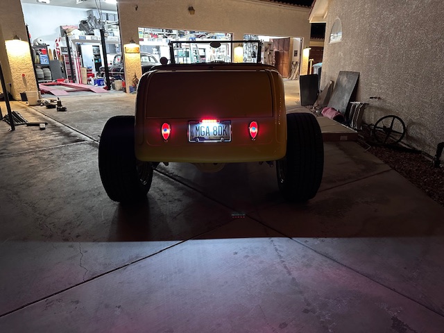

  7. ALLDONE
    Joined: May 16, 2023
    Posts: 3,938
    ALLDONE

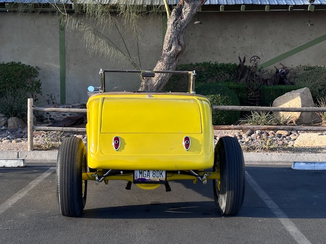

    well still working at it, got the plate and light moved up IMG_4497.jpg IMG_4496.jpg
    dwollam likes this.

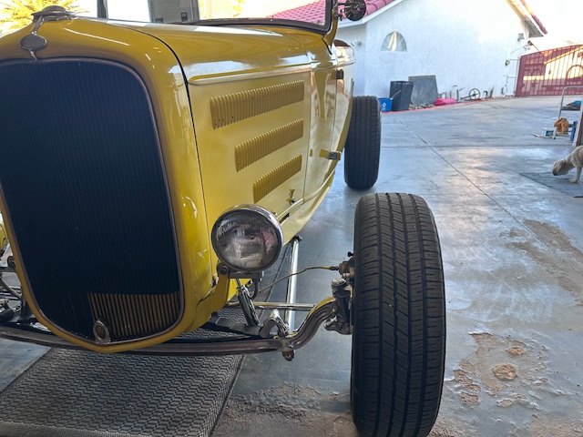

    put chrome shocks, tie rod and drag link... new chrome mirrors
  9. ALLDONE
    Posts: 3,938
    ALLDONE
    moved the shock and light mount forward 4''... new valve covers and air cleaner

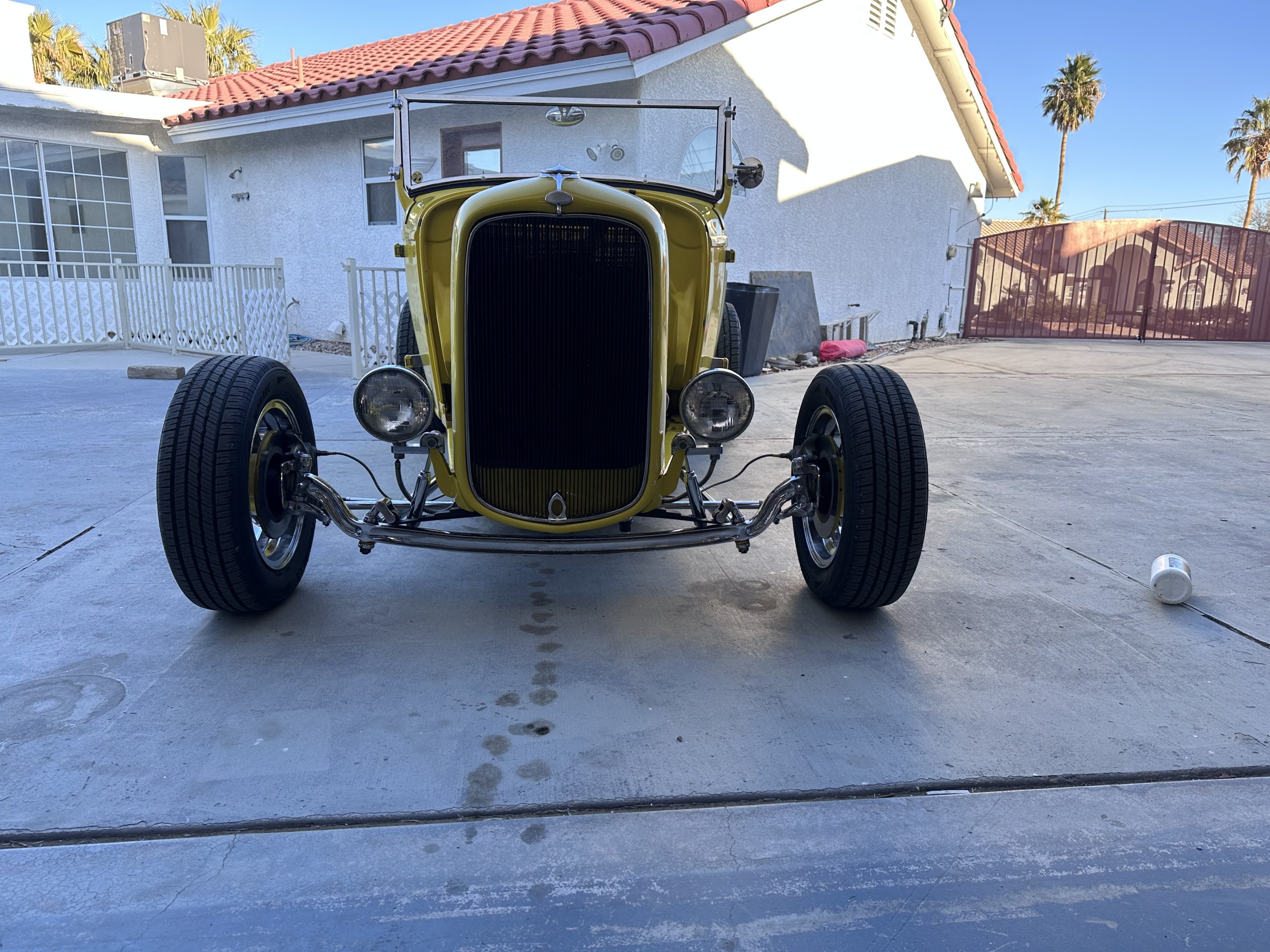

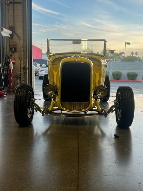

    still plugging away a this roadster.. I think it's getting better.... went with bigger tires on the rear,... and got different off set rims.... so now the tires are closer to the body.. and went with taller tires... it kinda is what it is, and it works...also put the bigger head lights so real happy with the look... that and its a treat to drive now...

    coker tires....
    first try...
    done...

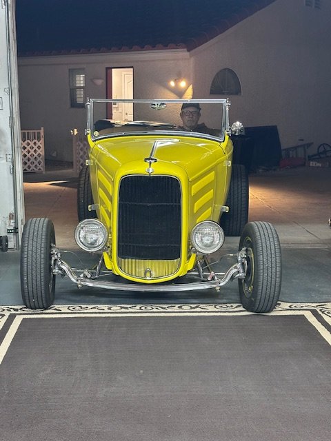

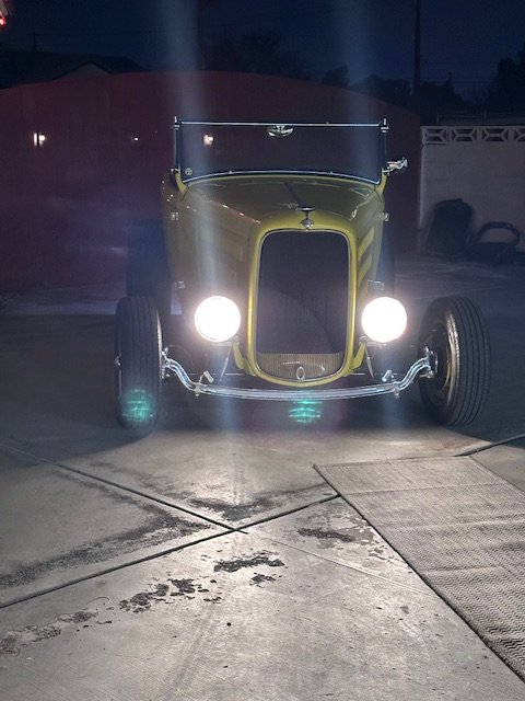

    little head lights VS big head lights..

    the 60'' wide rear was killing me.... that pic is with 7'' wide rims....
