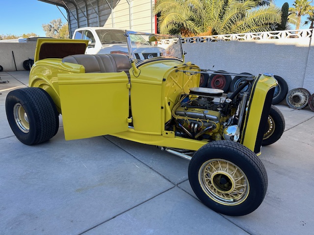

Hot Rods whats going on with the front frame on this car???

    The photo is pretty low resolution and doesn't blow up good but the bobbed frame horns came out pretty slick in my book.
    I doubt the wheels are a bargaining point with a flipper but if you don't like them that is a bargaining point and not a deal breaker.
    The interior looks like it was built for someone 5'8' and 140 lbs and the upholstery is the only thing that is a real turn off to me on that car. Still you have to know what is under/around the seat to allow you to make changes and then consider what those changes will cost. Just as with the wheels and maybe more so because you can sell wheels you don't like or stick them on something you plan to sell changing the interior is an added cost. Screenshot (1684).png

    Based on the tag on the windshield it’s an insurance auction. A front end can slide like that for lots of reasons the simplest would be it broke a leaf and the pieces fell out allowing the tie bolt to come out of the hole in the cross member now that the u bolts aren’t tight and slide over.

    One of the rear wheels is bent too. I’m guessing the car got hit or knocked a curb.

    I was looking for the wheel lol. Bet it got hit in the back wheel and it swung around and tapped the front hard enough to jostle it but not hard enough to be super obvious where contact was on the front end

    I recall having a 32 ch***is on stands & over time began partially ***embling a body from pieces & cast-off parts when the frame did a 90-degree flip on the unsecured center spring mounts, while the key fasteners were lacking it makes one wonder how the early traverse springers did so well on the dirt tracks.

    slid into a curb.... but didn't flip also bent both rims.. that part is fix'd... but I'm still gonna pull apart... that and maybe tomorrow put it on the rack and have a look under side

    It looks like cross steer with no panhard bar. With a bit of what Fordors said in post 30 possibly in the mix or just loose U bolts or clamp bolts if it has that clamp setup that street rodders tend to like that doesn't use U bolts. I'm thinking that if Alldone is considering buying it he already has a list of things to make the car right before it hits the road and the price is friendly enough to be able to do it.

    Ok, I went out and looked this over better....here's my ***essment... the OG cross member is still there, and a new spring bolt.... there's no damage visable.. I'm thinking that maybe water was in volved and the car spun out and hit the curb.... those sportsman 16.5 wide tires hydro plane bad..... and like said it's a wonder it didn't flip.... and again the reason it didn't was the 33'' wide rubber kept it flat...

    After a hit like that to the front end, I would be real nervous about there being cracks or damage to any of the steering and suspension components and all their mounting points. Was it just patched up to get it offloaded to some unsuspecting schmuck, or has it been fully gone through to make sure it will not be prone to future failure?

    I say it sheared the head off the spring bolt..... for it to do more damage it would have knocked the axel complete off... I think.... I have a lift in my back garage and thats where it's going next... car runs and drives perfect and goes straight... if it would have had a panhard bar it would have ripped the front apart.. when I went to get the car is was that i was gonna blow it apart and rebuild it.... but after driving it.....lotta thinking going on in the old squirrel cage...
