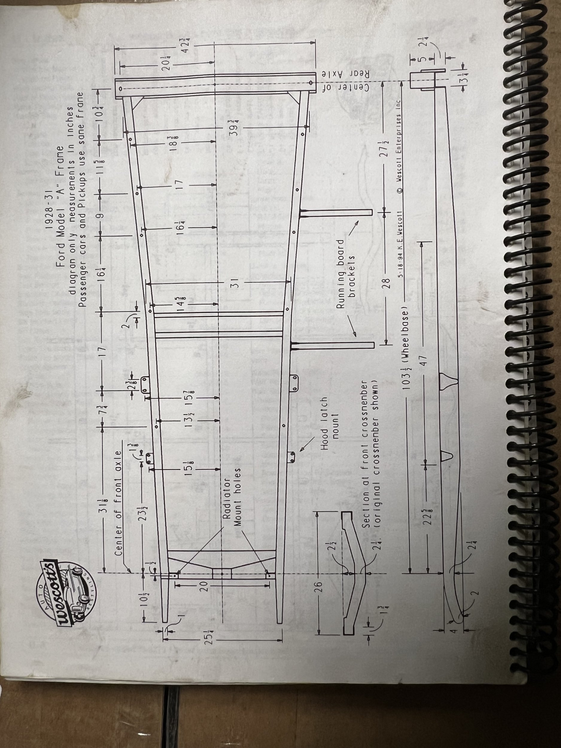

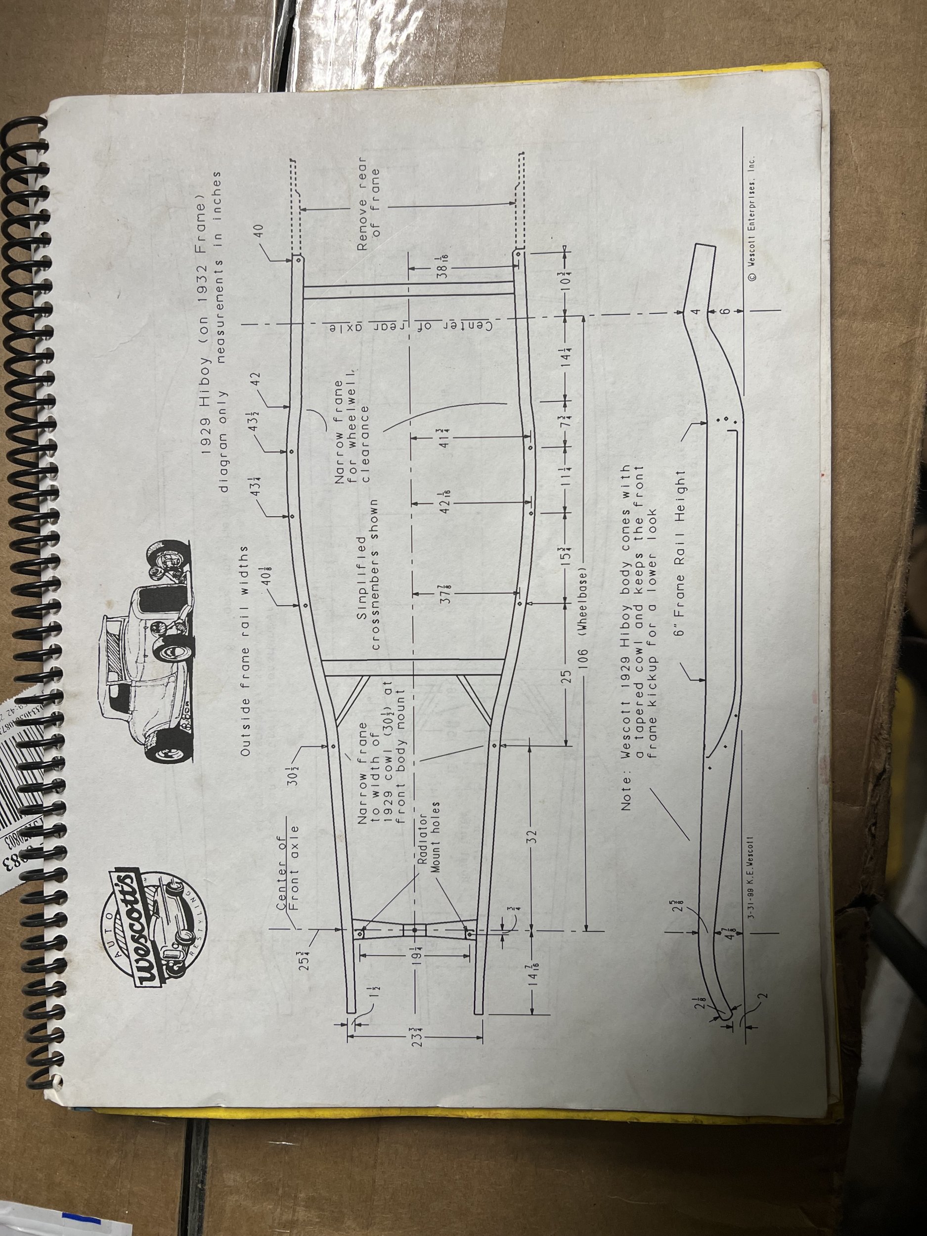

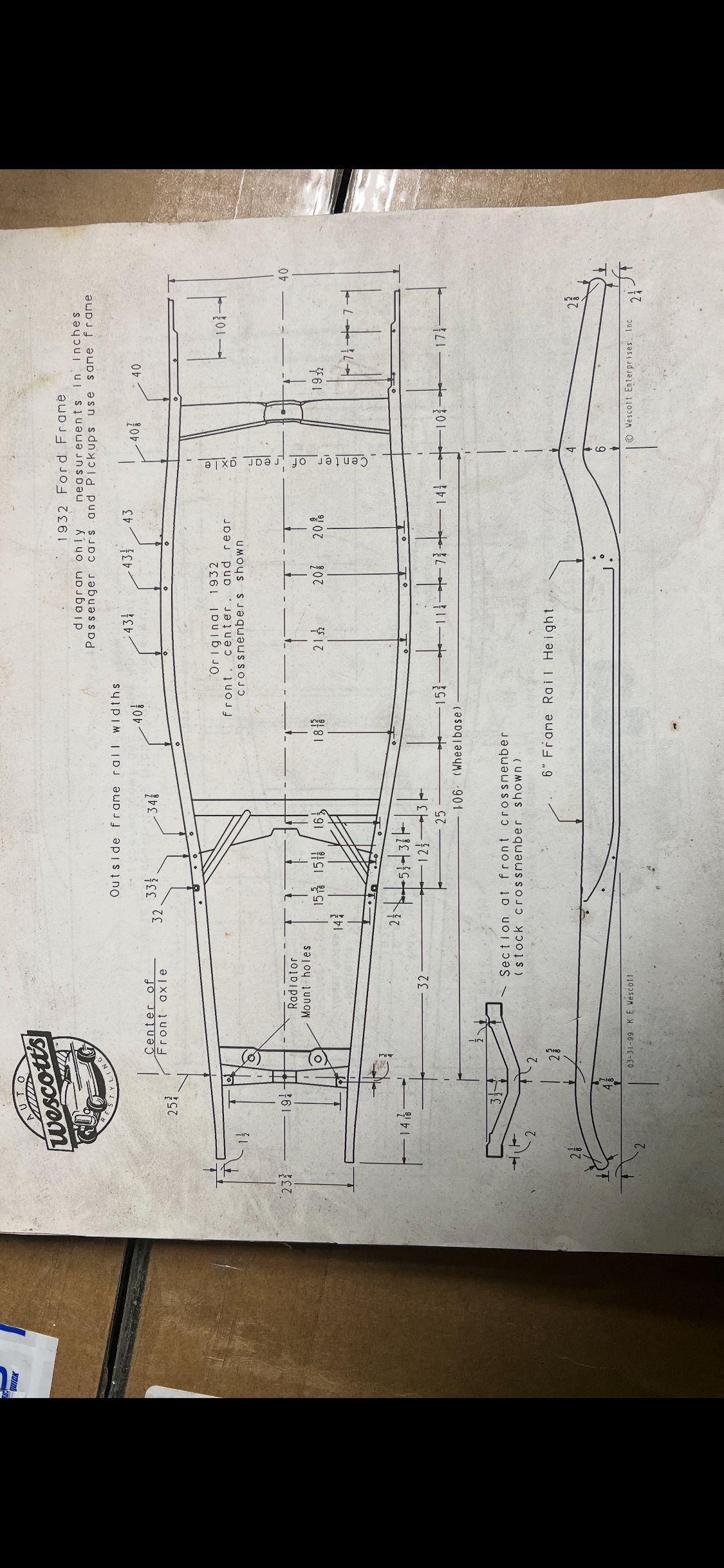

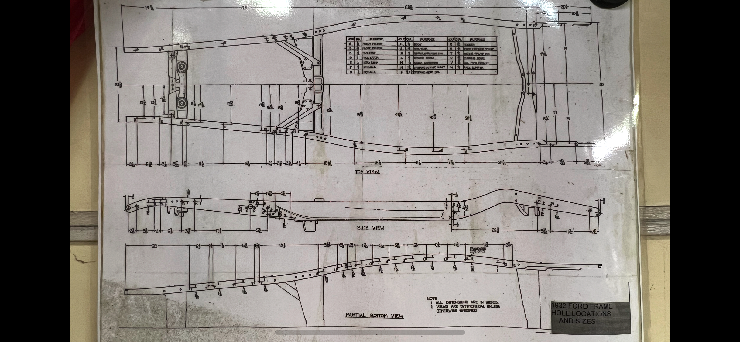

    so what i'm thinking, I could have the body off in a couple hours.... at that time I could address the motor height issue... and any thing else....but....it would take a good *** whippen to get me to put the body back on...and probley end up an A ot T body on the 32 frame...or if lucky a 32 body...... thats why I'm dragging my heels here....
  4. ALLDONE
    Joined: May 16, 2023
    Posts: 3,809
    ALLDONE
    thanks for the post... though it was 40 yrs ago... we built we built T-A and 32 frames at my st rod shop....slowly stuff is coming back to me....we had a flame table pattern cutting old school tools....and patterns for all the tabs and mounts,,,,built 32 frames off just the stamped rails..... we would tack weld the rails to the frame table... then put the crossmembers in...all the pieces were in bins...so kinda automated for the 80's
    I could be way off here.... but this come to mind... when we pinched the cowl area the front would come way in at the front cross member.... so we would porta power it back open to fit the cross member....what I think they did on this frame was just open it up to the size of the 32 grille...not arguing what others think... just what I think.. all I know about this kinda of business is I got rich when I quit doing it...

    Sure looks like the frame is pinched only from the cowl forward to keep the rails even with the hood sides (if it had any). My '29 on '32 rails is pinched to fit the Model A body at the cowl, that's not the case with your car. I'd just put 15" or 16's on it and call it good.
