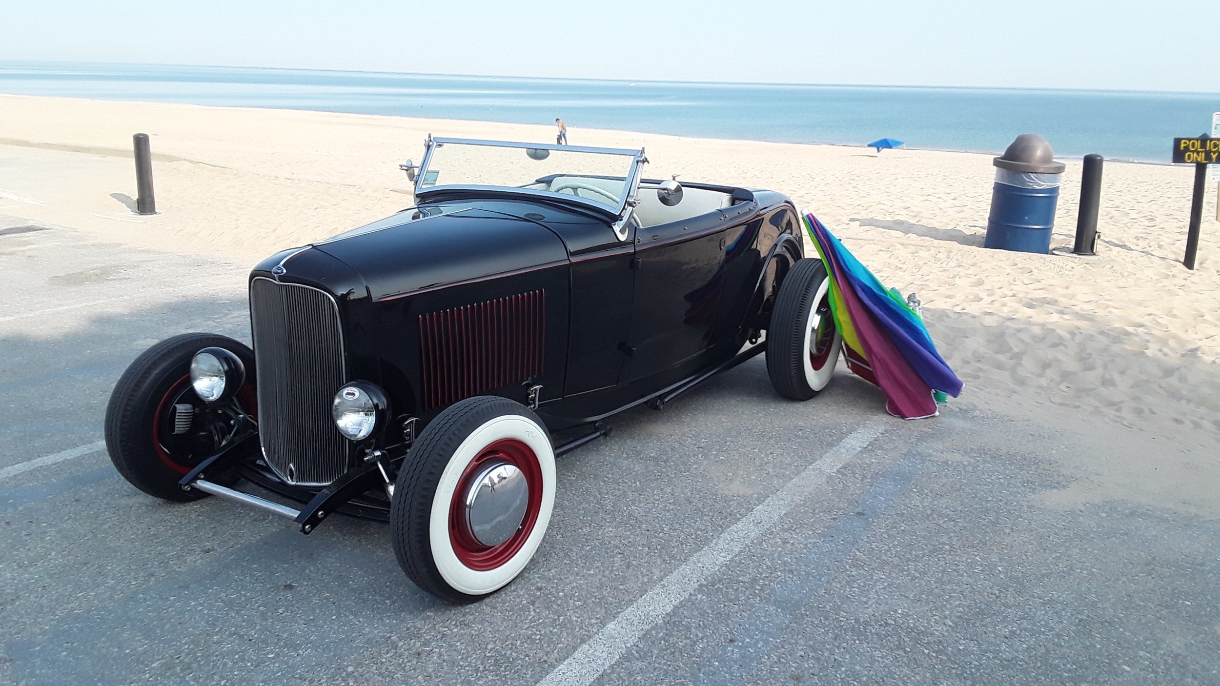

  6. I did. But ya keep posting that super cool crusty32. as an example of what ya wanted.
    so I get confused.
    It’s a parts car so treat it like one.
    Yank it apart, spray it to resemble the crusty 32.
    Toss the chrome steeet rod parts in the swap meet
    4.5 steel wheels are super EZ to find. A can of black spray paint and done
    And enjoy.

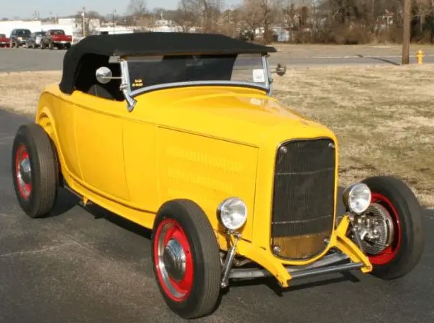

  13. tim troutman
    Joined: Aug 6, 2012
    Posts: 1,299
    tim troutman
    1932-ford-roadster-yellow-1.jpg I like this look not far from your car . looks like your car has had a hood on it in the past
    ALLDONE likes this.

    yes sir, took it off to detail... not sure if I want the whole hood,... or just the top.... thats another lets hear what the crowd has to say

  17. tim troutman
    Joined: Aug 6, 2012
    Posts: 1,299
    tim troutman
    I like the car wish it was in my garage I would put the hood back on. looked back and seen part of the hood with louvers in a photo. change the steering wheel.probably put some wheels and tires like I posted above & get some traditional pin striping on it. I seen you posted that the car is comfortable & runs and drives well.I think I could really enjoy putting some miles on it
    lurker mick likes this.

    the first pic???? the wheels are 15x5 and 15x 7... sure looks like 14's in the front...thats another thing.... this car is a lot better looking standing there looking at it

    any more pics of this car... like a rear shot.... this car is really easy on the eye.. red wheels match the pin stripe, white walls match interior...
    I'm stuck with yellow ,tan, or chrome...
