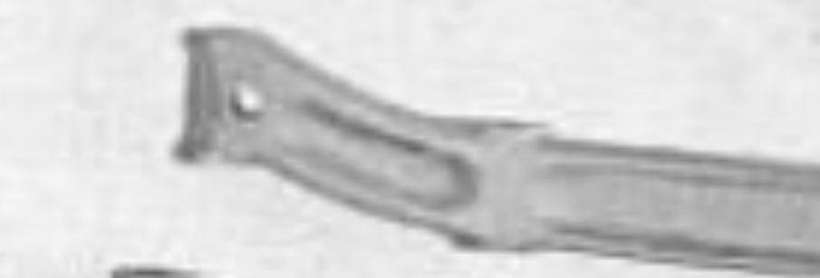

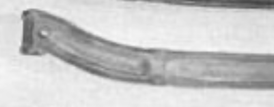

  20. Fordors
    Joined: Sep 22, 2016
    Posts: 6,498
    Fordors
    Correct, they are most commonly called '42-'48 spindles. Also, the king pins are a 1/2" longer so are not a direct interchange with the '37-'41's.
  21. ALLDONE
    Joined: May 16, 2023
    Posts: 3,812
    ALLDONE
    so the axel is also 42-48? aren't they wider???
  22. Fordors
    Posts: 6,498
    Fordors
    From the photos your axle could be Model A through 1936. The height of the spring perch bosses on the axle will be 2 1/4” on an A axle, and 2” on the ‘32-‘36 axles.
    For me the easiest identifier for spotting a ‘37 and later axle is the shorter distance between the spring perch bosses and the king pins.
    Model A-‘36
    ‘37-‘48-
    ALLDONE likes this.

  24. Mart
    Posts: 5,005
    Mart
    I think the car looks a lot better now. To my eye there is just too much yellow. Too much street rod 80s monochrome. I'd lose the yellow on the front steering parts and hubs. Maybe other things like the back axle. The yellow on the engine is also too "look at me" for my taste.
    But in reality you have a pretty nice car that runs and drives and was built to a high standard. It is what it is. Enjoy it.
    Edit: Spindles do look like 42-46 "squareback". Axle looks like a old school dropped 33-36.
    Mart.
    ALLDONE and dwollam like this.
