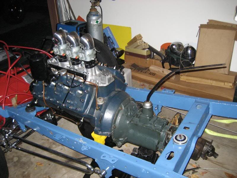

  8. weemark
    Joined: Sep 1, 2002
    Posts: 830
    weemark
    from scotland
    ive got a little more than $4500 in mine, its had lots of machine work, its been ported, balanced, bored etc. 40 over pistons, isky cam, basically everything inside is new, all the bolts etc. are new, new gaskets etc. etc. you get the picture...
    for me it was worth it though as I ended up with this.

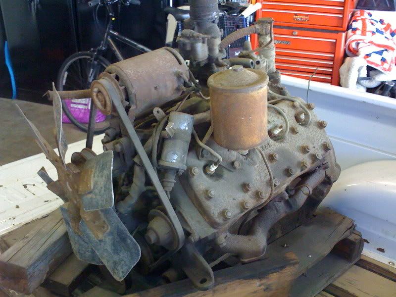

  26. [​IMG]
    have a chance to get this for 200... says its a 34 what do you guys think?
  27. Cad you got a 50/50 shot i got mine blind and scored if it is stuck i am sure you can part out what is salvagable and get the dough back see if he will take less.
  28. ya i didnt think it was going to cost me the whole 200 and between parting out a thing or two maybe scrapin if needed could come out even and get a free flat head. but beings it an earlier one doenst sound like its worth the time.
  29. tubman
    Joined: May 16, 2007
    Posts: 7,940
    tubman
    That has to be a later model flathead (not a '34) because of the water outlets in the center of the head. I can't see clearly, but it looks like at 21 stud engine (late 37 through '38), but my old eyes fail me when I try to blow the picture up. When I looked at it again, it may be a 24 stud, but I just can't be sure. Looks like a '34 truck chassis though (wheels, etc.)
