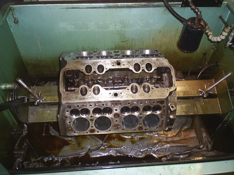

    296 ci 8BA
    It started with a nice crack free 60 over block w johnsons (got lucky at pickNpull) and a good deal on some very nice edelbrock heads and fentons from a fellow socker dad.
    4 1/8 crank
    21 A rods
    3 3/8’’ Ross forged pistons
    Cleveite bearings
    Isky 400 jr
    Isky springs
    New alum. Timing gear
    Indexabal crank gear (three key ways for +4 std -4 )
    Stainless Chevy valves
    New seats
    New guides
    All ARP bolts and studs
    New speedway water pumps
    Merc oil pan (w windage tray)
    Rebuilt og Johnson’s
    Old Mallory duel point (polished)
    Merc timing cover (polished)
    Thickston Pm7 (polished)
    Two Stromberg 48’s (not built yet)
    Repo thickston air filter (fully polished)
    Edelbrock early heads (cnc’ed chambers - domes and fully polished)
    Fenton cast headers
    All machined ( baked and tumbled - bored- honed - decked - balanced)
    smooothed ports
    Iv got about five grand in it at this point.

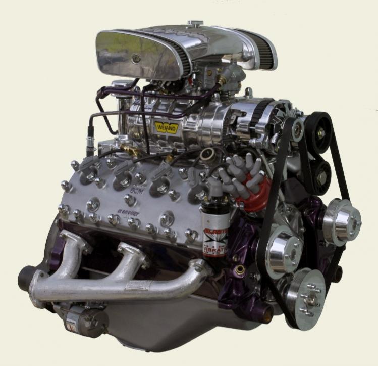

    My 276, ported/relieved, max 1 cam, weind blower. Makes my 40 move very well.

    So Mr Bluto I was just wondering, Why do you need to use my picture of your motor?
