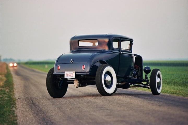

    Joined: Nov 27, 2005
    Posts: 4,397
    Russco
    from Central IL
    Mine was fine, at certain highway speed it had a high pitched whine but not an unpleasant noise, just something you noticed. Didn’t bother me nearly as much as the typical wind noise at highway speeds. It also made it great for when I flat towed the car too, just pull a spur gear off and good to go. Once my wife drove it in a parade I swapped gears around and gave her a 6.70 ish ratio for the parade she loved it, she just let the clutch out and just crept right along at an idle in first gear. 18FBDD18-D11D-4627-A6DA-69AD85886237.jpeg 36F17180-5795-48D2-BAC5-7CDEE4785EF8.jpeg
    Tim, winduptoy, Tman and 8 others like this.
