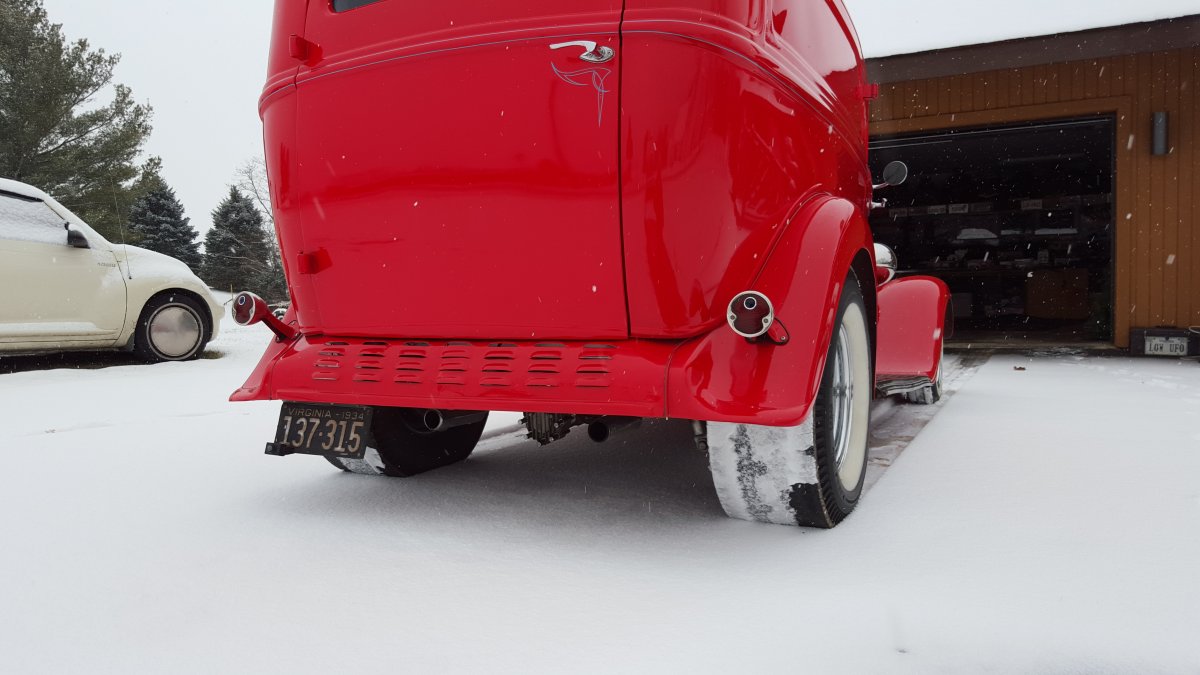

    34QCmaint.jpg I have a Winters Champ style under my 34. I use 3 different sets of straight-cut spur gears. 4.51s for drag racing. 2.71s for trips and 3.54s for all around driving. I drove from Omaha to Joplin with the 2.71s, swapped to the 4.61s to run the car at MoKan and switched back to 2.71's to drive home. Then swapped the 3.54's in to drive around the Omaha area.
    I invested in a little cheapo plastic hand pump but I'm considering going to an electric pump. Any way ya do it, it's messy! The whine reminds me I'm not that guy driving a Hyundai or a Toyota down the interstate... 34QCmaint.jpg

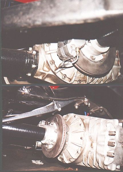

    I have a Spidaro-Winters V8 Q/C in my roadster. After about 15k miles I got tired of the whine
    and switched to the helical gears, with the Winters supplied shim kit.
    It's been totally quiet, similar to the 9" I had in a previous PU. DSC08750-001.JPG

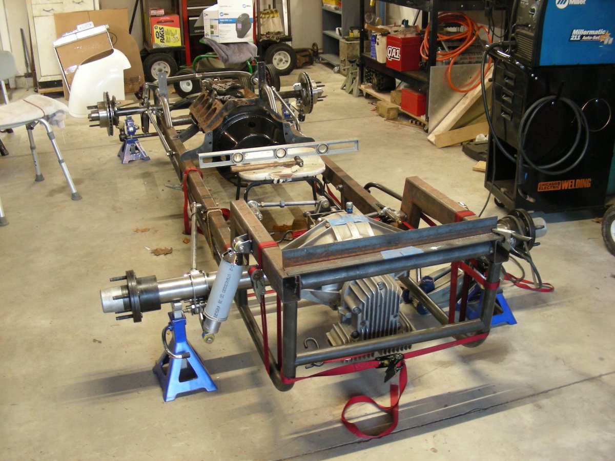

    Never ran one on the street, raced with them (Frankland and Winters HD champ style) on the dirt tracks up here in the NE. My project the "Whatever" is goingto have a Winters champ QC with grand national hubs and floater axles. DSCN1054.JPG I have about $500 in it so far for new axles, axle tubes, and wheel studs. Will be using straight cut gears. Hey I'm 1/2 deaf from the racing days, so I probably won't notice...
