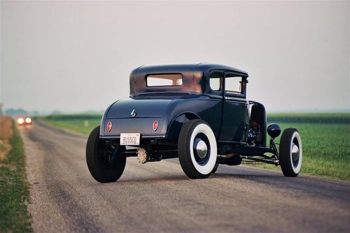

    I’m curious, did you try any other gear sets?I had the exact same set up and mine had a little noise, but nothing even close to like a gear drive in a motor. I had 3 sets of gears at the time all were about the same. You actually had to kind of listen for it to notice it. At highway speeds it was definitely there though,, a very high-pitched whine but not very loud. It was barely audible over the wind noise.

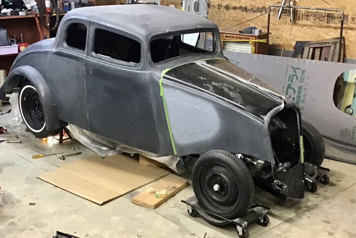

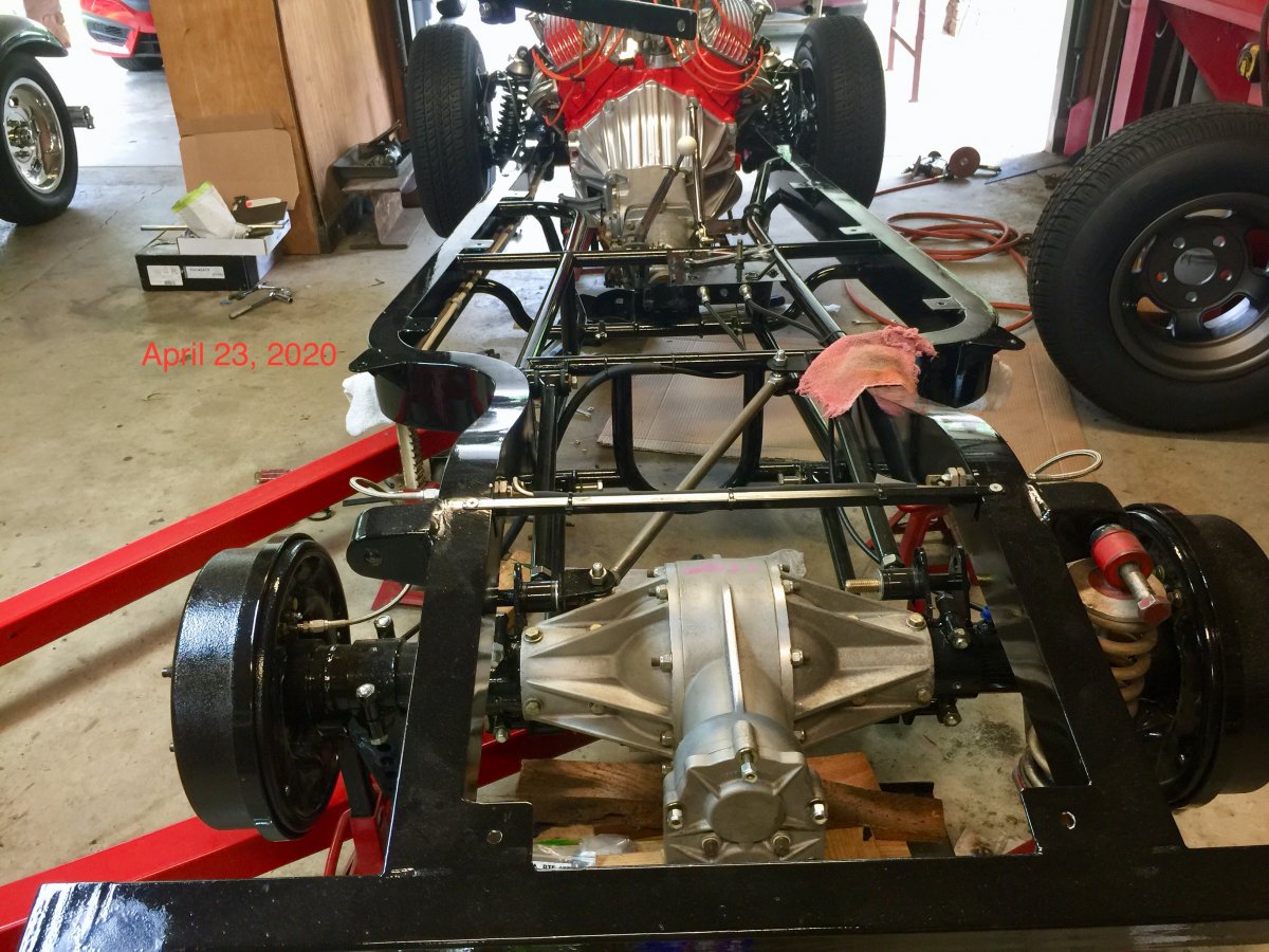

  5. Danny , I put a Speedway Engineering Mini-Stock with 3:66 gears in my 33 Willys project.
    I will let you know about the noise when it hits the street. I think with the cammed up 327 &
    loud pipes, it will sound just right. Jerry Drye from N.C. 95DAD8F3-5684-44B8-8D64-77C63C2413E4_1_201_a.jpeg C601FE1E-257D-4A02-B36A-09176CB8CD1E_1_201_a.jpeg
