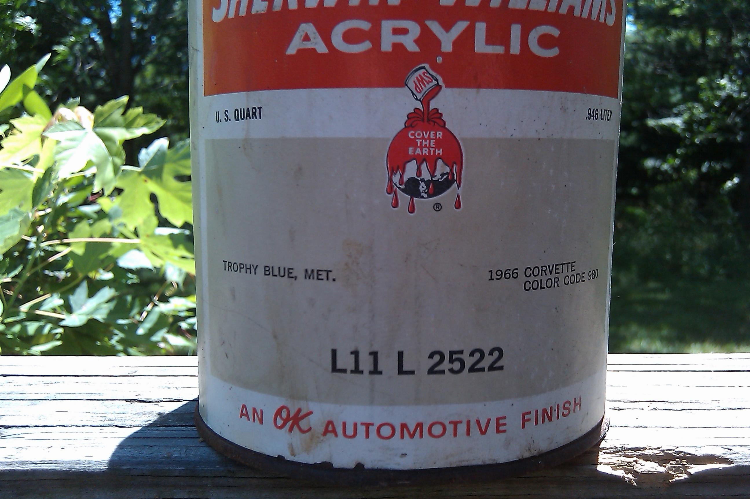

    Came across a stash of old factory paint colors,,is this stuff worth anything ? Planned to keep some for motorcycles,,but not all of it. Mostly 60's Chevy Mopar and some Ford

    shoot a test panel and stick in the sun for a few days. then come back and slice it with a razor blade and in a grid pattern and cut down deep to primer. then put duct tape and rub it on hard and or let it sit for awhile and try and rip off the paint. if it wont hold then the adhesion is questionable. if it sticks. well then give it a shot.

    I assume you have worked in the paint industry since that is a standard test for paint adhesion in the auto mfg. industry. I sure hated repairing those adhesion tests on units that passed, since they were cut so deep and QA usually always did the test on the quarter panels.
    I am now retired from the auto paint industry. I started painting in the late sixties and I accumulated a lot of unopened cans of acrylic lacquer and enamel over the years. From my experience, the lacquers seem to be ok, if they've never been opened. Some of the enamels appear to have separated and have a grainy appearance.
    Even so I don't know if I would risk painting a large project with a questionable material. I don't mind shooting motorcycle parts, shop equipment, refrigerators, etc since a refinish wouldn't be that big of a deal.
    Most of my stock of old paint are factory packs from the mid sixties to the late 70's, some with those catchy names like big bad blue, basin street blue, grabber green, and sassy grass green.
