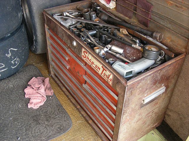

    The Life Span Of A Water Pump Is Based On How Far Away From Your Tool Box You Are...(25) .. 550aab0cef9eb2223cf5177a1d53f460.jpg

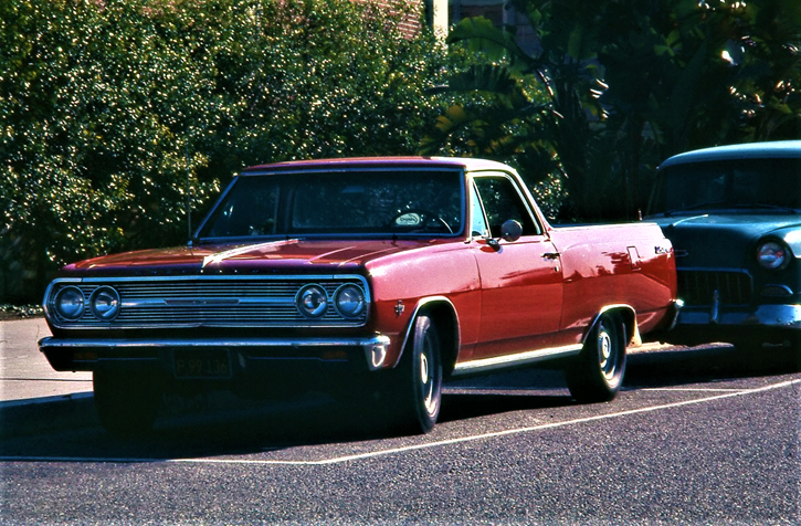

    On the upper end of the scale, our 1965 El Camino had no problems for 120k miles. By the time my wife and I began our talks about selling the El Camino and getting something else, the El Camino may have overheard us talking inside the seating area. Yes, it is funny, but how else can one decide that after all of the road trips, daily drives, rain, snow, dirt, dust, and other crappy things to put the El Camino through, it must have heard us planning for the future.
    The whole pickup bed area was full of snow, the dirt racing motorcycles, then a Harley sportster, furniture, and countless surfboards. It held its own and ran so smoothly that we thought we hit the jackpot as a well made car/truck. It must have been made on a Wednesday at the Fremont, CA plant in the SF Bay Area.
    But, as soon as we moved to a new house, we continued to go over 1000s more miles to the Bay Area, Baja Mexico and to the mountains. Nothing ever happened. As soon as it began to get close to 122k miles, we had the discussion and little noises started to happen. At first, it was ok and we accepted it as just an old guy moving on in road life. (sounds like all of us old guys, today)
    Then by 124k, the noise got so loud that I knew it was coming from the water pump. So, a simple taking apart the front area, and removal/installing the new water pump was simple enough. But, it was on a cold winter night and we needed the car for the next day. So, into the cold night I worked until it was finished. It was not an enclosed garage with a heater, but an open car port with no heater, but several t shirts and a sweatshirt.
    Jnaki
    The job was complete and nothing happened for the rest of the time we owned the El Camino. By 125k, we sold it to a surfer from Dana Point and he was a happy camper. Several times, I would see it cruising around on Coast Highway. Then one day I was in Laguna Beach and saw a light blue El Camino that just had a different feel to the car/truck. It was my old red one painted blue. So, the life of the 125k 1965 El Camino moves on to its next round of living with a new owner.
    Problems with the water heater was at 122k and the El Camino was sold at 125k. There was no rust and the seats were brand new as I took off the clear plastic seat covers for the new owner. He thought it was a brand new car, until he saw the odometer.
    Built in 1964, purchased new, in late 64 as a 1965 model with the different front end and hood.
    12 years of blissful driving and no problem maintenance…
