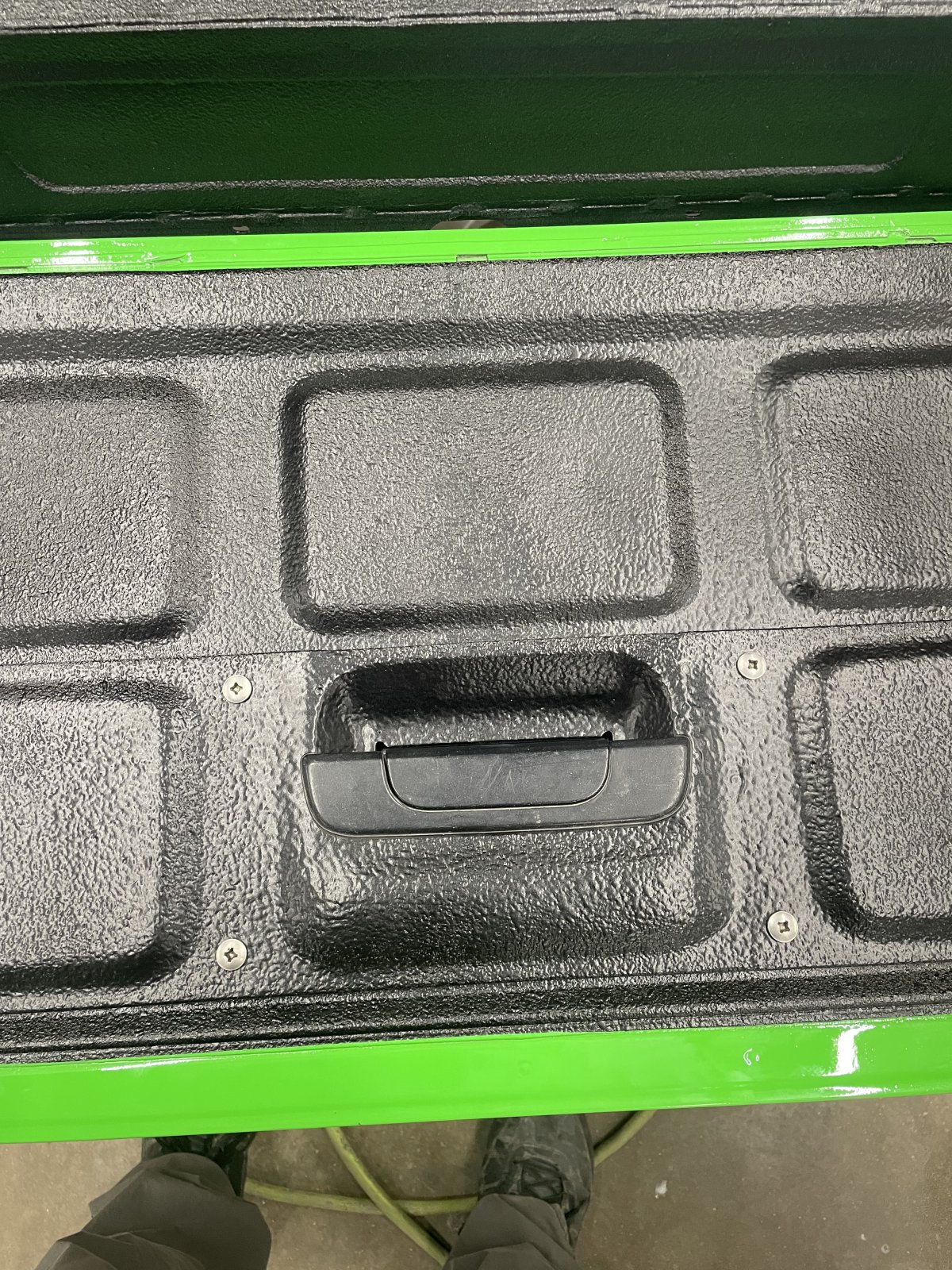

  2. It’s brand name for a 2 part bed liner.
    this is another brand of 2k bed liner I sprayed a couple weeks ago

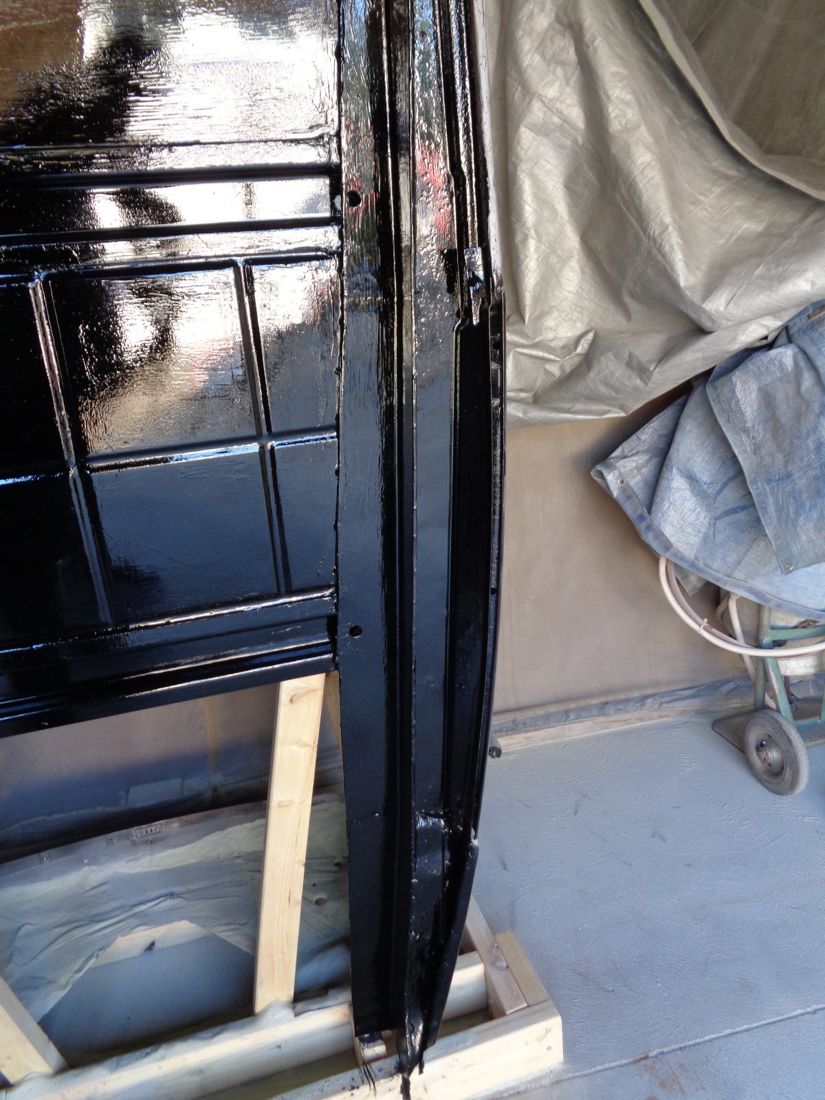

    I don't display my cars with mirrors under them or drive on salted roads, so the undersides get a coat of whatever I have on hand, applied with a brush. Brushing allows you to work the paint into the nooks and crannies well. I find that urethane seam sealers adhere better to these areas with a brushed surface. In recent years I have been using Zero Rust (Rust Bullet), Armor Coat , Impervo Alkyd marine enamel and my favorite Interlux Marine Enamel. The last two being on the pricey side but very tough and durable.
    I have some POR-15 that is at least 15 years old, seems to still do the job but not my favorite. I'm just using it up. Guess it just depends on your cars intended use, place of storage and budget on what to apply.
    In the pic, epoxy primer was brushed on blasted metal then brushed with Interlux Marine Enamel. Not shown, afterwards it was urethane seam sealed followed by a second coat of Interlux enamel. Not pretty but will definitely out last me and nobody ever sees it anyhow. DSC06233.JPG
