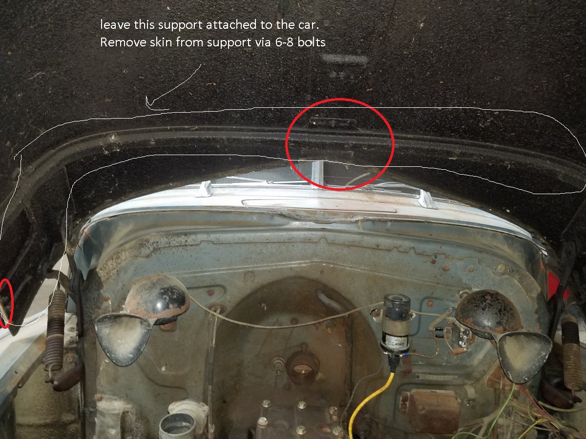

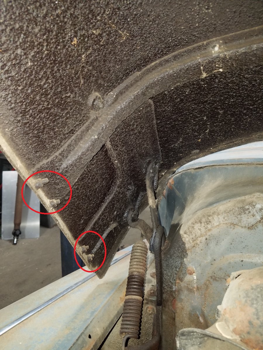

    I've got to take off this hood so i can pull my engine. I really don't want to mess it up.
    How would you go about unbolting it? It looks like i have 2 options.
    20181022_135005.jpg 20181107_110416.jpg 20181107_110422.jpg 20181107_110408.jpg
    -remove the hinges from the cowl sides and fight with the springs
    -unbolt the hood skin from the brace and leave the hinged alone.

    always leave the hinges attached to the cowl, unbolt the hood from the hinges.

    arrow.png Remove these bolts

    Here is what I am thinking now...

  13. henry29
    Joined: Sep 5, 2007
    Posts: 2,887
    henry29
    I'm not very familiar with Pontiac's but I've had several 40's GM cars and trucks and haven't run across rivets before.
    They should be shoulder bolts, can you clean them off and post a picture?

    If you prop the hood in the fully open position, can you just attach vise grip pliers to the end of the spring, then pull it forward enough to remove it? This works on 58-59 chevy trucks, I've done it many times.
    Removing the hood from the brace might or might not work, if you do try it, make sure that it will come off that way....might be something to trip you up. But some cars do come apart that way.

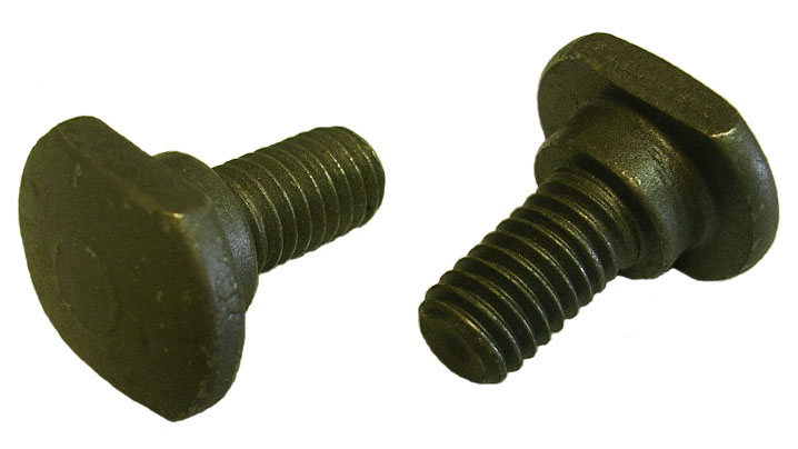

    Those 'rivets' are 'clutch head bolts'. Round heads with 2 flats. 5/8" or 11/16" wrench iirc. Clean 'em off with a little carb cleaner or lacquer thinner.

    I'm sure you guys were right about those not being riveted. The car has factory under coating, and the did the under side of the hood while they were at it. Probably why i couldn't see the flats on those bolts.

  29. Removing the skin from the hinged frame works pretty well, but you'll probably wreck the bolts. They're kind of a countersunk phillips I think..Maybe 5/16". Hard to find replacements
